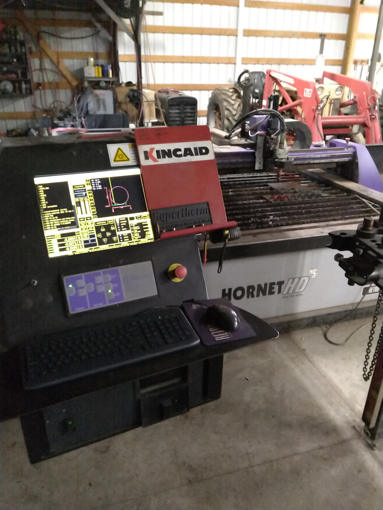

07 Dec 2025 19:31 #339829
by kn612
Replied by kn612 on topic Servo Driver Plasma Retrofit
Successfully retrofitted!
This is such an improvement. Qtplasmac has all the features that I liked about the Hypertherm Microedge controller and Phoenix software while being way less clunky and easier to navigate.
I'm using hypertherms vdc3 board for ohmic and divided voltage. Ohmic is still just as light and can detect alum foil.
Thank you guys so much for the help. I still need to finish configuring the homing setup for a dual motor gantry setup. I'll read through the docs some more before I ask questions.

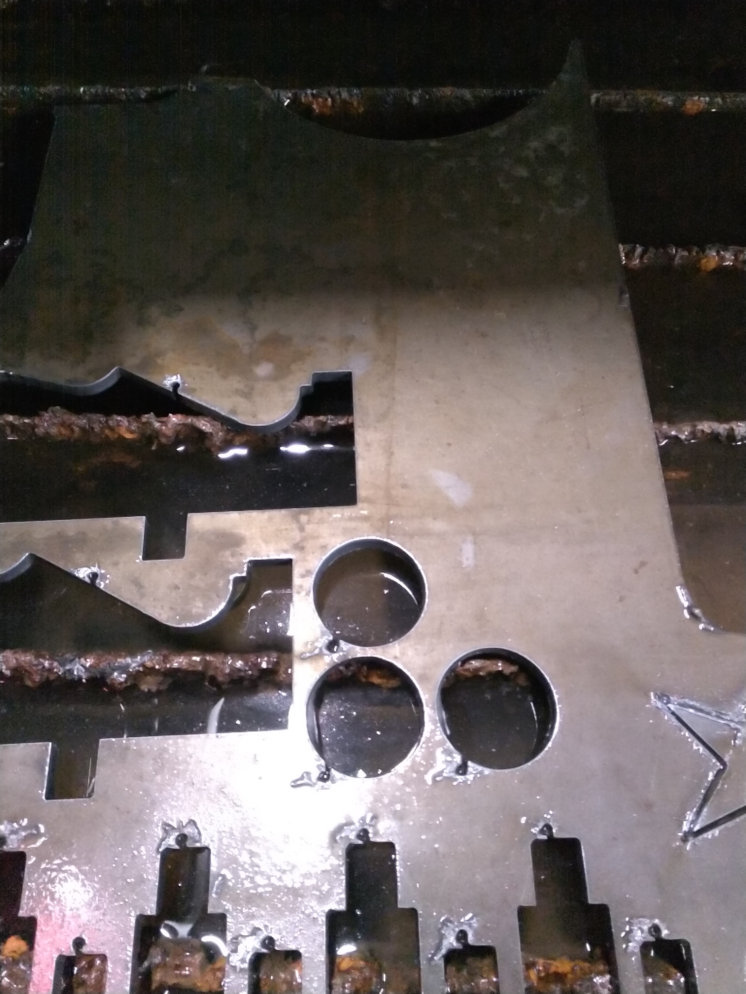

01 Oct 2026 20:43 #350052
by kn612

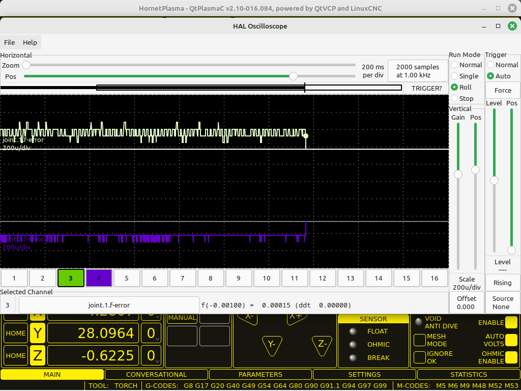

Hey guys, been cutting for a while. The table does great, however when needing to cut faster on thinner material the gantry shakes a bit while accelerating and it shows up in the cut. It gets better when I lower the acceleration all the way to 15in/s/s but is still there.
I noticed while at idle the f error for the dual gantry joints are equal but opposite values. Is that normal?
The gantry isn't skewed or in a bind. It is like that even with the motor/gearboxes disengaged from the gear rack.

01 Oct 2026 21:19 #350054
Replied by tommylight on topic Servo Driver Plasma Retrofit
15in/s2 is 380mm/s2, from pictures the gantry seems really heavy, so you might want to tr 10 or eve 7in/s2.
This does not limit the cutting speed, it just limits the speed on corners, so you might have to also adjust the VAD to 80 or 90%, depending on the amount of dross remaining in the corners.
- Posts: 18093
- Thank you received: 5325
01 Oct 2026 21:31 - 01 Oct 2026 21:49 #350056
Replied by PCW on topic Servo Driver Plasma Retrofit
This can likely be fixed in a couple of different ways:
1. Adjust the input zero on the analog servo drive till the static following
error is near zero.
2. Set the PID bias pin to a small value (say somewhere between -.020 to +.020),
again, till the static following error is near zero
(#1 or #2 have equivalent effects, minimizing any small offsets)
3. Add some integral (I) term to the PID loop
This will zero any static error.
Best option is probably to do 1 or 2 first to eliminate any offset errors
then do 3 (you cannot set 1 or 2 unless the I term is 0)
error is near zero.

08 Oct 2026 17:47 #350163
by kn612
Thanks guys, between setting accel to 10in/s2 and dialing in the bias this machine is really smooth now.
Upgraded to debian 13 and master branch. Thanks for fixing the inmux missing from hal and the cut recovery is working great again.
