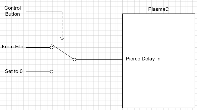

In the Sheetcam processor, there are some variables at the top of the file to select between Sheetcam and qtplasmac tools. Sorry about that but had to humor Les at Sheetcam seeing its distributed with his software (and he wrote the post.)!yes it works if you use 2 tools one with piercing delay and one with 0 delay.
I'm using the tool from sheetcam (tempoary tool created from file). so i need 2 files or edit the file after pierce and reload.
what I'm thinking is just press a button and make the Pircing delay 0,

05 May 2025 07:29 #327752
by snowgoer540
Replied by snowgoer540 on topic Zero Pierce delay After pierce Only
Last I checked this still worked, let me know if you encounter any issues:
linuxcnc.org/docs/devel/html/plasma/qtpl...#_material_converter

05 May 2025 19:11 #327806
Replied by rodw on topic Zero Pierce delay After pierce Only
If you set the cut parameters up correctly (eg replicating sheetcam toolsets in qtplasmac by importing the Sheetcam tools), the user still won't need to select anything. Instead, Sheetcam will pass the tool number to QTplasmac in the gcode and it will retrieve the corrrect settings. Keep sheetcam the master of toolsets and update QTplasmac if you change settings.I understend what you mean but I want to keep the temporary tools because they are in the GCODE file, the operator don't has to select.

06 May 2025 09:22 #327857
by grijalvap
Replied by grijalvap on topic Zero Pierce delay After pierce Only
I was not awere of this working mode, it can be useful because you can use sheetcam drawings or generate in QTplasmaC.
but still need change pierce delay in tool.
