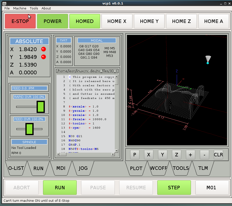

so ive been messing around having some fun with the qt designer following the tutrorial and have a question
how does the g5x offset work? i am able to write it with the button but the absolute value in the dro widget doesn't change when i type g54 in the manual entry
it does update when i g92 an offset in or return home from a jog.
also im using my"good" computer with debian stretch. can i use my interface on my weasy controlled machine?
thanks
thanks

I think i figured it out
the after looking at another vcp the string was different than the tutorial. so i used status labels and the rules for relative and absolute position. it works, but not like i suspected.
it seems the rel and abs are reversed. when i g90g0g54 to x0y0 the relative screen is at zero even though the rule says position:axis?rel.
I also added a clear signal for each set axis button, as if you didnt use 0 it would stack the values up and not clear the box with each set click

The status and position are being overhauled with a new Data Channels so for now use the status label and rules.

Yes the Documents has a pretty good list in Data Plugins > Status.
qtpyvcp.kcjengr.com/plugins/status.html
If a status has some text then you can use this syntax
If the return value is a bool then use str(ch[0]) to get true/false.
If the return value is a tuple then you can slice it to get the axis you want. Axis order is XYZABCUVW so to get the Z axis from a tuple you put str(ch[0][2]) in the expression. Remember that counting starts with 0 so for the 9 axes it's 0-8.

Is there anyway to chip the modal gcodes?
I tried to make it two lines and did in the editor but in the Sim it is a single line and very long

Simply check word wrap and set the maximum width for the status label.
