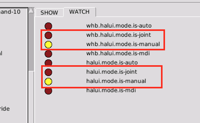

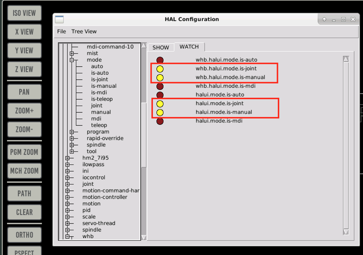

22 Dec 2019 13:59 - 22 Dec 2019 14:00 #153067
by Gnevko
Replied by Gnevko on topic Couple questions about QTPYVCP
Hi everyone
I am not sure if it's correct please for this question (sorry if not) but my be you can help me with the problem described hier: www.forum.linuxcnc.org/18-computer/38015-whb04b-4#153040
If I press an actionButton in the GUI with the following action: "machine.jog.axis:x,pos" than the machine change the mode from
to
and after that I can jog with MPG (WHB04B-4) as it should be. As soon I press one of macro buttons on MPG, the machine goes again in previous state (manual + joint) and I need to press an jog button again on GUI to become MPG work.
The question is, what happens exactly if I press the action button with "machine.jog.axis:x,pos"? Is these the possibility to avoid joint mode?
to
