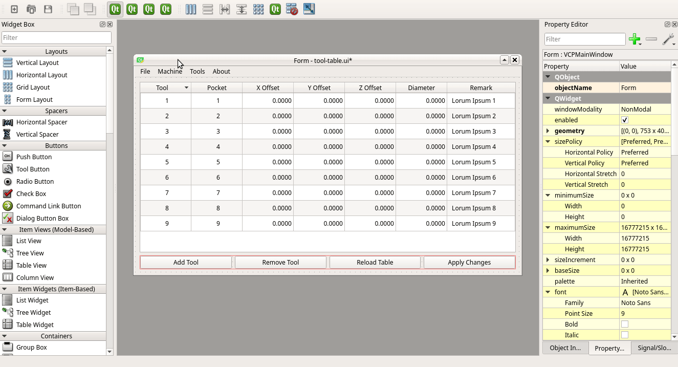

16 Feb 2019 14:48 #126622
by Leon82
Replied by Leon82 on topic Couple questions about QTPYVCP
how does one go about refreshing the tool table widget?

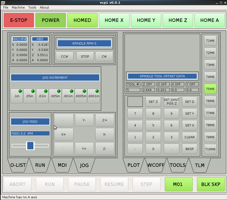

16 Feb 2019 16:57 #126626
by Leon82
- KCJ

16 Feb 2019 17:31 - 16 Feb 2019 17:37 #126628
by KCJ
Replied by KCJ on topic Couple questions about QTPYVCP
That looks great!
The tooltable widget has slots for re-reading, saving, adding/removing tools etc. You can connect the slots to buttons (or other widgets) in designer, or you can call them directly from python code.
Here is a gif showing how to open the signals and slots editor in designer and connecting a button to the tooltable widgets loadToolTable slot.
There is a tool-table.ui file in the examples folder. You can open it in designer by running editvcp in a terminal and then browsing to the qtpyvcp examples folder. You can run it by selecting Open File from the VCP Chooser dialog and browsing to the examples folder.

16 Feb 2019 17:37 - 16 Feb 2019 19:18 #126630
by Leon82
thanks!, ill check it out
IT worked good.
my icons are different than yours.
is there a way to shift the columns around?
That looks great!
IT worked good.
