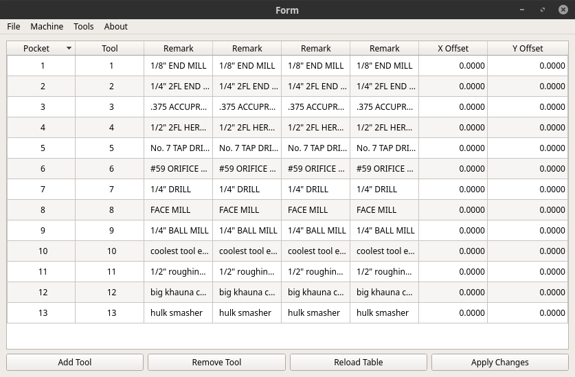

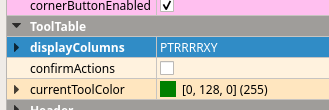

i noticed there was an update so i updated. should i delete and redo the tool table widget?
it accepts negative offsets now, but it doesn't seem to write to the tool table file. when i click to update (signal slot) it switches back to what was there.
ETA, i put a signal to save the table "activated "signal and if you hit enter twice it saves.
ETA, that wsnt good, i think it wiped out my tool table and the mdi buttons dont work

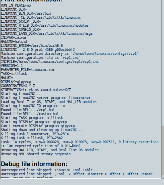

The "Can't execute DISPLAY program" error usually means that the program is not on your PATH. QtPyVCP is installed to $HOME/.local/bin, which due to a bug in Debian 9 is not on the PATH by default. To get around this QtPyVCP places a .xsessionrc file in the $HOME dir. Check if that file is present, and if not you can copy if from the qtpyvcp/scripts folder or create it and add the contents:
The file is hidden, so you will need to show hidden files in your file manager to see it (usually ctrl+h)
You will need to log out and log back in or restart for the changes to take effect.
Uninstalling and reinstalling QtPyVCP should also fix the problem:
KCJ
if [ -d $HOME/.local/bin ]; then
export PATH="$HOME/.local/bin:$PATH"
fiThe file is hidden, so you will need to show hidden files in your file manager to see it (usually ctrl+h)
pip uninstall qtpyvcp (run multiple times if needed)
pip install qtpyvcp (or however you prefer to install)KCJ
