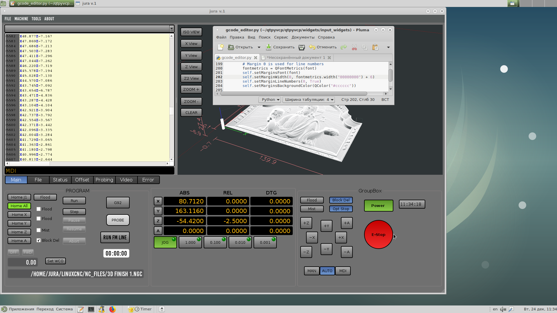

All this is very good. Please tell me how you can see the line number 9x xxx xxx, because only 9xxx is available.
Or what to register for the Status label to see the line number.

Line 265 in gcodeeditor.py
self.setMarginWidth(0, fontmetrics.width("00000000") + 6)
The quantity of zeros is the mask for how many line number digits.
I 9x xxx xxx requires 8 zeros like shown.
The bolded zero is the column number. Line number = column zero and so on. 0, 1, 2

Thanks for attention! I did everything, but 4 columns are displayed. On the left there are others but not visible. It is necessary to expand the middle column. What did I do wrong?

Many thanks to everyone after updating QtPyVCP GcodeEditor earned as it should !!!
