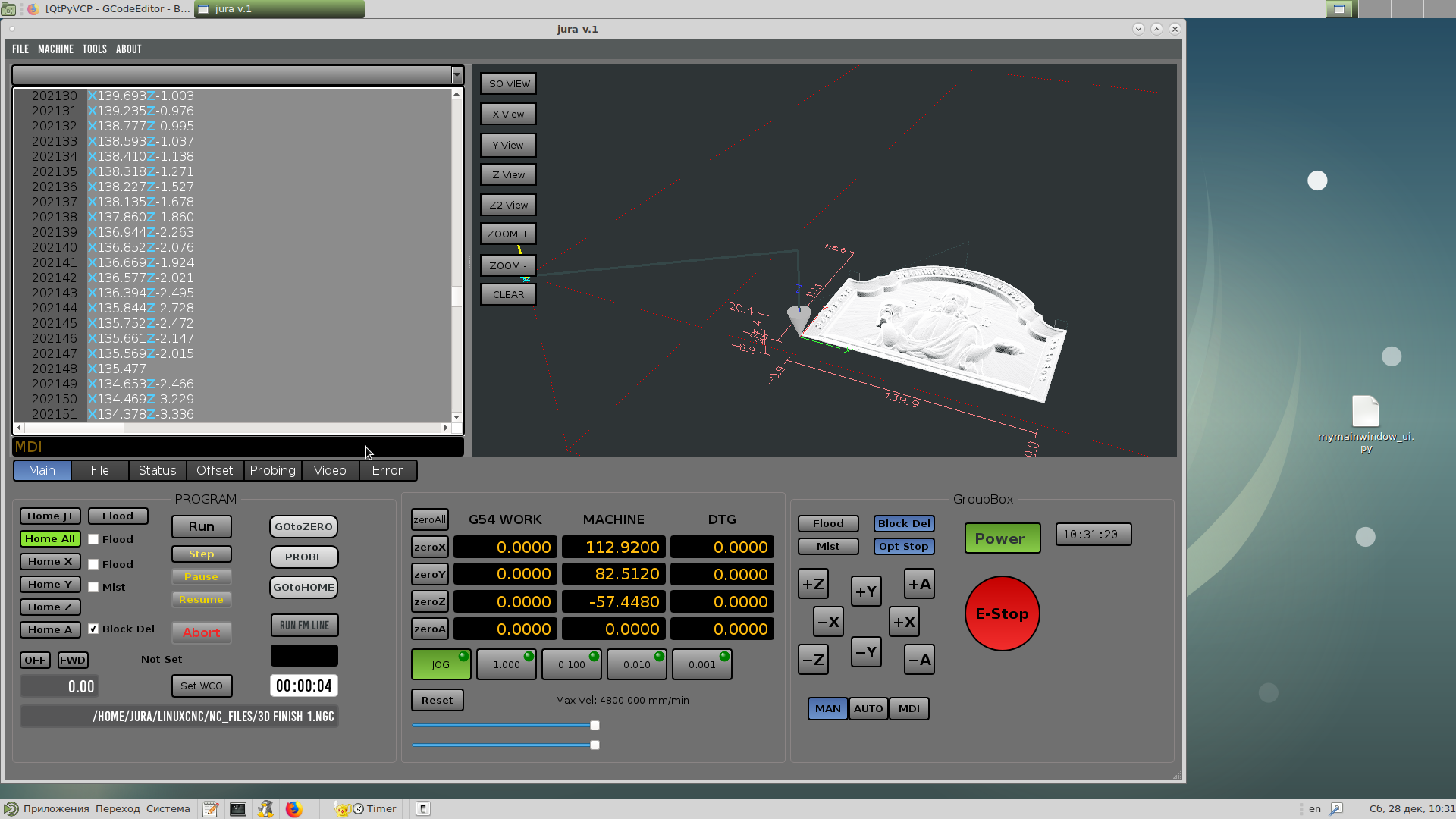

28 Dec 2019 08:41 - 28 Dec 2019 08:42 #153359
by hottabich
Replied by hottabich on topic QtPyVCP - GCodeEditor - Widget Styling - Please review and comment.
I use your GcodeEditor file and your run from line method, everything works thank you very much and Happy New Year !!!
