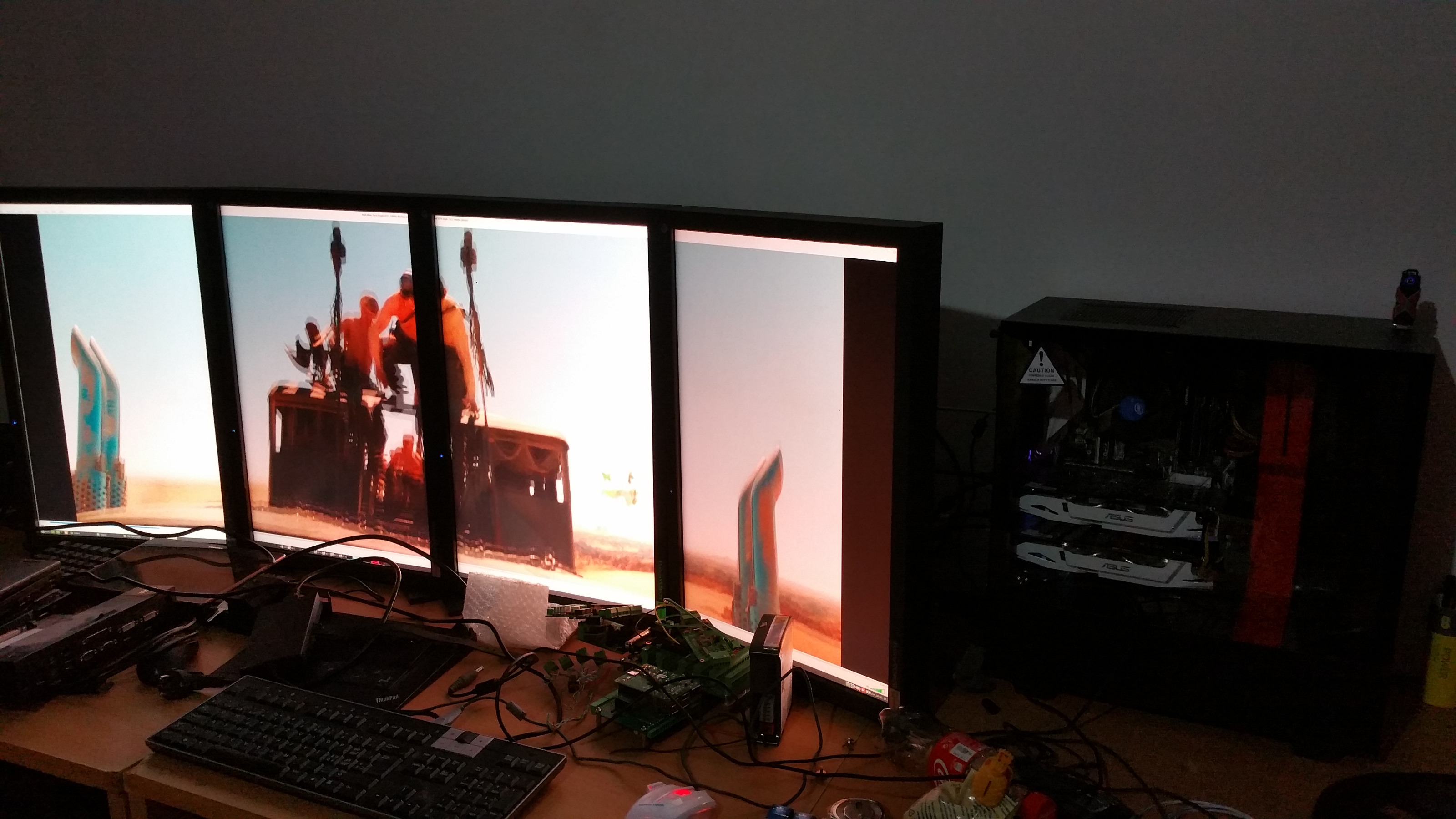

28 Apr 2020 20:45 #166009
Replied by tommylight on topic Installation error

@tommylight: nice setup.
I finally found the missing ngc files and copied them to the nc_file folder
and probing is fun!!
