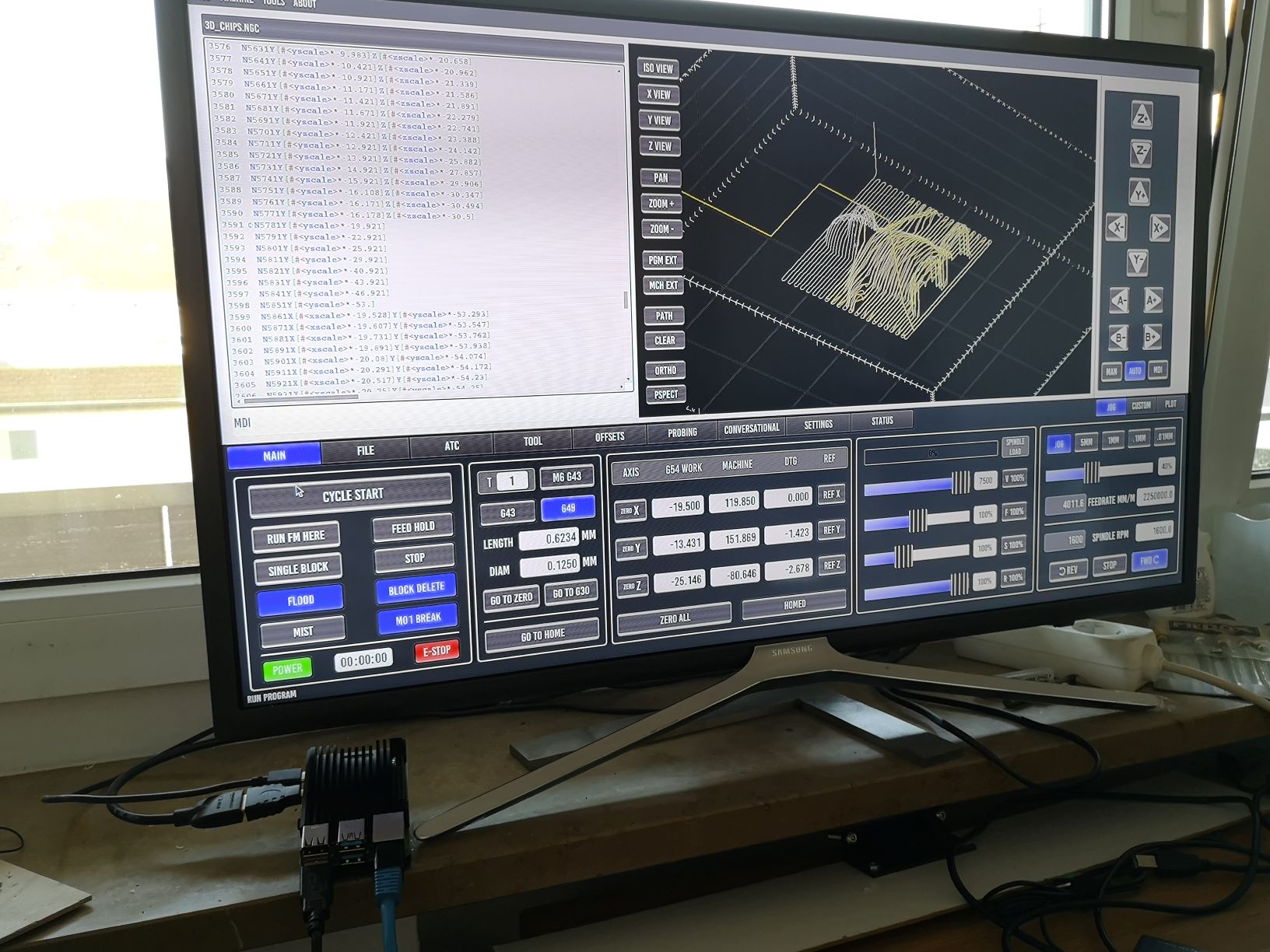

Alright i got to sucessfully install your deb package. The file was somewhat corrupted when i downloaded it with wget (was only 12 megs). Downloaded again wtih chromium and it installed successfully. Unfortunately i still get the "ImportError: No module named qt" Error. I guess i somewhere messed it up by manually compiling vtk. I will try again with a fresh install on a differend sd card and report back.

Partial Success!
Started from scratch with the Raspberry PI OS (Desktop)
Installed the RT Kernel following this guide:
gnipsel.com/linuxcnc/uspace/rpi4-rt.html
Installed Linux CNC following this guide:
gnipsel.com/linuxcnc/uspace/rpi4-emc.html
Used scottas Guide to install vtk and qtpyvcp (btw wget failed everytime i tried it with that deb file)
Now i can launch linuxcnc with the Brender Action and Mini sim examples. I can also start up the Probe Basic GUI. However the vtk backplot is completely black. As soon as i do anything to manipulate the backplot linux cnc crashes with the following error:
To me this sounds like the end of the road on the raspi 4 as it reads like and hardware or driver problem....

ERROR: In /home/pi/Development/VTK-8.2.0_old/Rendering/OpenGL2/vtkShaderProgram.cxx, line 447
vtkShaderProgram (0x29fc3e0): 0:1(10): error: GLSL 1.50 is not supported. Supported versions are: 1.10, 1.20, 1.00 ES, and 3.00 ESTo me this sounds like the end of the road on the raspi 4 as it reads like and hardware or driver problem....
EDIT: Googeling this error leads me to this:
discourse.vtk.org/t/error-glsl-1-50-is-not-supported/1444/2
So i guess i have to put "MESA_GL_VERSION_OVERRIDE=3.2" somewhere?

I also had this error and went around and around with compilation options with no success. The issue for me was using the Full OpenGL kernel driver rather than the Legacy driver.
If you have a line like dtoverlay=vc4-kms-v3d in your config.txt try removing it. As I don't have a Pi 4 I cannot test directly.
For some reason the legacy driver supports newer versions of GLSL, or VTK is defaulting to OpenGL ES when the Full OpenGL driver is not available. I compiles VTK to support OpenGL ES. Not 100% sure, all a bit too complicated.

That did it! However the performance of the backplot is kind of ....... meeeh. Feels less than 30 fps.
