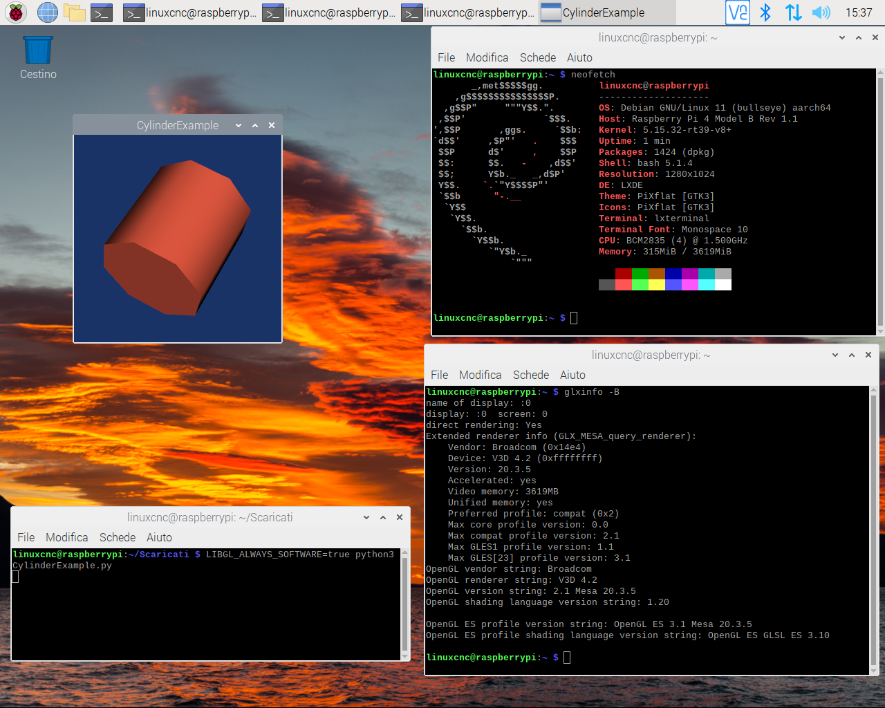

As reported here
github.com/pyvista/pyvista-support/issue...suecomment-848598723
I compiled (in about 9 hours ...) the latest version of the vtk
on a raspberry pi 4 with preempt_rt
Linux raspberrypi 5.15.32-rt39-v8 + # 1 SMP PREEMPT_RT Sat Apr 2 07:28:17 BST 2022 aarch64 GNU / Linux
I then installed the wheel file, downloadable at this link
drive.google.com/file/d/1H4EwSQ5fpor1YZi...fwy/view?usp=sharing
with the command
python3 -m pip install ./vtk-9.1.20220512.dev0-cp39-cp39-linux_aarch64.whl
However, the VTK works, as shown in the figure, only as environmental variable
LIBGL_ALWAYS_SOFTWARE = true
The screen also shows the results of the commands 'neofetch' and 'glxinfo -B'
Without the environmental variable, the error message is this:
vtkShaderProgram.cxx: 438 ERR | vtkShaderProgram (0x15e63020): 0: 1 (10): error: GLSL 1.50 is not supported. Supported versions are: 1.10, 1.20, 1.00 ES, and 3.00 ES
Using, as some suggest, the environmental variable
MESA_GL_VERSION_OVERRIDE = 3.2 MESA_GLSL_VERSION_OVERRIDE = 150
the example shown works for a few seconds but then goes into error
in any case it is then possible to install QtVCP, QTpyVCP and Probe_basic
Anyone know how to use the V3D 4.2 driver with VTK?

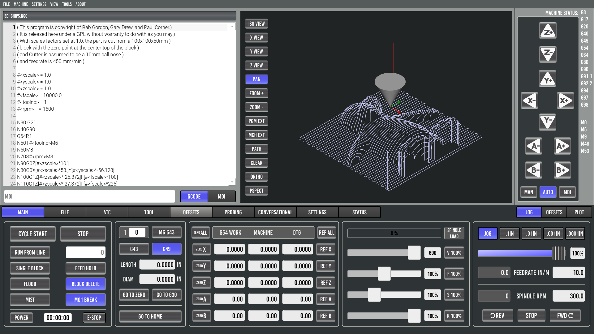

Can maybe someone give a detailed update to this topic? I come from here: forum.linuxcnc.org/qtpyvcp/50732-probe-b...nc-2-9-1-on-raspi-4b. And with the help of this thread i was able to compile the last version of vtk on my raspi 4b 8gb and probe basic starts, but the backplot ist dead an the program often crashes. I was able to do this based on the last two replies in this thread.
I tried a few different args for cmake, but most of them didn't succeed and the one posted here have also several warnings, but can be linked to something installable. I use the www.linuxcnc.org/iso/linuxcnc-2.9.1-bookworm-rpi4.img.xz image and at first compiled and isntalled vtk. After that i installed the developtment installations of qtpyvcp and probe basic (kcjengr.github.io/probe_basic/dev_install.html).
Since three weeks now my dearly beloved cnc machine waits to come back to live and christmas is just around the corner.

I compiled VTK but my backplot was dead too.
After some hours of fiddling, I gave up PI4 and bought Intel N100 based NUC.
Without Windows11, it's barely more expensive than PI4 8G but whole world faster than PI4. Once it's delivered, my machine was up in a couple of hours instead of reading and fixing problems here and there.
I highly recommend to stay away from RPI for LCNC. With the price and form factor point, I don't see any benefit of RPI over N100 NUC.
