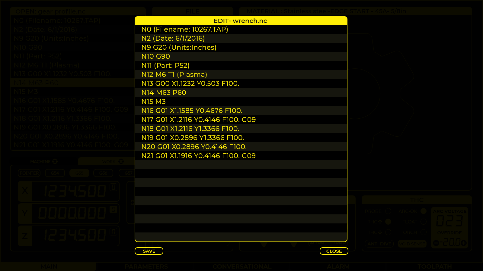

as I asked earlier.
Default and only option to open gcode files should be USB, and no-one said anything.
Should I assume it is Ok.
This in view that user should get smooth experience. Like OEM solutions.
Network location can also be an option.

Not ideal but i can live with that.as I asked earlier.

Pleas do not restrict what file locations can be opened. Linuxcnc has a default file location which needs to be supported but we might want to substitute a network location or a USB drive. Ideally, save the last location opened and use that until you navigate to another location..

Since we can't jog when a program is running could you change the buttons in the jog window to something else after starting a program? Pause button, thc enable/disable, arc ok enable/disable, thc voltage set point, etc? (Honestly I don't even know if those thc settings are changeable live during a program in plasmac, or if it's even usefull... just an idea since we can't use the jog functions and it's a good chunk of screen real estate)
(Edit)
Oh, how about switching all the yellow to red when estop is active? Speaking of which the gui needs an estop button doesn't it? Maybe keep that particular button red at all times for quick identification? .... I'm spit balling here and love what im seeing so far
(Edit)
