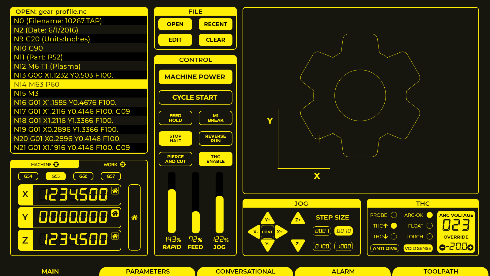

21 Sep 2020 20:28 #183180
Replied by tommylight on topic Gui for plasmac
Looks neat.
Thank you.
Thank you.

21 Sep 2020 20:41 #183181
by KCJ
Replied by KCJ on topic Gui for plasmac
That looks fantastic!
I don't think it would take more than a few hours to get the bulk of this done in QtPyVCP or QtVCP.
Did you do the mock-up in inkscape? If so can you share the source SVG?
Cheers,
Kurt
Cheers,
Kurt

21 Sep 2020 21:16 - 21 Sep 2020 21:21 #183185
by pinder
I used Adobe XD.
Surely I can share svg.
It is attached.
If anyone want to give suggestions, I am open for suggestions and criticism if any.
svg itself was not attaching so i zipped it

21 Sep 2020 21:34 #183188
Replied by rodw on topic qtpyvcp Gui for plasmac
Really nice. Couple of things.
1. I think it needs a torch enable button. I use that a lot.
2. Consider separating cycle start from machine power to avoid unintentional triggers.
I really like the touch friendly flat interface, no annoying tabs like Gmoccappy has.

21 Sep 2020 22:14 #183194
by pinder
Replied by pinder on topic Gui for plasmac
Thanks @rodw
1) I liked your idea, so I changed that.
2) For the moment we will have to sacrifice reverse-run. How much reverse-run is important?

21 Sep 2020 22:22 #183195
by pinder
I have modified it as per suggestions. Made a little animation., hope you all like it.
checkout the video
checkout the video

21 Sep 2020 23:29 #183200
by phillc54
Replied by phillc54 on topic Gui for plasmac
Reverse Run is only useable while paused so you could swap out the jog panel with a reverse run panel when a job is paused or you could make it a cut recovery panel with these functions:Thanks @rodw
The following user(s) said Thank You: pinder

22 Sep 2020 00:10 #183202
Video looks great!
Phil's idea of swapping out the jog panel sounds like a great idea.
The other thing that needs to be displayed is the Plasmac material that is selected.
Somewhere we need to be able to see all the cut parameters for the selected material but maybe they don't have to be on the main screen.
Maybe you could shorten the preview and place the material name, cut height, pierce height, pierce delay and cut speed either above or below the preview on one or two lines. Clicking that line might open a selection window or tab and show the rest of the settings.

22 Sep 2020 00:12 #183203
by AgentWD40
Replied by AgentWD40 on topic qtpyvcp Gui for plasmac
Is there a way to make the color scheme easily customizable?
