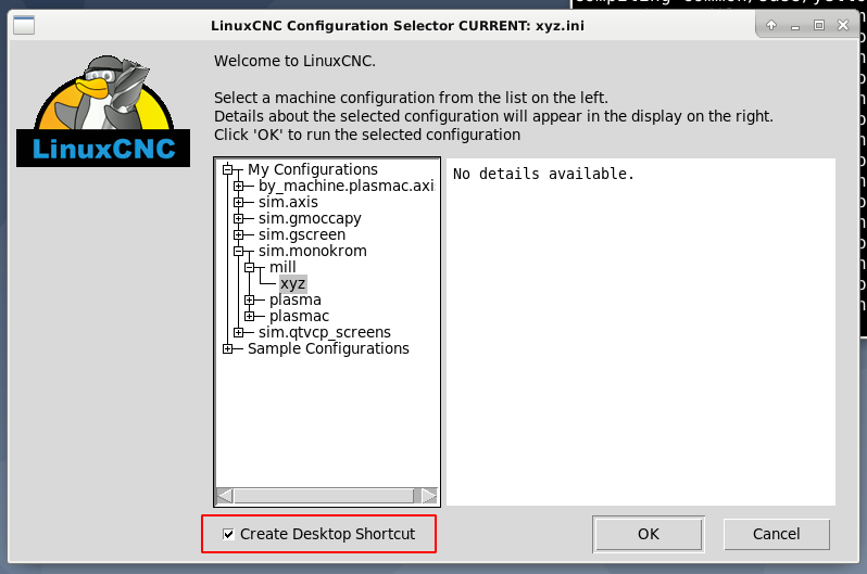

- KCJ
- Posts: 328
- Thank you received: 267
15 Nov 2020 14:59 #189477
by KCJ
Replied by KCJ on topic My setup Process confusion
Item 5
Once you have your INI set up and working, you can lunch LinuxCNC (either from the menu from from a terminal), select your INI file, and check the box to crate a desktop launcher.
You can also create a launcher manually and enter the correct paths. I usually start with existing launcher and edit it as needed
