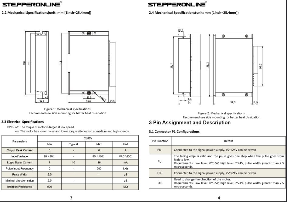

Attached is the driver spec.
This says the max frequency is 200KHz with a pulse width of 2.5microseconds.
So i think you are saying I need to bump up my .maxvel.
- Posts: 18103
- Thank you received: 5326
04 Dec 2020 14:23 #191030
Replied by PCW on topic My setup Process confusion
No, you would have to reduce your maxvel
