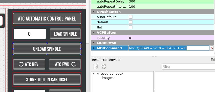

In the QTDesigner, change the UNLOAD SPINDLE BUTTON MDI command line to the following:
M61 Q0 G49 #5210 = 0 #5231 = 0
And the same for the UNLOAD SPINDLE BUTTON MDI command on the tooling page
see picture below for example:

i find macros far more powerful than ladder or the component due to their very high degree of flexibility and easy programming, but that is just my own opinion and experience, others may find a complete python atc better suited or a classic ladder driven atc better or the comp better suited. for me its RS274ngc all the way..lol just what i like. beyond that i'm not much help when boring down into the other methods.
not all parameters will be used but these were the original generic atc macros and can be configured for your own machine as required. in my instance i use the random type which doesn't utilize the selected pocket, however i am configuring a lathe and it will use selected pocket. so this is in there as a starting point to be reconfigured to your individual requirement.
the macros you mentioned above were put in by me as excepts of the main Mxx.ngc macros to perform segments of the atc routine, they are useful if you have a sensor fail for "unsticking" the machine such as if the spindle is down on a tool and the carousel is out at the spindle and you need to untangle everything without running a bunch of individual m6x px code to accomplish that. they take into account safeties such as moving the spindle out of the way to extend if you need to access the carousel with the door open to manually remove tools or add tools etc.
the macros could technically be shaved down for your own application, but since these are examples to be used for both mill, lathe, whatever we did not remove all of the pre-existing lines in them in the event they would be needed for a user configuring their machine.
these were configured to accommodate the vismach simulator so that users could preview the atc functionality without having a machine connected using the atc sims.
in random mode, it does not always return the currently called tool to its previous pocket, it will sometimes move it to another empty pocket, it seems to do this to keep the tools as close to filling consecutive pockets as possible via the math.
yes non random is more for lathe type turrets or rotary head milling machines such as speedios or brothers which eject the tool in the head up move before rotting to the next called tools pocket location.
and as you mentioned arm types have their own requirements depending on single or double.
the parameters you listed above are system parameters predefined in linuxcnc and used in python and remapped m6 calls:
linuxcnc.org/docs/devel/html/gcode/overv...ub:system-parameters
in probe basic I defined what you might consider "pre-subroutines" that add desired functionality to the m6 calls for things such as offset safeties, coolant cannon aiming, probe safety etc.. but ultimately they are just triggering a normal old T#M6 which then is run through remap.
line edits are the entry boxes in probe basic, if you select a box while in designer it will have a name in the properties window to the right, those names can be used to pull the data into a subroutine. so for instance on the atc page when you enter a tool number in the box for the M6 call, it pulls that lineedit box's data into the "pre-subrotuine" m6_tool_call_atc_page.ngc. this sub adds some things used elsewhere in probe basic and pulls in other lineedit box data and runs some calcs etc, and issues a normal T#M6 which initiates the m6 remap and toolchange.ngc subroutine.

That's remarkably helpful.
First thought after reading your response is that I do indeed have an issue with stdglue not passing the parameters to remapped M6. I'll poke around in the file paths as this is 99.9% an issue caused by my ignorance.
Second thought is that I should NOT start with the ATC sim config but with the 'standard' Probe Basic config and then add in the files/features/INI statements needed to get it working. There's enough non-relevant stuff in the ATC sim config that it may (does) cause some confusion - especially all the required stuff for vismach.
It took me quite some time to (mostly) unravel how you all are animating/using the ATC widget, but now that I can manually trigger the widget through MDI I should be able to eventually get a tool change scheme worked out that's compatible with carousel.comp and moves the widget so the GUI matches reality.
I'm quite sure I'll be back with more questions, but for now - as you say - there's a lot to digest.
-Ralph
-Ralph
