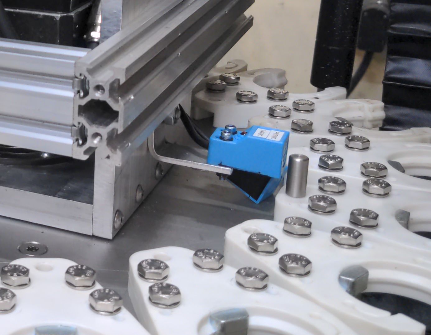

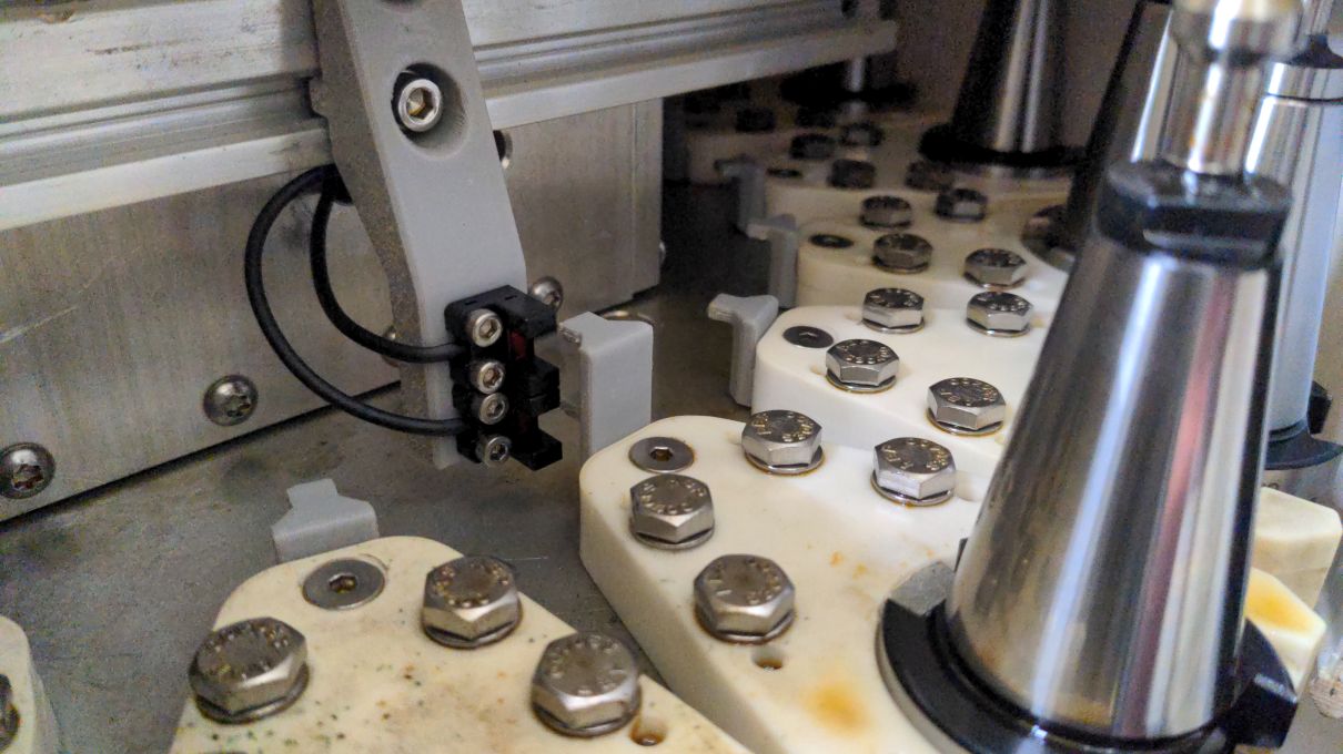

14 Dec 2024 20:30 #316686
by spumco
When I first built my ATC, I used stainless pins with proximity sensors for both home and pocket flags. After struggling with pocket alignment, I finally realized that round pins weren't really suitable as flags. At least not with the geometry I used, where the pin was vertical (up from the platter) and the proxy was pointed at the pin circumference.
When the round pin went past the proxy, the slight variation in sensing distance (due to pin radius) was magnified further out at the pockets. Result was inconsistent pocket alignment. And slight changes in rotational speed made a huge difference in pocket alignment consistency.
I wound up ditching the pins and proxys and installed some optical fork sensors with 3D printed flags. Despite the circular motion, since the flags have straight edges they trigger the sensors MUCH more consistently - and at any speed.

yeah that is not a good orientation method trying to pickup the curved body. you would probe the top flat of the pin to give it a more square edge to have a strongly defined edge to trigger. or better use a wedge/pie shaped block that gave the proximity sensor a flat square edge to sense. this is how i have those setup on my machine as home and limit switches and they are actually quite repeatable in the sub 0.001" as seen in the video:
