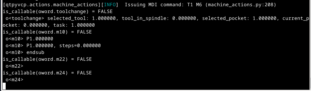

In the following logs the spindle had no tool loaded and the ATC had T1 stored in Pocket 1.
Using the "T1 M6" Command resulted in this log:

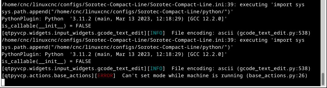

At this point, nothing happens and all I can do is stop the cycle resulting in this error:
This would suggest to me that there is a problem in m24 and that there are generally problems with the subroutines not being callable.

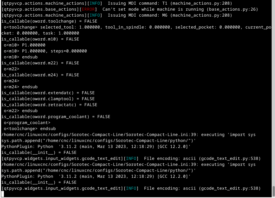

But if I use the command "T1"
and stop that cycle again manually:
And then using the "M6" command, the full tool change procedure gets executed without any problems with the following log resulting in a successful tool change.

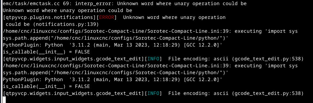

That should mean, that the subroutines can be called and work correctly. So I don't understand why the same toolchange call doesn't work if I use "T1 M6". It should do the exact same thing.
I also had this error at some point but I don't know how related it is:

always test against the atc_sim if it is working then you know the issue is found in your configuration or subroutine modifications. no probe basic macro calls for T0 anywhere if the spindle is to be emptied M61 Q0 is used to do so. i would start by going through and comparing your altered subroutines to the simulation subroutines and find where the issue is breaking.
unknown word errors are triggered when incorrectly formatted syntax is used, ie a o where a 0 should be or vice versa. make sure you do not have any typos in your subroutines.
you cut off the error data that would show you or give a clue where the error originated from in the subroutine. i recommend investigating if you can repeat the error in debug.
