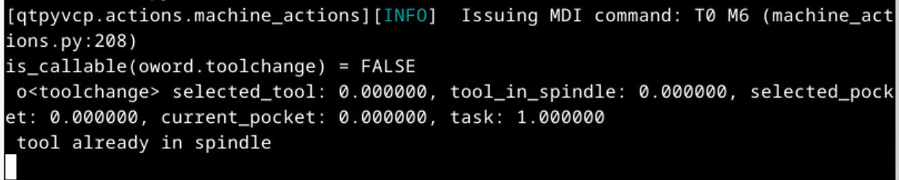

What I meant with the "T0 M6" is that the "store_tool_in_carousel.ngc" subroutine calls a "T0 M6".
I tried to test out if my subroutine modifications caused a problem, so I replaced everything with the stock subroutines that work in the sim and tried the simplest case:
T0 is in the spindle and I call a "T0 M6".
All I changed was a PRINT statement to see if the program executes the right "if" statement.
I would expect that upon calling "T0 M6" the toolchange.ngc file checks if the selected tool is already in the spindle and, if so, exits the subroutine.
But the execution starts and then never ends. The subroutine never Exits. Looking at the log, the Variables are correct and the if statement successfully checked that the tool is already in the spindle but the endsub doesn't get executed for some reason.
It just gets stuck here and I don't understand why.
I am sure you are right and it's some kind of problem with my config but I can't figure out what. I even made a new machine config with minimal features but I still get the same problem.
You mentioned that my error Date is cut off. What exactly do you mean and how do I get more debug data?

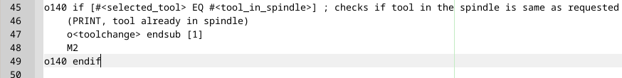

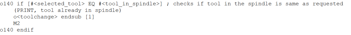

ok i see what you are referring too, its not stuck, there is simply not a print command which would trigger a debug message. for example you added one and if you look at the ends of the subs you will see there is a print command for debugging, but in o140 if statement there is not a print comand to show the iffstatement was true and the endsub command given, but this does not mean its stuck, simply that its not printing because a print command is not there. if you want to add a print command simply copy from the end of the sub and place ebtween the endsub line and if statement like so:Thanks for the answer!
o140 if [#<selected_tool> EQ #<tool_in_spindle>] ; checks if tool in the spindle is same as requested
(PRINT, o<toolchange> endsub)
o<toolchange> endsub [1]
M2
o140 endif

Ah, I see. That makes sense, thanks for the explanation.
Maybe I wasn't clear when saying it was "stuck". My problem is, that the "cycle" or the execution of the subroutine never ends.
In the last example the toolchange subroutine enters the if statement o140 and then should end the "cycle" with M2. But that doesn't happen. The cycle keeps running doing nothing until I manually stop it with the "Stop" button.

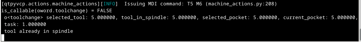

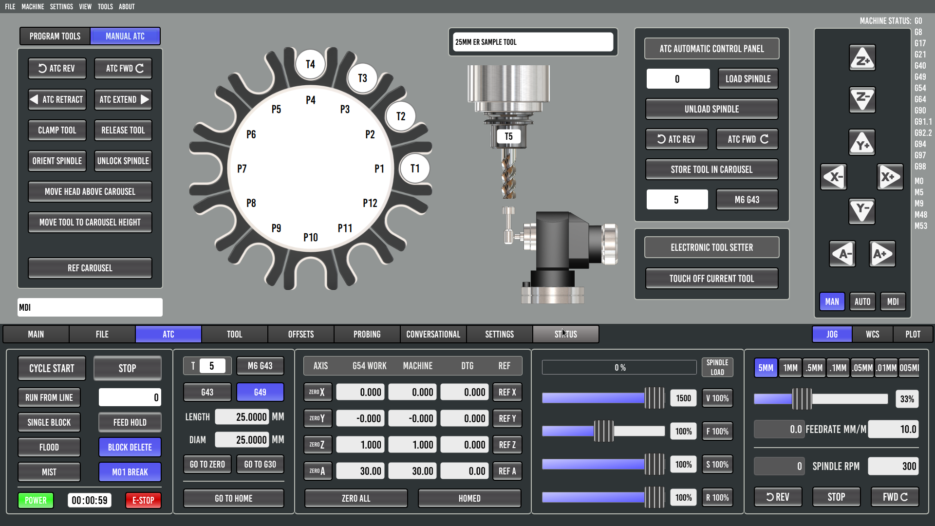

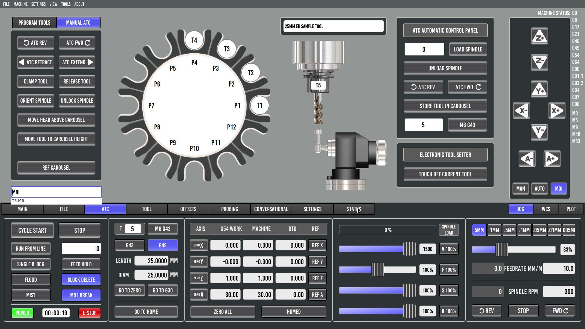

Calling a toolchange puts the machine into MIDI mode in which it stays until I manually press the Stop button.
I don't think that specifically tool 0 is the problem here. To illustrate I made this test:
This screenshot is the machine in idle with both tools and empty pockets in the ATC. The spindle is loaded with tool 5.
The subroutines are all default with the only modification being this print statement in the toolchange subroutine.
I now call "T5 M6" and I expect, that the toolchange subroutine checks if the requested tool is the same as in the spindle and then exits the subroutine and my machine goes back to idle.
The log shows that this is the case:
But my machine doesn't go back to idle. It keeps running and the program timer keeps counting the elapsed time until I manually stop the machine.
And I get basically the same problem if I use the "store tool in carousel" button or any other kind of toolchange. The machine never returns to the idle state.

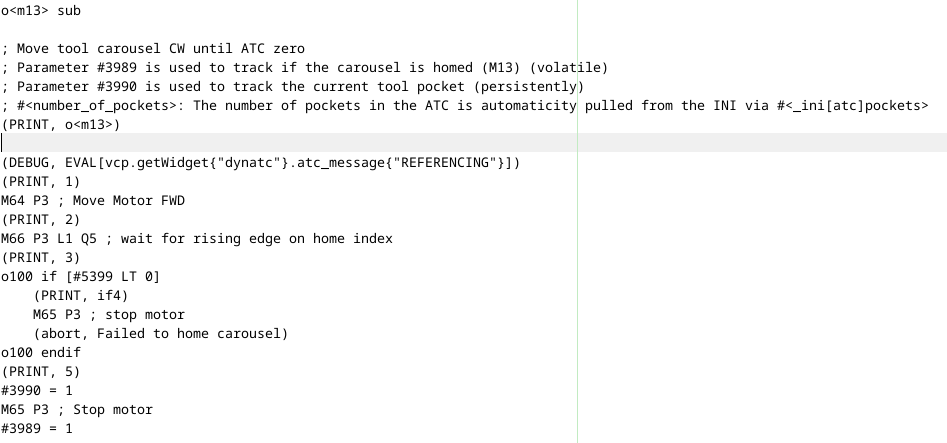

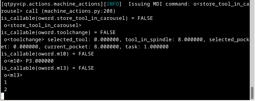

Here is another example. Trying to store Tool 8 in the carousel. Again, the only modification to the subroutines are print statements in M13.
When I now use the "store tool in carousel" button it results in this log:
It waits on the input of the Index and then nothing happens. The program should either continue if the rising edge is detected or abort if it isn't but neither of those things happen. It just stays in this "waiting" state forever. Or until I use the "Stop" button. I don't understand how the execution can get held up in the middle of the .ngc file.
Also the M64 P3 to start the motor doesn't seem to work either when M13 is called. The Output is never activated. But when I just Type "M64 P3" manually in the MDI console it works perfectly fine.
The execution of the .ngc file called by the toolchange always just stops.
