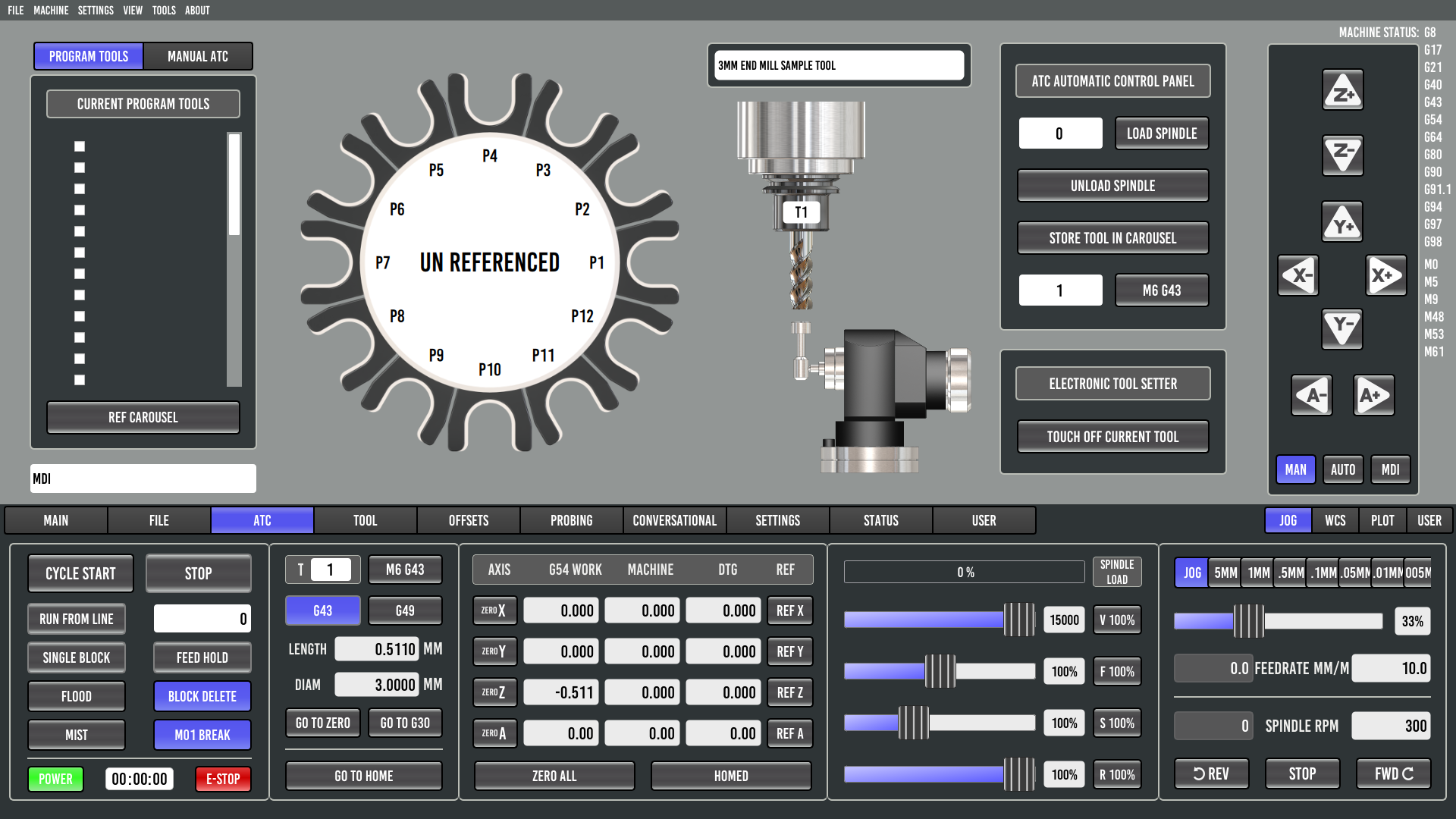

Hi again,sorry for my long absence, I moved and had to disassemble my machine for transport. I am reassembling it now and setting up linuxcnc again. I freshly installed LinuxCNC 2.9.3 Debian 12 Bookworm PREEMPT-RT and followed the steps for the Probe Basic APT Stable Install. I made a new machine config using Pncconf and the Axis GUI and only modified what I needed to get my machine running. When everything worked, I followed the steps to convert the config to ProbeBasic and that worked as well. All basic functionality seems to work in ProbeBasic, expect the tool changes. It is similar to the problem I had before.
All ProbeBasic files (Python and subroutines) are unodified. I only changed my .hal .ini and the probe_basic_postgui.hal file.
The machine is homed and Idle. Tool 1 is loaded in the spindle.

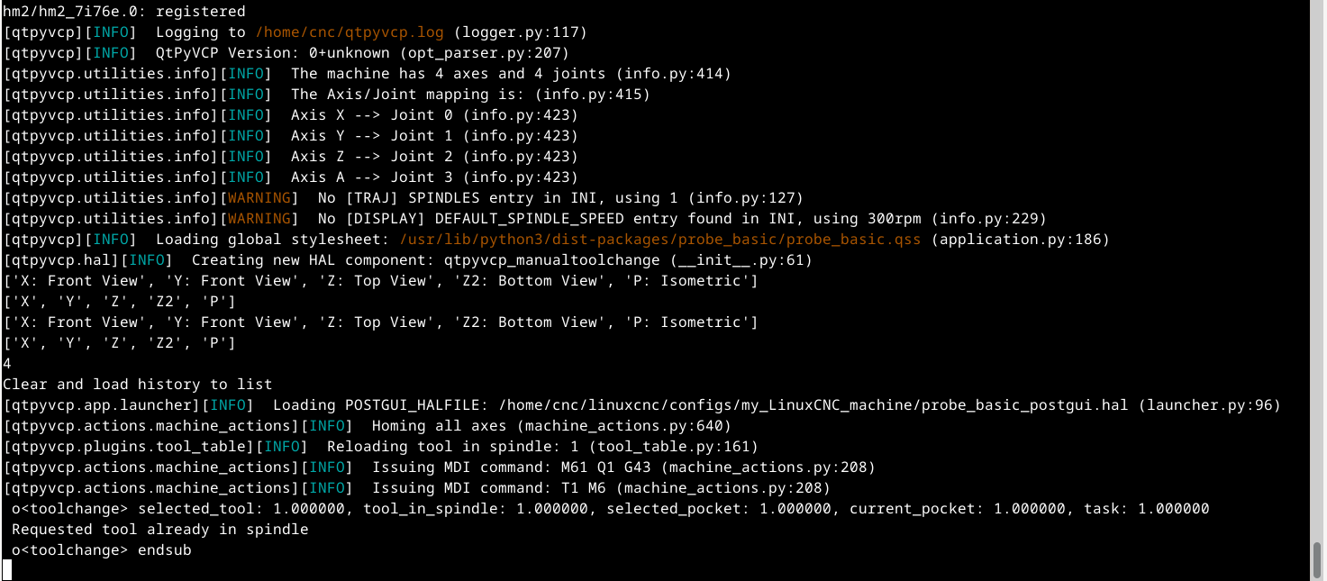

I type "T1 M6" in the MDI window.
The log shows that the toolchange.ngc subroutine correctly notices that the requested tool is already in the spindle and exits.

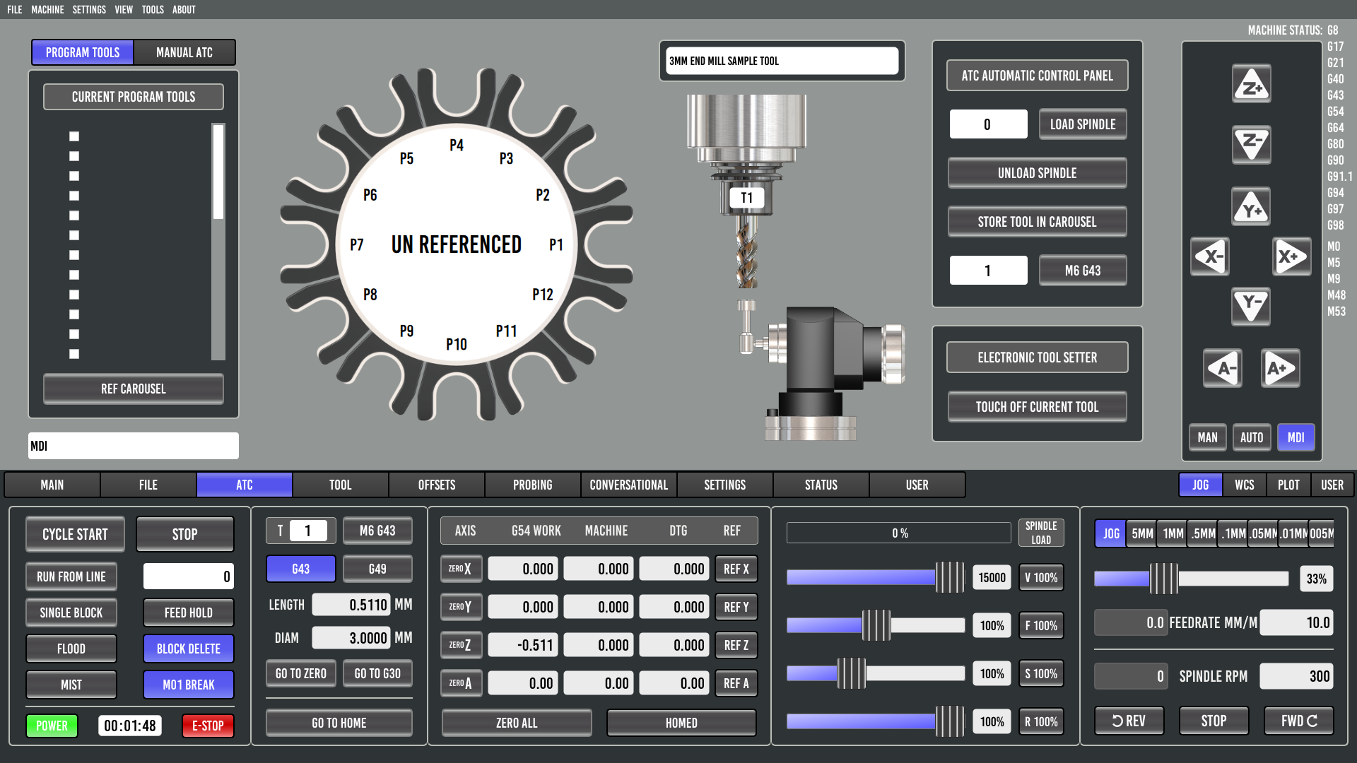

But the machines doesn't stop the cycle and goes back to idle. The Cycle keeps running until I press the "Stop" button even though there is "M2" command right after the "<toolchange> endsub" line in the toolchange.ngc.
I don't understand why this happens since calling other ngc files like "clamptool" work fine and they set the machine back to idle after execution with the M2 command.
I attached my .hal and .ini files.

I have worked through all the documentation, compared my files with the sim and changed all relevant subroutines (toolchange and m10 to m26) to fit my setup.
I know that my subroutines work, because (assuming T1 is in the ATC and T0 in the spindle) if I first type in a "T1" in the MDI Dialog, then press "Stop" because nothing happens and then type "M6" in the MDI dialog, then the full toolchange gets completed just like it should. The machine and ATC move correcty, all the subroutines that are called by toolchange.ngc do what I want and at the end the machines get set back into it's idle state. And this works with any tool combination. All good.
The buttons for moving the ATC CW and CCW, Clamping, unclamping and so on work perfectly fine as well.
But if I type "M6 T1" or "T1 M6" in the MDI dialog nothing happens, the machine doesn't move, and the cycle never ends despite the log showing that the toolchange sub and all the other subs connected to it got called and ended. Like I described in the last post, even changing to the tool that already is in the spindle doesn't work.
The "store tool in carusel" button doesn't work either since it is basically doing the same thing.
I have no idea where this might be coming from. Can you maybe send me a .hal and .ini file of a working real world config to compare to?
