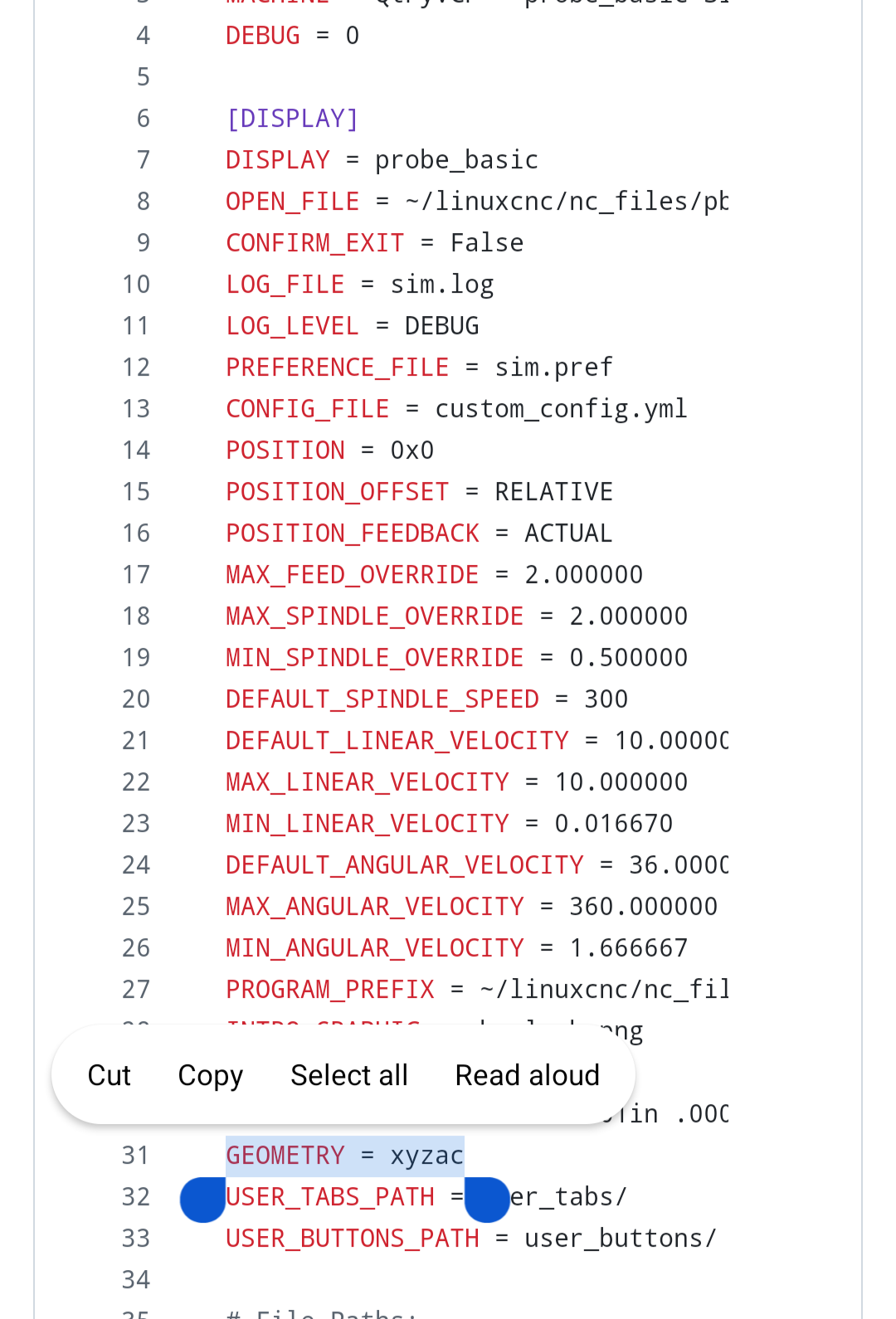

To display the axis configuration add a entry in the ini under display section. There are currently the following preconfigured screen adaptations:
xyz
xyza
xyzab
xyzac
GEOMETRY = (enter one of the above here)
For example the probe basic sim has the following:
GEOMETRY = xyzac
If you configuration isnt on that list you would need to do dev install and edit/add a a tab with the appropriate display for your machine.
xyz
xyza
xyzab
xyzac
GEOMETRY = xyzac

I have a XYZB Machine...
- Lcvette
- Posts: 1682
- Thank you received: 784
11 Dec 2024 14:58 #316471
by Lcvette
Replied by Lcvette on topic Probe_Basic Bugs?
yes there is not currently a preconfigured display option setup for xyzb.
however, you could run:
sudo editvcp probe_basic in terminal and make any edits on the apt installed version. if you are on the stable branch the changes will remain, if you are on the develop branch any changes will be overwritten when updates are pushed and you you subsequently run apt update.

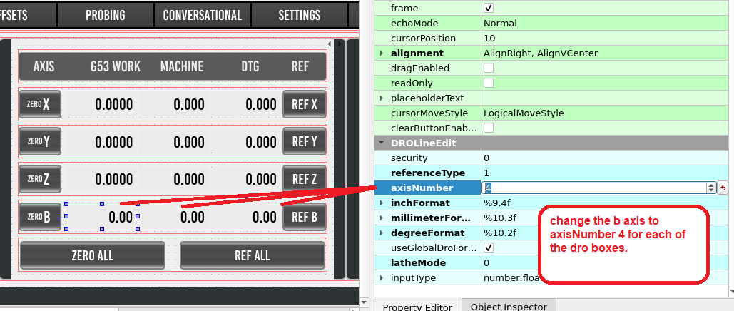

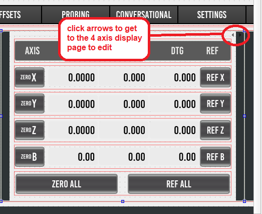

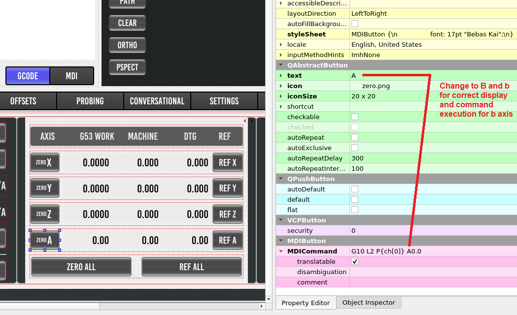

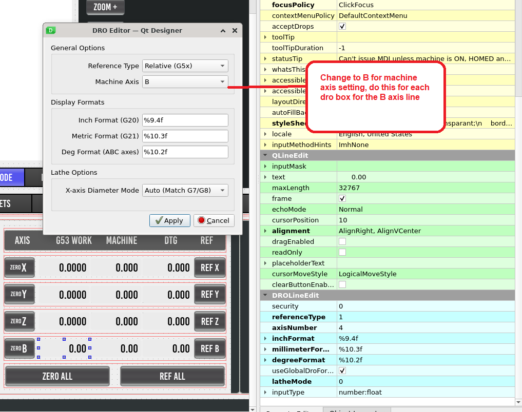

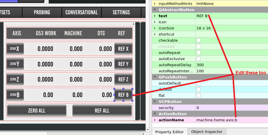

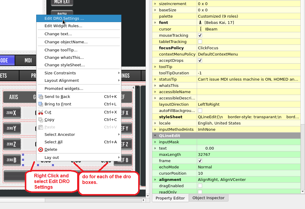

11 Dec 2024 15:15 - 11 Dec 2024 15:44 #316472
by Lcvette
for the issue with second y and z axis being mixed up, this is because the ini axis numbering is off when it adds in the second y axis as axis 2, to fix this, also change the axis number in the properties editor. in your situation it should be set as follows to account for your second Y axis motor:
axisNumber 0 = X
axisNumber 1 = Y
axisNumber 2 = Y2
axisNumber 3 = Z
axisNumber 4 = B
like this below in the images:
axisNumber 0 = X
axisNumber 1 = Y
axisNumber 2 = Y2
axisNumber 3 = Z
axisNumber 4 = B
