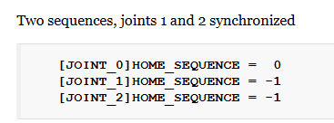

i think probe basic ref y do only ref my y1 axis and not my y2...
i have 2 homing sensors for y

Do you have
home_sequence = -2
for both Y joints set in the ini file?
Or -1 or -3....
home_sequence = -2
Or -1 or -3....

I currently have Joint 0 on the X axis Joint 1 and Joint 2 in the Y axis joint 3 on the Z Axis Joint 4 on the B axis in the ini
Joint 1 as Homing 1 and Joint 2 as Homing -1

17 Dec 2024 21:39 #316890
by Lcvette
Replied by Lcvette on topic Probe_Basic Bugs?
- CNC_ANDI
- Posts: 233
- Thank you received: 31
18 Dec 2024 13:47 #316913
by CNC_ANDI
Replied by CNC_ANDI on topic Probe_Basic Bugs?
yes sorry wrong information from me
joint 1 and joint 2 is -1

try the following:
[KINS]
JOINTS = 4
KINEMATICS = trivkins coordinates=XYYZ
[TRAJ]
COORDINATES = XYYZ
HOME_SEQUENCE = 2 (x)
HOME_SEQUENCE = -3 (y)
HOME_SEQUENCE = -3 (y2)
HOME_SEQUENCE = 1 (Z)
[KINS]
JOINTS = 4
[TRAJ]
COORDINATES = XYYZ

won´t work i´ve tried a new config with only 3 Axis... XYYZ won´t work too...
x is ref x
y is ref y
z is ref y
x is ref x
y is ref y
z is ref y
