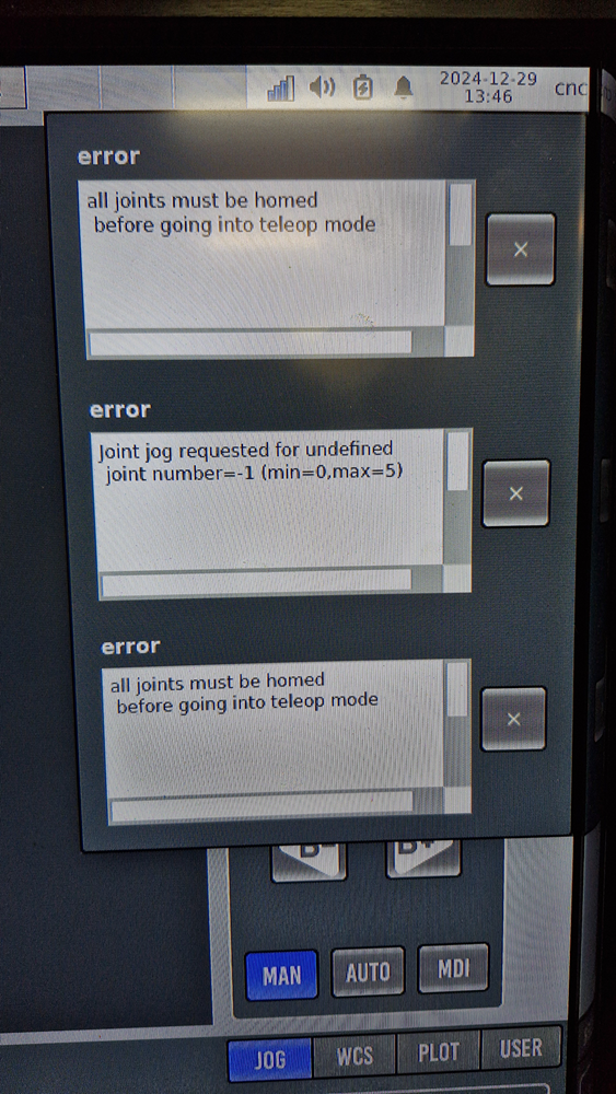

29 Dec 2024 13:05 - 29 Dec 2024 16:16 #317602
by CNC_ANDI
Replied by CNC_ANDI on topic Probe_Basic Bugs?
ok update...today i got a working 3 and a working 4 axis plot to my machine configuration...the 3 Axis working plot is just fine all buttons working correctly.but in the 4th axis plot the Zero B button did not work. DRO works correctly to my b axis.and when i do single ref for all axis (not refall button) i cant jog my machine and become a error like this from the attachment.
is this an error from porbe_basic or from linux_cnc? iám running linux cnc 2.9.0 pre ...
edit: I solved the Zero B error... G10 L2 P{ch[0]} B0.0 needs to be G10 L20 P{ch[0]} B0.0
