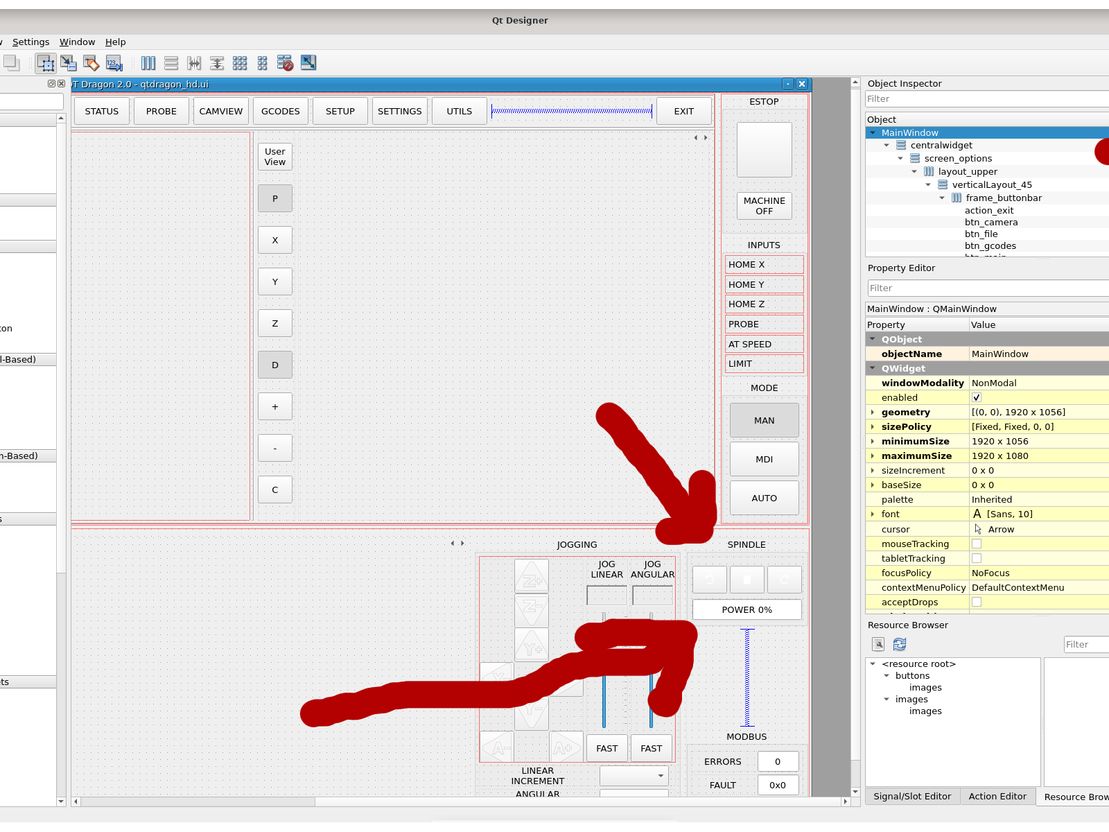

18 Oct 2021 09:06 #223454 by ikkuh
Replied by ikkuh on topic qtdragon pins?
Is there a reason why similar pins have different names in qtDragon and for example Axis?
Even between qtDragon and qtDragon_hd same pins are named different. This makes it unnecessary difficult to change between screens during testing (I switch a lot  between qtDragon and the HD version, the functionality is different between the two).
And sometimes it is almost impossible to get something to work. How do I use the power indicator in the VFD box to the right?
And are the some led's in the switches so I can see on screen what direction the spindle is turning?
18 Oct 2021 11:12 #223471 by persei8
Replied by persei8 on topic qtdragon pins?
The POWER label is a progressBar and it's value is calculated in the handler file by multiplying AMPS and VOLTS values read from the VFD. In a simulation, it will never be used. I did it this way because reading the power register from the VFD always returned 0 for some reason - something to do with the VFD which I have no interest in persuing.
As for spindle direction buttons, if you want indicators, select the button, check indicator_option, check indicator_status_option, check is_spindle_rev_status.  The normal and HD versions should each have their own hal files so switching back and forth should not be a problem.
18 Oct 2021 11:25 #223475 by ikkuh
first of all, thank you very much for this very nice gui. I use it on a 23" touchscreen and it looks really good.
Hopefully the remaped m6 toolchange will start to function soon too.
Thanks for making LinuxCNC a lot more professional.
OK, makes sense. I will add the voltage from my VFD to the hal file. Will be nice to see the powerbar move.
Ok, will do that in Designer.
But that is kinda my point, they should not have different hal files. A lot of the pins are already available and can be reused.
