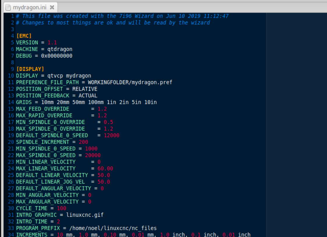

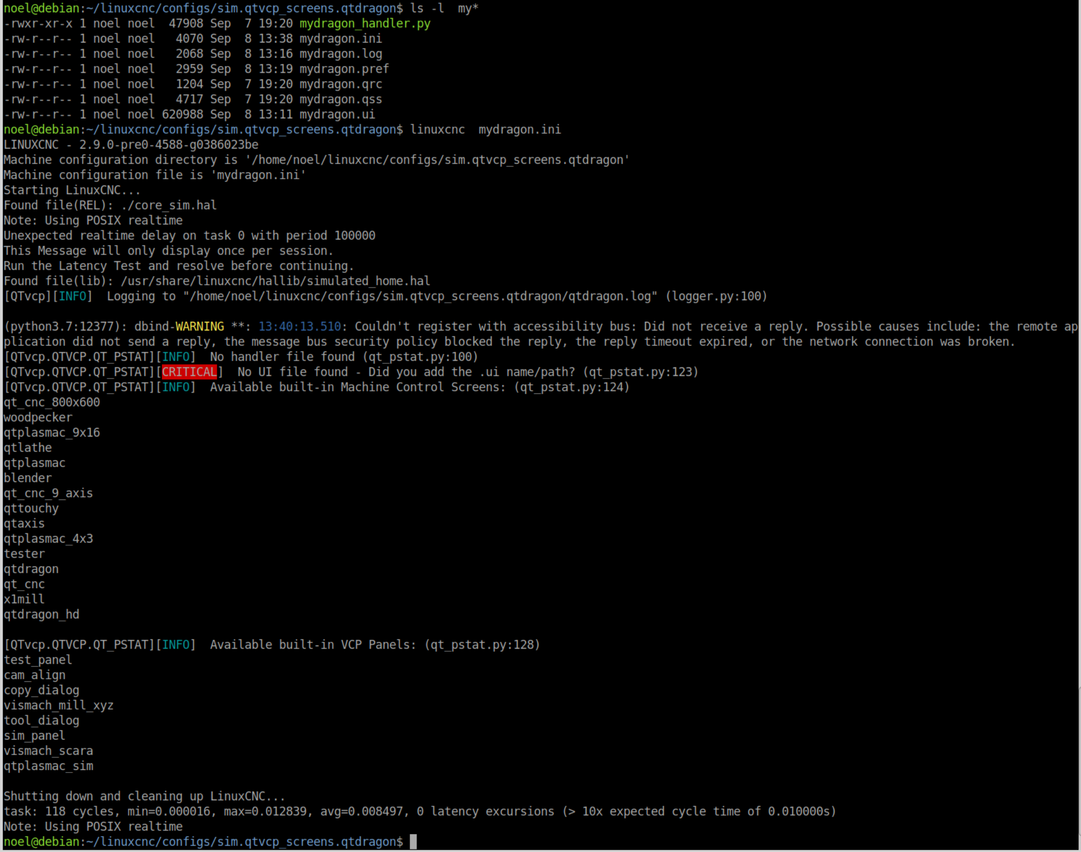

How the heck does one get linuxcnc to use the local .ui file?
The docs say  ' DISPLAY = qtvcp  mygui'
DOES NOT WORK.   see the error picture below, and .ini picture.
Docs  2.8 html docs. see section 1.7
Should be able to put all the files in the local config directory and have it work.
What's up?????
Please advise.
I just want a resizable dragon screen.

here is how to do what you asked for:
in you config folder that has the INI add a folder named (in your example) mygui.
inside that add your ui and handler file (using mygui as the base name.)
but if you are starting off by just modding qtdragon there is another way that might be better.
in a terminal enter:
qtvcp copy_dialog
a dialog will pop up that will help you select a builtin screen and a destination folder and copy it over.
I didn't add the ability to add a custom name but I guess I should.
anyways you can modify that ui/handler file and it will be used instead of the regular one.
meaning the ini file will still be
DISPLAY = qtvcp qtdragon
Chris
