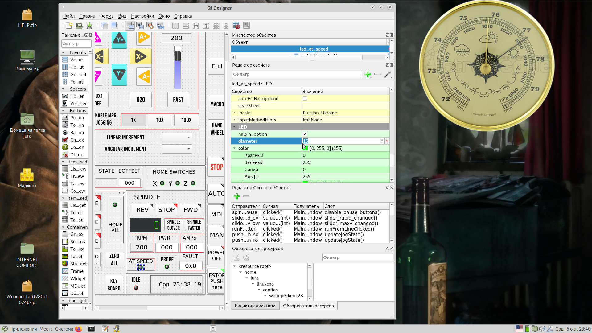

Well, got it sort of working.
and now trying a little customization.
I know lots can be done with the .qss file.
I would like to increase the diameter of the 'spindle at speed' led.
object name: led_at_speed
class: LED
I did find the led_widget.py file, so I can see what is possible to modify.
Just don't know exactly how to get started adding to the .qss file
Little help please? maybe best a short example.
thanks.

06 Oct 2021 15:43 #222401
by hottabich
Replied by hottabich on topic ??? how to load a custom gui file ???
And so?Well, got it sort of working.
class: LED
thanks.

- Posts: 7368
- Thank you received: 2181
06 Oct 2021 19:48 - 06 Oct 2021 19:49 #222416
Replied by cmorley on topic ??? how to load a custom gui file ???
To size a specific LED - use the widget name specified in designer with '#'
ie in qtdragon:
ie in qtdragon:
#led_at_speed {
QProperty-diameter:20;
Last edit: 06 Oct 2021 19:49 by cmorley.
The following user(s) said Thank You: Roguish

- Posts: 297
- Thank you received: 31
07 Oct 2021 09:20 - 07 Oct 2021 14:12 #222456
by Roguish
Replied by Roguish on topic ??? how to load a custom gui file ???
Chris, that's what I was looking for. thanks.
