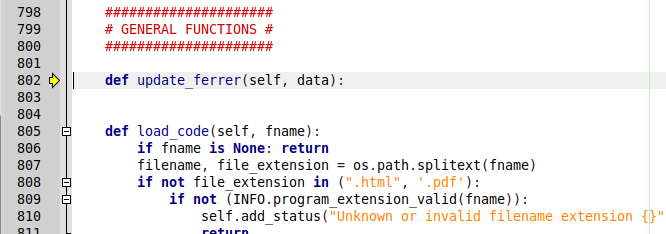

add something like this:
STATUS.connect('following-error', lambda w, data: self.update_ferrer(data))
def update_ferrer(self, data):
print (data)
print (data)

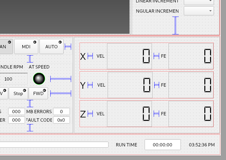

Ok, so I have a qtdragon stretchable, and just added a small section to display vel and ferror of x,y,z.and I've been going through the handler file. added your suggestion (def update....) in the general function section.
But I do not get how to connect the LCDNumber widgets to the python.....
Here I'm also assuming (hoping) that the axes velocities are available.
they certainly are via hal pins....
So, a little help please.
If you would be so kind and to show how to do one, I can probably work out the others.....
Please....

Replied by cmorley on topic ??? how to load a custom gui file ???
You would use a regular QLCD widget.
you use the name set in designer to reference the widget (ie. xFerrorLCD)
I also forgot you could use a statusLabel that watches a HAL pin - then there is no code to add,
and also covers the axes velocities you want.
double click the statusLabel and select misc/hal pin status then set the HAL pin name to watch.
You can use stylesheets or richtext to modify the look of the text.
Chris
STATUS.connect('following-error', lambda w, data: self.updateFerrerDisplay(data))you use the name set in designer to reference the widget (ie. xFerrorLCD)
def updateFerrorDisplay(self, data):
self.w.xFerroreLCD.display('{:.2f}'.format(data[0]))
self.w.yFerroreLCD.display('{:.2f}'.format(data[1]))
self.w.zFerroreLCD.display('{:.2f}'.format(data[2]))I also forgot you could use a statusLabel that watches a HAL pin - then there is no code to add,
Chris

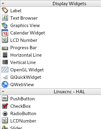

I just noticed there is an LCDnumber in both the 'Display Widgets; and the 'Linuxcnc-HAL' sections. are they the same? which one is proper for this application?
use the display widget LCD one - that is the plain qt widget, that can be set with handler code.
the HAL widget LCD is controlled by a HAL pin that you must connect in a HAL file so not as convenient.

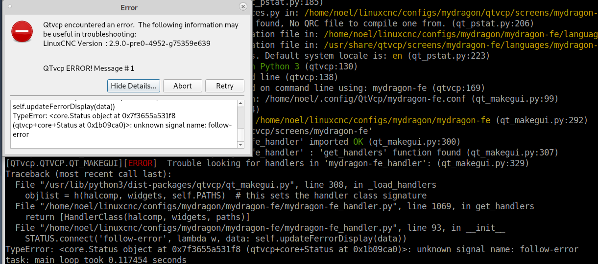

OK, still at it. trying to use both the LCDNumber and StatusLabel.
still seems to be trouble with the LCDNumber.
I have added the code you suggested to the handler.py file. I just don't get how it connects to the hal_glib.py file. If that's not where it connects, what file does it connect with?
I can post snippets of any of the files if it helps. not sure.
Ah, I also am running master on buster. updated regularly, including today.

Not my forte, but, there is a "follow-error" in your files, most probably should be "following-error".
