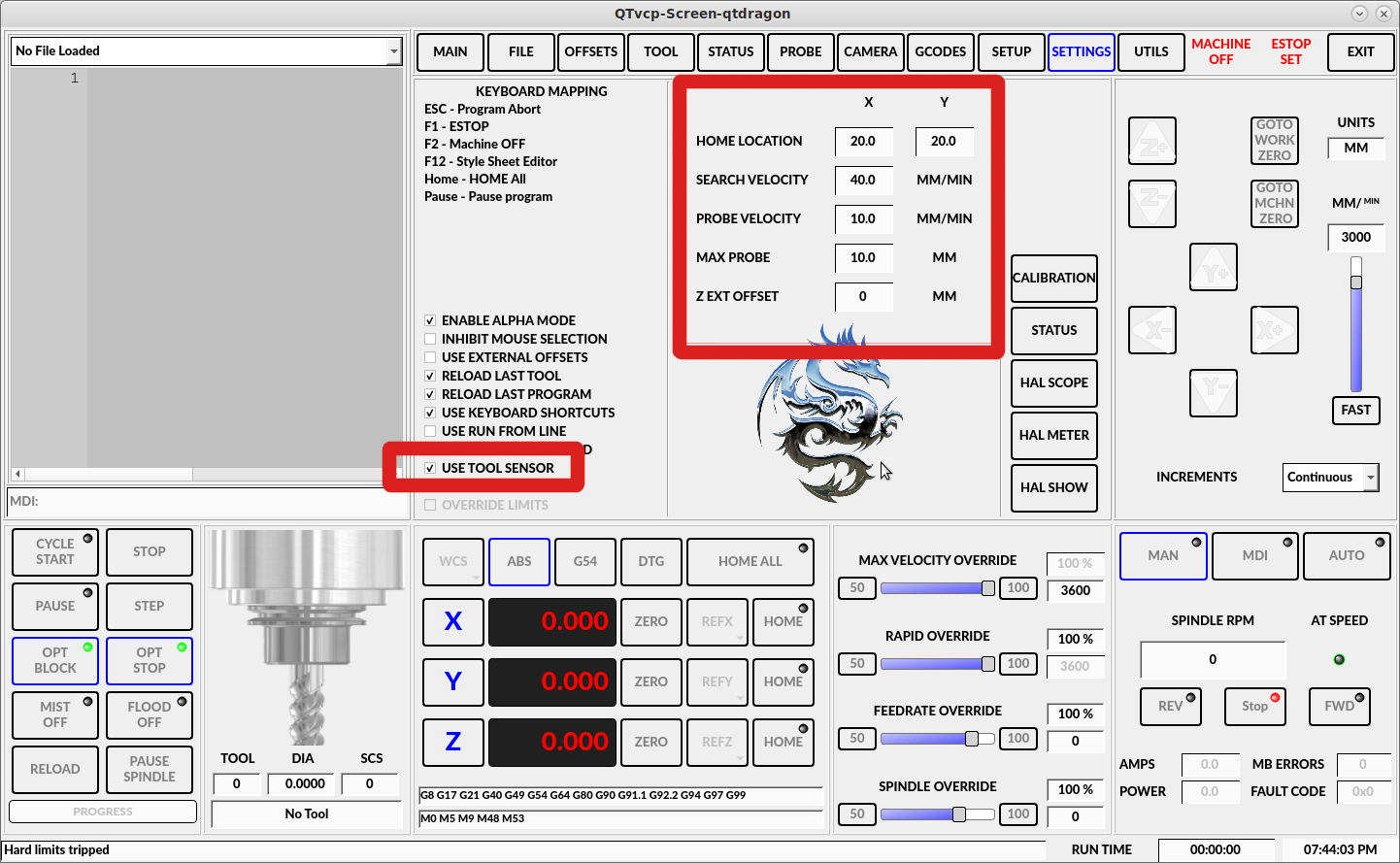

Does anybody know how to read variables from qtDragon?
In the change.ngc there are lines like this:
if [#<_hal[gmoccapy.searchvel]> LE 0]
The ngc file then reads values as they are entered in textfields in the gmoccapy settings screen. That way the values are dynamic and not static as they are in an .ini file.
if [#<_hal[qtdragon.searchvel]> LE 0] was not the solution
How do I read these values in qtDragon, most of the needed variables are already present there to make this working.

19 Nov 2021 12:21 #227011
by ikkuh
I had to many problems with stale values after a reinstall, so I just do not save the file anymore. Every start of the machine is a new fresh install.
But you can take a look at all the other files in my own git repository git.cnckloon.nl/PeterT/qtDragonNew
The machine works as I want and need it now. So the machine moves to a spot where I can change the bit easily, after I click Ok the spindle moves to a position above the toolsensor and does a G38.2 and applies the lengths to the tooltable and sets the Z height properly. All the other probing routines still function.
I think all the problems from not being able to use the gmoccapy routines comes from the version clusterfuck. I updated the python files and it started to work. Now just being able to use the values in the settings screen of qtDragon and I am very happy. Hopefully Chris can help me out there, he knows a lot about python and LinuxCNC.
Thanks for your help anyway, your files didn't work for me either. Still not sure why not, maybe I can check tomorrow.

Versaprobe in qt doesn't have the HAL pins - but I could add them.
Replied by cmorley on topic qtDragon toolchange and toollength setting
Can you list all the references you require?Does anybody know how to read variables from qtDragon?

They could be hal pins indeed.
git.cnckloon.nl/PeterT/qtDragonNew/src/b...ap/macros/change.ngc
#<_hal[gmoccapy.toolmeasurement]> ; indicate no tool measurement 0 or nonzero for proceeding
#<_hal[gmoccapy.probevel]>
#<_hal[gmoccapy.probeheight]>
#<_hal[gmoccapy.blockheight]>
Take a look at linuxcnc.org/docs/html/gui/gmoccapy.html...uto-tool-measurement for the meaning and purpose of those variables.
I marked the corresponding values in picture:
Replied by ikkuh on topic qtDragon toolchange and toollength setting
