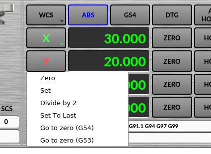

Returning to the topic of the axis buttons function. Could you add the "go to zero" function?.
I only added the titles to the axis_tool_button.py file to the screenshot. I do not have the functions working yet.

03 Aug 2024 16:34 #306864
Replied by cmorley on topic Error in tool_offsetview.py
yes.
I also have done some work on having the DRO clickable with similar options.
I think I will set it up as stylesheet options, so a user can change them fairly easily.

03 Aug 2024 23:49 #306889
Ok that work is pushed to master now.
I have not updated the docs yet, but stylesheets can change the options.
The menu items in the DRO or axis selection buttons can be made the same or any combination of those options.
Also now you can recover from pressing the zero button by selecting 'set to last' in the dro widget menu options.
let me know what you think.
Chrs
Chrs

04 Aug 2024 13:03 #306913
by MarkoPolo
Replied by MarkoPolo on topic Error in tool_offsetview.py
I tested it a bit, it works very well.
I like it.
It could be everything even in one menu, axis button, but if it is possible to customize the content of both menus, it is very good.
How to do it in the style sheet?
In qtdragon_hd, the ref buttons are probably no longer needed? If so, I can customize the layout..
Marek
I like it.
Marek

Here are the stylesheet properties, you can turn them on and off as you please.
They will change immediately.
DROLabel{
qproperty-showLast: true;
qproperty-showDivide : true;
qproperty-showGotoOrigin: true;
qproperty-showZeroOrigin: true;
qproperty-showSetOrigin: true;
AxisToolButton{
qproperty-showLast: false;
qproperty-showDivide : false;
qproperty-showGotoOrigin: false;
qproperty-showZeroOrigin: false;
qproperty-showSetOrigin: false;
Last edit: 04 Aug 2024 14:46 by cmorley.

04 Aug 2024 15:10 #306925
by MarkoPolo
Great.
That all works.
You could also add "dro_axis_*" to the "button_response_list"
in the handler file so that these functions are not available during operation.
That all works.
