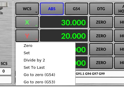

I added the "Go to zero" function to "axis_tool_button.py" but it makes little sense from the user's point of view.
What do you think about adding the ability to add such functions in an easier way, maybe in an ini file?
- Posts: 7368
- Thank you received: 2181
22 Jun 2024 19:34 #303562
Replied by cmorley on topic Error in tool_offsetview.py
I agree it seems the wrong place.
How do you propose INI button functions would work?
a list of builtin functions that can be enabled?
What functions?
What functions?

For now, I would like to have a "go to zero" function.
Could add a function to the axis_tool_button.py file, or create the possibility of adding macros to the button menu of individual axis.
I don't know what the best solution would be, but I miss the "go to zero" function for individual axes.

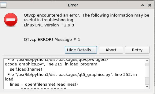

If you try to reload a file that no longer exists there is a python error.
If there is no file to reload I think the button should be disabled:
self.w.btn_reload_file.setEnabled(os.path.isfile(self.last_loaded_program))
Maybe under periodic_update in the qtdragon handler file?

What version are you using?
- MarkoPolo
- Posts: 319
- Thank you received: 90
21 Jul 2024 12:23 #305785
by MarkoPolo
Replied by MarkoPolo on topic Error in tool_offsetview.py
I tested on 2.9.3 and master, and the error comes from gcode_graphics.py or qt5_graphics.py
