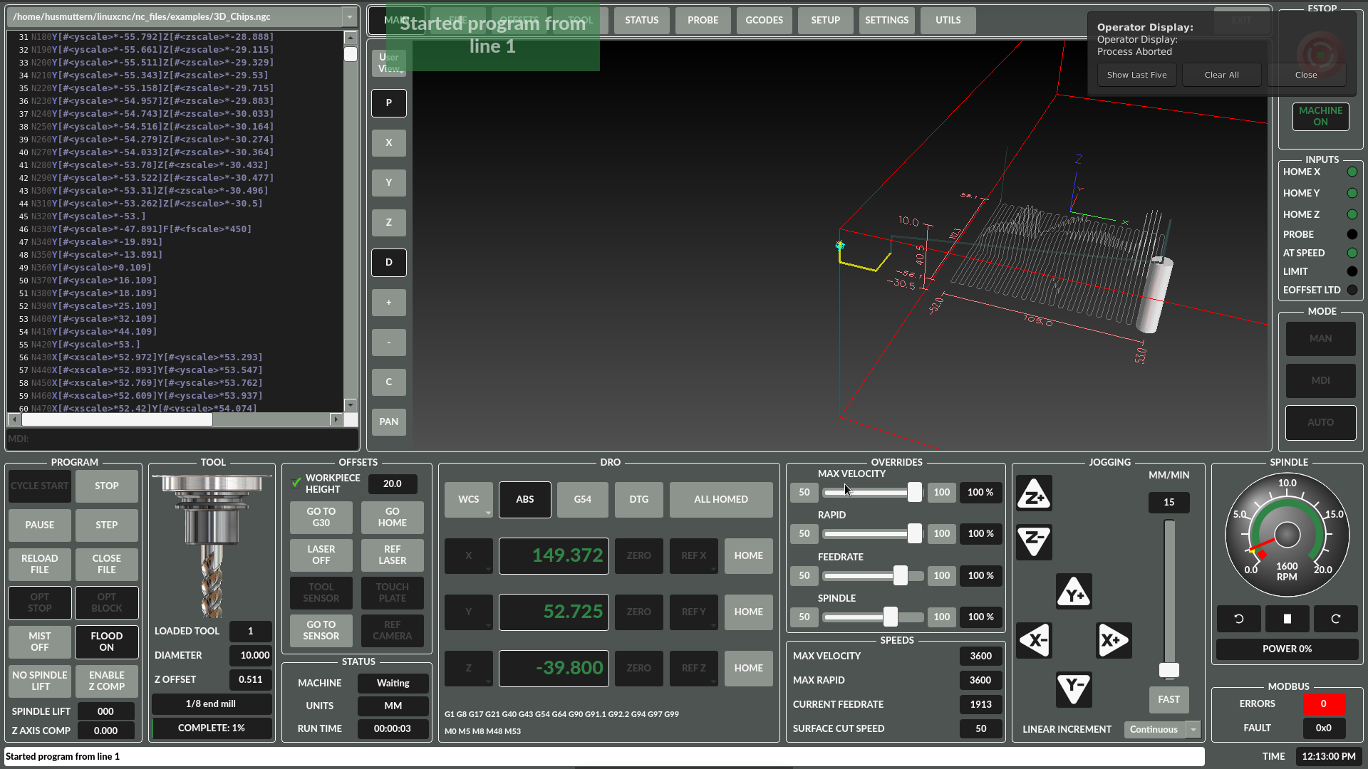

return getattr(self, 'set_view_%s' % self.current_view)()Please Log in or Create an account to join the conversation.
- snowgoer540
- Posts: 2580
- Thank you received: 907
02 Oct 2024 23:21 #311202
by snowgoer540
Clicking on a line segment in the preview no longer highlights it (and subsequently the gcode preview line as well), likewise clicking on a g code line doesn’t highlight in the preview window anymore either.
Replied by snowgoer540 on topic Error in tool_offsetview.py
Thanks, I forgot one thing however, of course...

In glcanon.py we are nit getting a buffer for some reason:
def select(self, x_view, y_view):
if self.canon is None: return
pmatrix = glGetDoublev(GL_PROJECTION_MATRIX)
glMatrixMode(GL_PROJECTION)
glPushMatrix()
glLoadIdentity()
vport = glGetIntegerv(GL_VIEWPORT)
gluPickMatrix(x_view, vport[3]-y_view, 5, 5, vport)
glMultMatrixd(pmatrix)
glMatrixMode(GL_MODELVIEW)
glSelectBuffer(self.select_buffer_size)
glRenderMode(GL_SELECT)
glInitNames()
glPushName(0)
if self.get_show_rapids():
glCallList(self.dlist('select_rapids', gen=self.make_selection_list))
glCallList(self.dlist('select_norapids', gen=self.make_selection_list))
try:
buffer = glRenderMode(GL_RENDER)
except Exception as e:
print(e)
buffer = []
if buffer:
print('buffer')
min_depth, max_depth, names = (buffer[0].near, buffer[0].far, buffer[0].names)
for point in buffer:
if min_depth < point.near:
min_depth, max_depth, names = (point.near, point.far, point.names)
self.set_highlight_line(names[0])
else:
print('No buffer')
self.set_highlight_line(None)
glPopMatrix()

In gcode_graphics.py, yet another self.makeCurrent()Does that work?
def select_fire(self):
if self.inhibit_selection: return
if STATUS.is_auto_running(): return
if not self.select_primed: return
x, y = self.select_primed
self.select_primed = None
self.makeCurrent()
self.select(x, y)Please Log in or Create an account to join the conversation.

For me adding self.makeCurrent() to gcode_graphics.py solves the problem. it works
