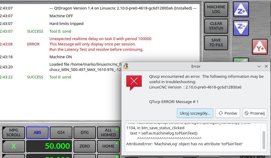

Hi Chris
I found a few things to fix in qtdragon(hd)
When saving the log to a file, an error is displayed, as in the screenshot.
The "clear status" button does not work.
In MacroTab Widget, the spacebar does not work.
In all others, "FACING", "hole enlarge", etc. pause works with the spacebar, but with MacroTab it does not.
There is such a topic forum.linuxcnc.org/38-general-linuxcnc-q...p-line-number#330090
Could you make it save the line number, e.g. in the log?

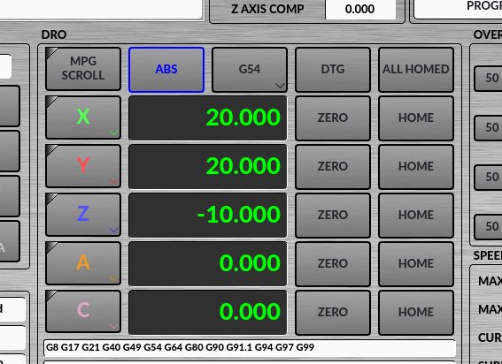

Hi Chris
Have you looked at the problems I wrote about?
I've noticed that qtdragon_hd_vert has a lot of bugs. In 5-axis mode it doesn't start at all... If you want I can fix it (to be honest I already have the fixed file ready)?

Log problems should be fixed now
- MarkoPolo

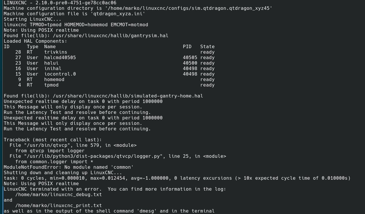

After changes in the master version it does not start, error as in the screenshot. In the compiled version some configurations work and some do not, but maybe it is only my problem.
I am sending a corrected ui file of qtdragon hd vertical.
I do not know if the new sim directory for vert. I have tested almost all ini configurations and they work with the vert.ui version, so it is probably not necessary.

The error is my fault - in the process of fixing - sorry.
Ok thank you for the .ui file!

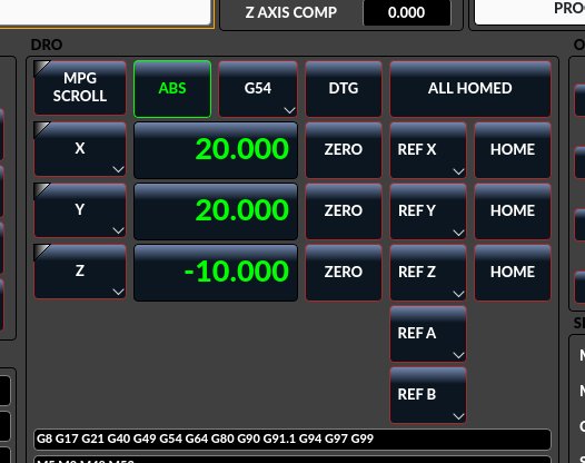

I see a few more wrong button dimensions in the qtdragon vert file, I'll fix that. (I think I didn't send the right file)

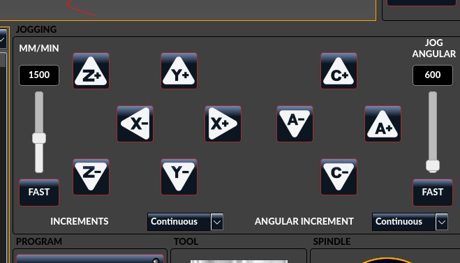

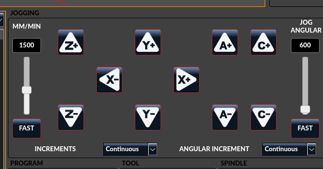

Which jog button layout is better?

2

I fixed the screenoption colors and axis button LED color on 4th and 5th axis?
I could not get those tool buttons be the same size - ran out of patients!
I agree with Tommy, the one on the right.
