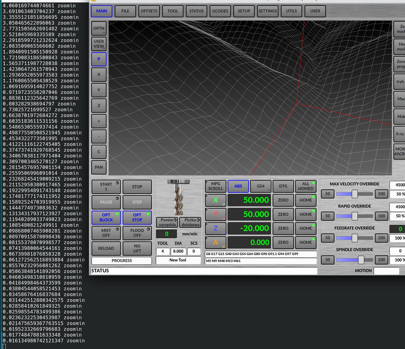

The preview window has a similar problem to the Vismach. There's no limit at all to the maximum and minimum zoom. You can zoom in infinitely without any visual effect, and the same applies to zooming out. There's also a tweak to the s value, which doesn't work linearly with zooming in and out, and at certain zoom levels, moving left, right, and up is difficult.
I'm uploading the corrected glnav.py.
Please try it out.
Please try it out.

Replied by cmorley on topic Error in tool_offsetview.py
Works great for me.
Pushed.
Pushed.

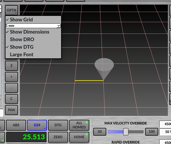

1. The grid in the preview is in inches; it doesn't switch to millimeters when the machine is running in metric mode.
2. The "run time" window freezes when paused, but when resumed, the time is set as if it weren't paused. Shouldn't that be the case?

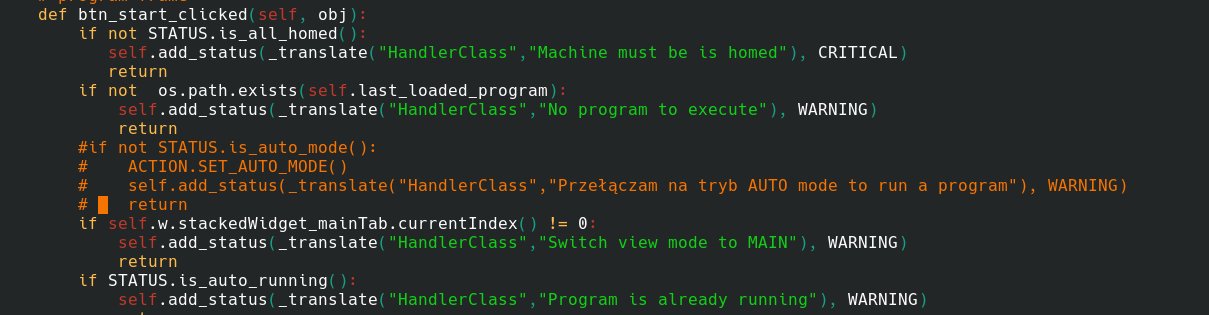

3. Manually switching between MANUAL MDI and AUTO modes is unnecessary in many cases and sometimes annoying.
For a long time, I've been using the "btn_start_clicked" function without checking if the machine is in the "auto" state. After pressing start, the machine switches to auto mode automatically, and it works very well.
I'd like the "file" button to work similarly.
After pressing "file," switch the machine to manual mode and open files.

1) grid
It was never intended to switch sizes on g20/21.
But I see in the metric sim the mm sizes are not metric at all.
strangely in the inch sim, metric and imperial sizes work properly.
This seems to be in the glcannon code, so is not fixed yet.

ya that's not right and I think its fixed now.
3) mode switching
I created a hidden 'auto mode switch' option - enabled in the preference file only.
I think it does what you want. please try it out and if it is I will make it a settings option. (if running a program, the file tab will still not change to the file page FYI)

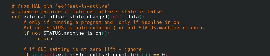

Regarding issue number 4, I've found the problem.
The auto mode check condition in the "external_offset_state_changed" function also needs to be removed. After this change, everything works correctly.

Hi Cmorley
I've tested it some more, and I don't need to touch "def external_offset_state_changed(self, data):"; it works fine without any changes. I don't know why I had the problem before, but the stop button is still a problem.
To stop the spindle, I have to press stop a second time.
