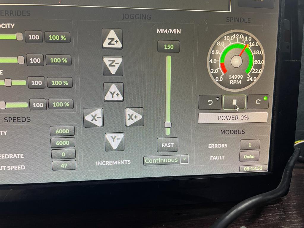

There is also a problem that the motor starts to spin from 50Hz to 400Hz, and the qtdragon at this frequency already shows 3000 rpm.
I don't know how to fix it yet.

Atm everything works except the power bar and error/fault display underneath the spindle gauge.I still get a s32/u32 error even if I edit the handler.py located at /usr/share/qtvcp/screens/gtdragon_hd/ when trying to display error/faults.
Also I think some pins need to be connected differently in the vfd.hal to have the power bar displayed.
When everything works correctly I would like to edit the first post of this thread with the correct solution.

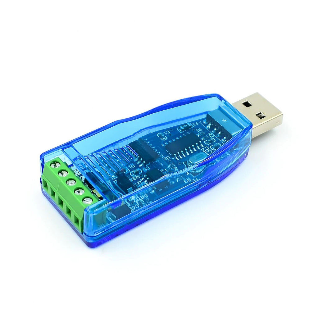

This is what I have done till now to get the YL620 VFD to work with qtdragon_hd . Bellow the links as a reference because this is not my work. I’m just trying to gather it all together in one place so life should be easier for someone else with the same setup.
forum.linuxcnc.org/qtvcp/42161-qtdragon-pins-rpm-and-docs
github.com/aekhv/vfdmod/wiki
github.com/xsnoopy/LinuxCNC-Yalang-yl620...s485-Modbus---VFDmod
linuxcnc.org/docs/devel/html/gui/qtdragon.html#_spindle
Using LinuxCNC 2.9 on Debian Buster.
This solution is based arround VFDMod and Modbus RS485 communication with a Yalang YL620 Variable Frequency Drive. I am using a RS485 usb adapter as the one in the picture bellow
#1 Set up the Yalang YL620 VFD to drive to receive signals via Modbus.
P00.01 = 3 Start/Stop command source RS485
P03.00 = 4 for 19200Bps
P03.01 = 1 RS485 slave address 1
P03.02 = 2 Data transfer format 8 bit data, 1 stop bit, no parity
P07.08 = 5 Frequency source selection RS 485
#2 Install VFDMod from here github.com/aekhv/vfdmod/releases

#PinName=user-coil-parameter#4 Make qtdragon_hd correctly display the spindle gauge division
In the .ini file of your machine under [DISPLAY] add
#Spindle
MIN_SPINDLE_OVERRIDE = 0.5
MAX_SPINDLE_OVERRIDE = 1.5
DEFAULT_SPINDLE_0_SPEED = 3500
SPINDLE_INCREMENT = 200
MIN_SPINDLE_0_SPEED = 3500
MAX_SPINDLE_0_SPEED = 24000
MAX_SPINDLE_POWER = 1500#5 Add
loadusr -W vfdmod vfd.ini#6 Add
source vfd.halAttachments:

04 May 2022 16:34 #241988
by MarkoPolo
Replied by MarkoPolo on topic Need help connecting vfdmod and Qtdragon_HD
I use qtdragon but I checked qtdragon_hd and it works for me too.
I have the following entries in the vfd.hal file:
net spindle-error-count vfdmod.rs485.error-count qtdragon.spindle-modbus-errors
net spindle-error-last vfdmod.rs485.last-error qtdragon.spindle-fault
the qtdragon_hd_handler.py file should look like this:
pin = QHAL.newpin("spindle-fault", QHAL.HAL_S32, QHAL.HAL_IN)
pin = QHAL.newpin("spindle-modbus-errors", QHAL.HAL_S32, QHAL.HAL_IN)
If you are using qtdragon_hd try qtdragon, though it shouldn't make any difference.
In the main ini file, just change to DISPLAY = qtvcp qtdragon
The following user(s) said Thank You: oficinerobotica

08 May 2022 19:39 #242320
by oficinerobotica
Replied by oficinerobotica on topic Need help connecting vfdmod and Qtdragon_HD
Ok, so I got the error count and code to be correctly displayed.
Now the vfd.hal has changed slightly.
Also the vfd.hal should be setted up crrectly to have the power bar displayed, the problem is that, if using hal meter the "vfdmod.parameters.OutputCurent" pin always reports 0 and I don't understand if it is a vfdmod problem or a vfd.ini file problem.

09 May 2022 14:38 #242382
by persei8
Replied by persei8 on topic Need help connecting vfdmod and Qtdragon_HD
If the reported current is always 0, the power will always be 0. I did it this way because my VFD always reported a power reading of 0 so it wasn't very useful. To see how the power is calculated, look at the spindle_power_changed method in the qtdragon_handler file.
A handy tool I found for debugging modbus issues is modpoll .
In your hal file, net spindle-current <= vfdmod.parameters.OutputCurent
is specified twice. Also, current is misspelled but so long as it's consistent everywhere, it won't matter.
Jim
Jim

09 May 2022 17:03 #242396
by MarkoPolo
I think that the problem is the current value in vfd, so I read it somewhere in the network. The front panel of the display also shows the value 0. It is possible that the current value is in a different register. This is how I read register values, e.g. from 1-1200 using the bmpoll program "for i in {0..1200}; do mbpoll -b 19200 -1 -P none -v -1 -t 4 -r $i /dev/ttyUSB0; done 2>/dev/null |grep \[[0-9]\]: 2>&1", but so far I haven't found a value that could be the current value.
How does the speed scale work for you? For me, the engine starts to spin only when I give it a speed of 3000 , I have partially solved this problem, but not completely.

09 May 2022 17:38 #242398
by persei8
According to the YL620 manual, output current is in register P11.02. With modpoll, you can read single registers or a block of registers. I never used bmpoll. This may be stating the obvious, but make sure the modbus adaptor is set to the same serial parameters as the VFD. As for speed, my VFD has a minimum speed it can run, which is set in one of the registers. Yours likely also has a minimum allowable speed.
