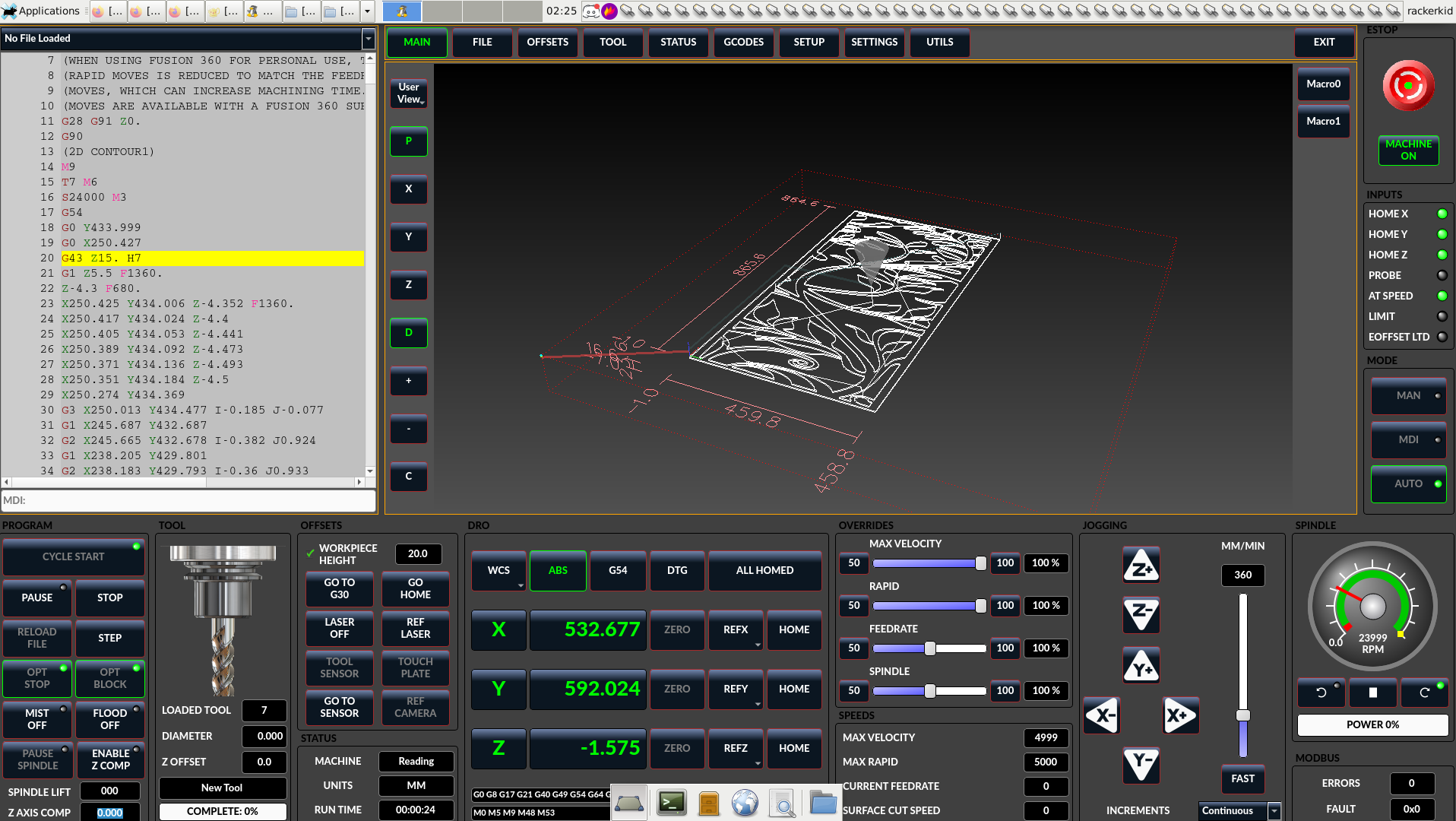

09 Dec 2022 15:00 - 09 Dec 2022 15:01 #259043
by dashy81
Replied by dashy81 on topic Need help connecting vfdmod and Qtdragon_HD
Ok... so I added it to custom_postgui.hal. But on cyclestart after rapids machine gets stuck with spindle on.
Attached screenshot. It shows line where it gets stuck.

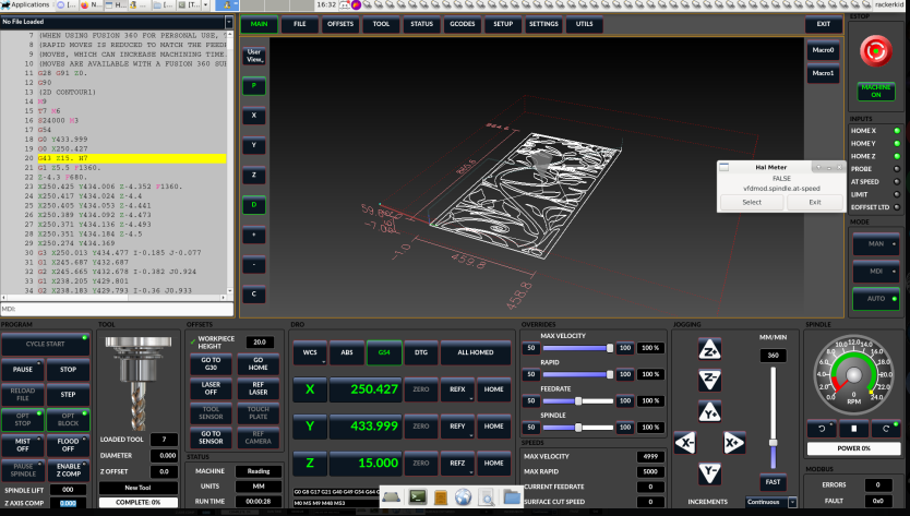

10 Dec 2022 05:11 #259079
by dashy81
I think you are right.... the signal you mentioned is false always.... but I can see the green led lit when spindle starts and gets stuck. Attaching image of halmeter reading and UI status. It always gets stuck at the line shown in the image.
I'm also attaching the full configuration here :
Please have a look guess we are inching closer towards a solution
https:/easyupload.io/u91hozPlease have a look guess we are inching closer towards a solution
- Posts: 7368
- Thank you received: 2181
10 Dec 2022 08:52 #259097
Replied by cmorley on topic Need help connecting vfdmod and Qtdragon_HD
It is not clear to me that the file vfd_2022-12-09.hal is even loaded.
nor custom_2022-12-09.hal
These fie need to be added to the INI as:
POSTGUI_HALFILE = vfd_2022-12-09.hal
or else the text in those files need to be added to qtvcp_postgui.hal or custom_postgui.hal
The following user(s) said Thank You: dashy81
