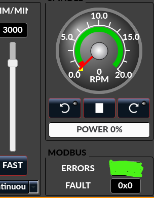

Should it be True or false for error?
Based on the pin name I would think True for connection.
That work for you?
Chris
Replied by cmorley on topic how to make my own custom page for qtdragon_hd?
HAL input pin 'spindle-modbus-connection'Bit like this
That work for you?
Chris

ok pushed. goes red if pin is false.

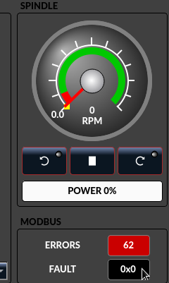

Stylesheet spindle mod works thanks.
The F12 stylesheet editor can't save to /usr/share so I did it by hand.
Modbus error count kinda works.
I would have thought qtdragon.spindle-modbus-connectionwould have been a bit type for true/false operation.
I converted my VFDMOD bit to u32
The Error count field goes red on an error and clears to black when restored.I guess from a HMI perspective, that makes sense as you should just highlight errors. So black is the new green!

Sorry I intended it as a bit.
In HAL you can use 1 and 0 with a BIT pin so I never noticed the type.
Next pull it will be fixed.
It does stick out like a sore thumb when red.
