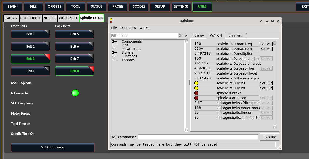

I am almost done!
But I have one more issue.
I made 4 general hal inputs on the panel
The status pins are updating in halshow but they are not updating in the display.
The nice green status LED is working.
Is there a trick here?
Can you apply a number format in Designer?
I've attached the .ui. If I can get this sorted it will be time to tackle the handler as I need som eon click events to enable/disable buttons

I have a handler file loading but it does not do anything yet.
I want to react to Belt button keypresses. I think i need to react to any hal button pressed in the processed_key_event, and call another function that parses and acts on the button click. but I have no idea how that event is defined. If you could have a look at the attachment and get one button working for me, or a bit more guidance, that would really be appreciated. There is nothing outling how to build a panel so it has been hard work
The final stage will be to save some data in the preferences file. If you can help me get ther, we'll end up with a complete example panel that perhaps could be included in QTdragon.
Replied by rodw on topic how to make my own custom page for qtdragon_hd?
Well, the panel should be done now subject to testing tomorrow.AHhh, I think I should have used a HalLabel. I thought thats what I initially used.

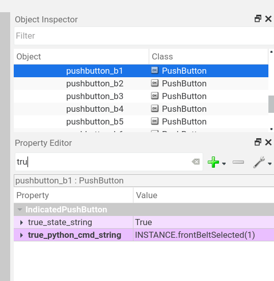

couple options, you can use slots and signals:
linuxcnc.org/docs/2.9/html/gui/qtvcp.htm...qtvcp:designer-slots
you could try Call Python Commands On State:
linuxcnc.org/docs/2.9/html/gui/qtvcp-wid...:indicatedpushbutton
each would call a function in the handler file to process the events.
maybe with a true state command such as:
INSTANCE.frontBeltSelected(1)
for front buttons use 1- 4
INSTANCE.backBeltSelected(5)
for buttons 5 - 8
in the handlerfile:
def frontBeltSelected(self, number):
print('front',number)
def backBeltSelected(self, number):
print('back',number)
just for a start.

Something like this?
I am not seeing it respond to the handler
I am still getting exceptions on keybindings everytime I press a key. COuld that be obscuring the action?wHow do we get rid of that?
# CALLBACKS FROM FORM #

Actually digging throught the log, I now seeMust be getting close!
[QTvcp.QTVCP.WIDGETS.SIMPLE_WIDGETS][ERROR] (pushbutton_b3 called exec in error:'VCPWindow' object has no attribute 'frontBeltSelected' (simple_widgets.py:617)
[QTvcp.QTVCP.WIDGETS.SIMPLE_WIDGETS][WARNING] Command was INSTANCE.frontBeltSelected(3) (simple_widgets.py:618)Please Log in or Create an account to join the conversation.

I forgot to mention you must set the 'python_command_option' property too.
the keybinding messages is because you are in debugging mode and don't have hotkey programmed.
I made a sample to show the buttons working. sorry i didn't find your latest files so they are the best i could do.

ok you must use the panels embed name in the python command:
INSTANCE.Spindle_Extras.backBeltSelected(5)
I will have to think on how to make that easier in the future.
