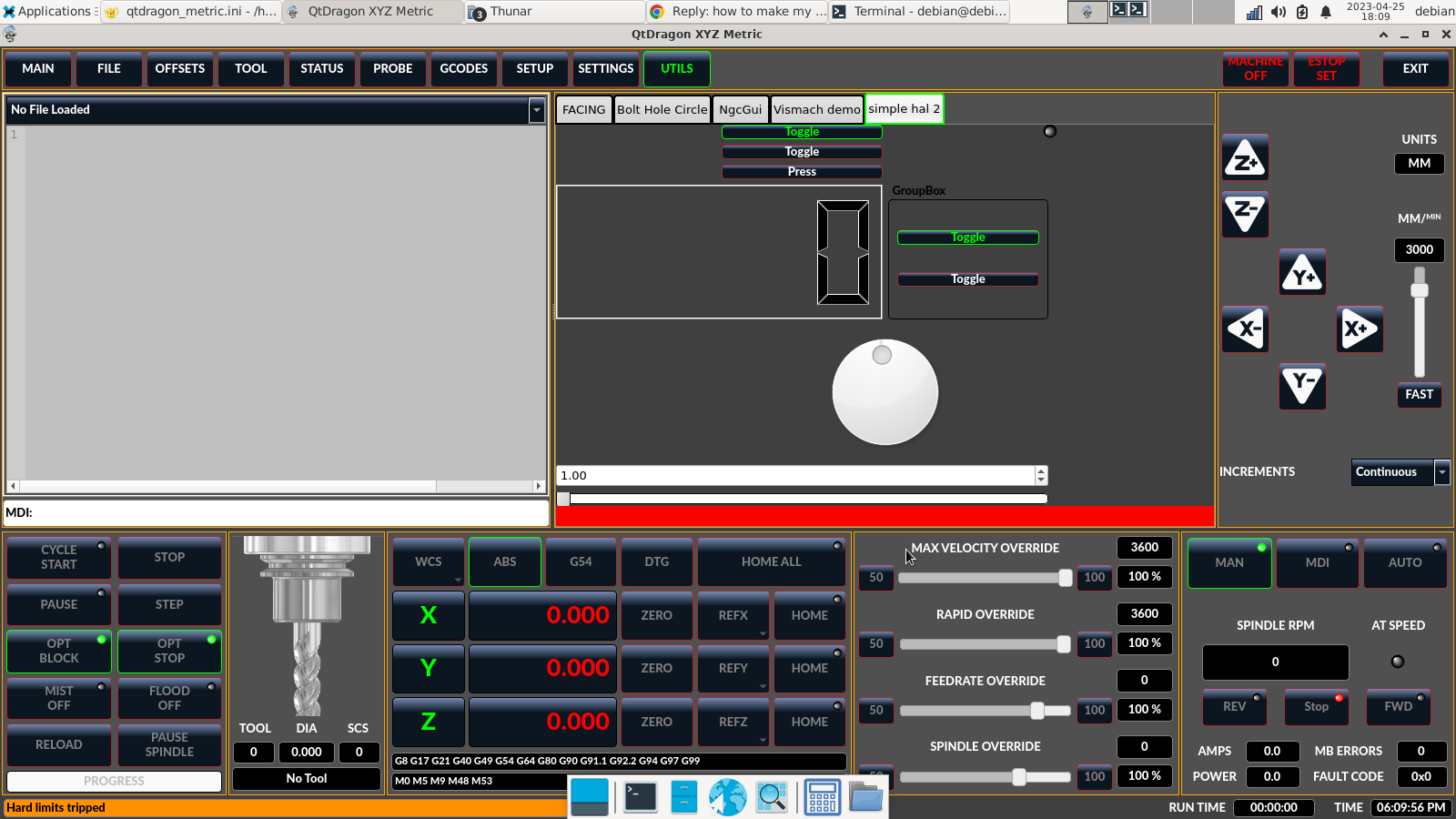

26 Apr 2023 00:21 #269926
Replied by rodw on topic how to make my own custom page for qtdragon_hd?
Well this is strange. Went to put this on my mill now I'm at work and it fails with a different error
Debian Bullseye, latest debs compiled from source and QTdragon_HD. Also tried Sebs buildbot too.
[/code][/code]
Warning: Spoiler!
File "/usr/bin/qtvcp", line 518, in <module>
_qtvcp = QTVCP()
File "/usr/bin/qtvcp", line 288, in __init__
self.panel = qt_makepins.QTPanel(self.hal, self.PATH, window, opts.debug)
File "/usr/lib/python3/dist-packages/qtvcp/qt_makepins.py", line 99, in __init__
window[pName].instance(uipath)
File "/usr/lib/python3/dist-packages/qtvcp/qt_makegui.py", line 382, in instance
instance = uic.loadUi(filename, self)
File "/usr/lib/python3/dist-packages/PyQt5/uic/__init__.py", line 238, in loadUi
return DynamicUILoader(package).loadUi(uifile, baseinstance, resource_suffix)
File "/usr/lib/python3/dist-packages/PyQt5/uic/Loader/loader.py", line 66, in loadUi
return self.parse(filename, resource_suffix)
File "/usr/lib/python3/dist-packages/PyQt5/uic/uiparser.py", line 1020, in parse
document = parse(filename)
File "/usr/lib/python3.9/xml/etree/ElementTree.py", line 1229, in parse
tree.parse(source, parser)
File "/usr/lib/python3.9/xml/etree/ElementTree.py", line 569, in parse
source = open(source, "rb")
FileNotFoundError: [Errno 2] No such file or directory: 'True'
[code][code][/spoiler]
At home I was using qtdragon, not the HD version and I was running it on bullseye there too.

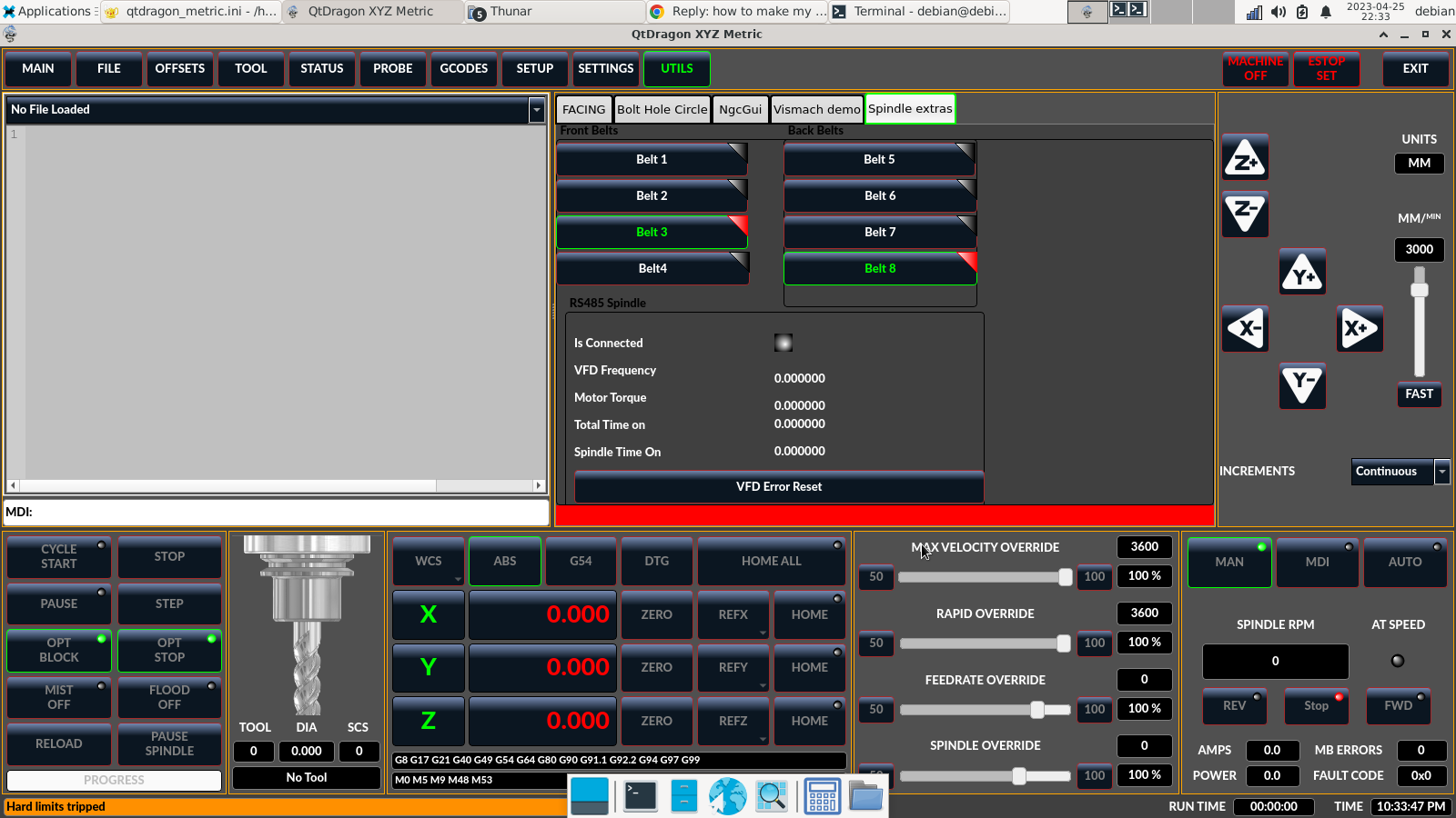

Yeh, everything seems good. Very odd.
I touched up permissions just in case but it made no difference.
Its like there is an odd character in the path or something
This opens the panel
Wierd
mill2@mill2:~$ ls /home/mill2/linuxcnc/configs/VMNmillQT/qtvcp/belts/*.ui
/home/mill2/linuxcnc/configs/VMNmillQT/qtvcp/belts/belts.ui
mill2@mill2:~$ EMBED_TAB_NAME = Spindle Extras
EMBED_TAB_COMMAND = qtvcp belts
EMBED_TAB_LOCATION = tabWidget_utilitiesIts like there is an odd character in the path or something
mill2@mill2:~$ qtvcp /home/mill2/linuxcnc/configs/VMNmillQT/qtvcp/belts/belts.uiWierd

26 Apr 2023 03:38 #269945
Replied by cmorley on topic how to make my own custom page for qtdragon_hd?
Qtvcp/panels/belts/
Not
Qtvcp/belts/
Not
Qtvcp/belts/
