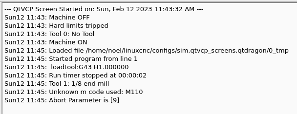

almost have it working. just get one error. see the image.
a file of M110 exists but I don't see anything calling it. at least not in the ngc routines....
also, since the premble file can be specified in the .ini, it would be nice to have it show in the left panel in the PRE line.
could the POST be specified, and show also? just thoughts.

preamble cannot be preset from the INI in 2.9 code.
Jim's code has advanced since then.
Without any idea what subroutines you are using I can't really help much with debugging.
The subroutine may call another subroutine that calls the M code.
The reason the M110 doesn't work may be because the INI setting SUBROUTINE_PATH =
doesn't point to where the M code is defined.
I will fix the misspellings thanks

12 Feb 2023 20:14 #264380
by Roguish
Replied by Roguish on topic NCGGUI and QtDragon
wow, you're on. thanks
I am just trying the slot and helix routines for examples.
I will move the m110 code to the subroutine folder and see what happens.
I was just entering another problem and the editor buggered and lost it. I will retype in a few minutes.

12 Feb 2023 20:18 #264381
by Roguish
ok, that worked. I move M110.ngc to the subroutine folder.....
