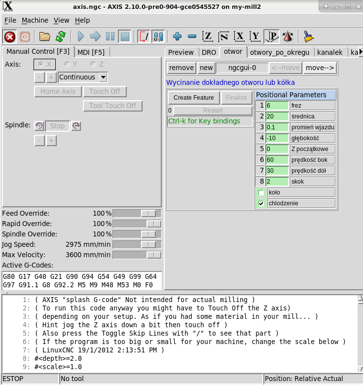

You were right, I forgot to add the on_abort.ngc file. I did a few tests and forgot about it.
Thank you very much. Now it is working!
I have one more question for you.
Have you heard of Checkboxes in NGCGUI?
My friend made a code that changes in ngcgui instead of 0 or 1 we have a checkbox.
However, this does not work with QtDragon_hd
Anything else I need to add? or will it not work together?
This works great in linuxcnc without Qtvpc. just like in the picture.

Your friend probably modified the original ngcgui code. Qtdragon uses it's own version of that code to make it work with qtvcp. However, it may well be possible to make the changes for qtdragon too. I'll have to look into it, right after I finish fighting with getting linuxcnc to work in a virtaul box.

great, let me know if you manage to do it, it will be much clearer for people who are just starting to use NGCGUI
