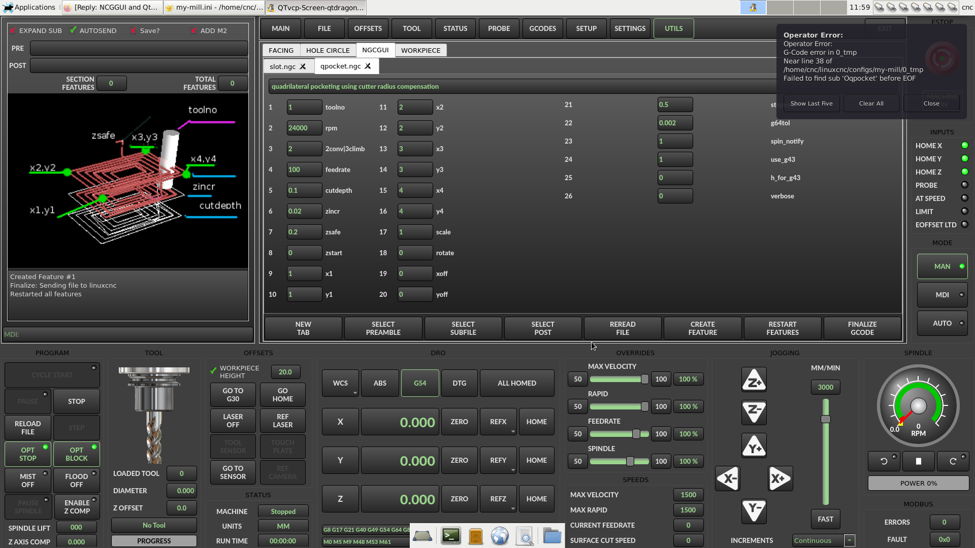

23 Feb 2023 15:58 #265123 by Dragonick
Replied by Dragonick on topic NCGGUI and QtDragon
Hi, I have linux master and qtdragon_hd.
I wanted to add ngcgui. It shows up, I can change the parameters.
but I can't run the created gcode, I get this error.
I checked and ngcgui works in pure linux without qtdragon.
Am I missing something?

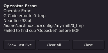

23 Feb 2023 16:02 #265124 by cmorley
Replied by cmorley on topic NCGGUI and QtDragon
In the ini, SUBROUTINE_PATH must point to the subroutine you call and must point to any subroutine that the subroutine calls.
So find where oqpocket.ngc is and add its path to the ini.
23 Feb 2023 17:02 #265127 by Dragonick
I have it like that:qpocket.ngc is located at:
/home/cnc/linuxcnc/nc_files/ngcgui_lib/
ini file i have:
[DISPLAY]
NGCGUI_SUBFILE_PATH = ~/linuxcnc/nc_files/examples/ngcgui_lib
NGCGUI_SUBFILE = qpocket.ngc
[RS274NGC]
SUBROUTINE_PATH = :~/linuxcnc/nc_files/examples/ngcgui_lib:~/linuxcnc/nc_files/examples/ngcgui_lib/utilitysubs; \
~/linuxcnc/nc_files/examples/probe/basic_probe/macros:~/linuxcnc/nc_files/examples/remap-subroutines: \
~/linuxcnc/nc_files/examples/ngcgui_lib/remap_lib
NGCGUI_PREAMBLE = mm_std.ngc
NGCGUI_SUBFILE = slot.ngc
NGCGUI_SUBFILE = qpocket.ngcas
in the attachment it sees ngcgui but throws an error:
23 Feb 2023 17:54 #265130 by cmorley
You answered your own question :)
The path of the folder with owpocket is not the same as
