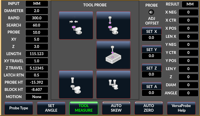

- Posts: 7368
- Thank you received: 2182
29 Dec 2023 17:31 #289348
Replied by cmorley on topic QtDragonHD tool sensor help for a maker space
This is the tab on versa that does tool probing.
The top left moves to the tool setter center.
Top right uses a probe to probe the tool setter height and will enter that.
Right middle will probe the work height and enter it
This is all similar process to auto tool measuring.
The bottom two are disabled - they will be for tool height entry into a tooltable (the right button is to offset the radius of tool)
They will still need some work.
probes are expensive, so I want to be pretty cautious about this.
obviously the docs are also only just a starting point to where I'd like to be.
Chris
Chris
