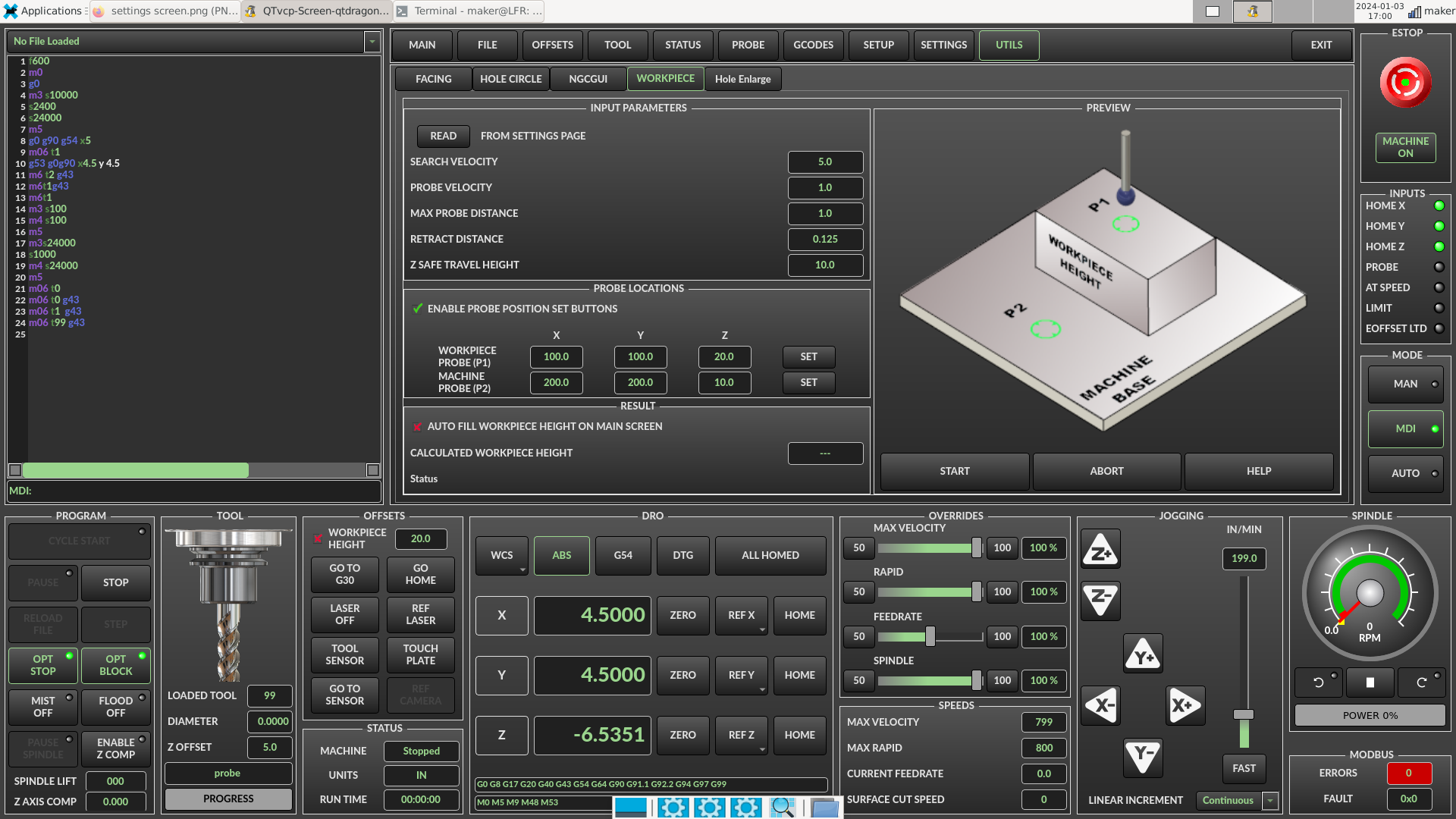

31 Dec 2023 20:10 #289445
Replied by cmorley on topic QtDragonHD tool sensor help for a maker space
Last night I tried the disabled tool probing and it works but I dare say it doesn't set the tool table properly - the number seems way too high.
I was looking for examples to go by eg:
www.cnctrainingcentre.com/training/cnc-h...tool-length-offsets/
Seems it common to reference from spindle face or from tool end.
Spindle face seems better.
I would guess then that one would need to know the distance in g53 for the spindle face to toolsetter - toolsetter height.
Then the difference between that and the touch off with a tool would be tool length.
roughly this is what I got (there is code before this to offset by radius for large tools)Z[#<touch_result> - tool_probe_height + tool_block_height doesn't seem right.
Comments?
cmdList.append('G91 ')
# should start spindle in proper direction/speed here..
cmdList.append('G1 X{}'.format(Xoffset))
cmdList.append('G38.2 Z-{} F{}'.format(self.data_ts_max,self.data_search_vel))
cmdList.append('G1 Z{} F{}'.format(self.data_latch_return_dist, self.data_rapid_vel))
cmdList.append('F{}'.format(self.data_probe_vel))
cmdList.append('G38.2 Z-{}'.format(self.data_latch_return_dist*1.2))
cmdList.append('G1 Z{} F{}'.format(self.data_z_clearance, self.data_rapid_vel))
cmdList.append('G1 X{}'.format(-Xoffset))
cmdList.append('G90')
cmdList.append('#<touch_result> = #5063')
cmdList.append('G10 L1 P{} Z[#<touch_result> -{}]'.format(
self.data_tool_number,self.data_tool_probe_height+self.data_tool_block_height))
cmdList.append('G43')
Comments?

31 Dec 2023 23:04 #289453
I need it broken down all the way down to machine integrator.
-tool probe the spindle face on the tool setter: gives a g53 number that will be setter height that is the reference to the spindle face.
-probe the tool setter with the spindle probe: gives me the spindle probe length. Will use this later to probe the work height.
-tool probe each tool on the tool setter. then (spindle probe length - probed length) = tool table tool length
- probe the work piece: (probed workpiece height - spindle probe length) = user origin offset
I must be getting close...

03 Jan 2024 06:23 #289638
Ok if you are interested in testing...
Need to add these files in to the appropriate folders. I assume you have an installed version.
I would keep copies of the old files to go back. Need to use sudo to modify these folders.
(rename the supplied files)
/usr/lib/python3/dist-packages/qtvcp/widgets/probe_routines.py
/usr/share/qtvcp/widgets_ui
If all goes well the button will work for 'probe height of the current tool'
You need to have 'probe height' set from the spindle face.
'tool probe toolsetter height' button will do this (it just probes straight down).
after that:
You need to choose a tool first of course.
need to manually set the Z height over the toolsetter
If you set the diameter of the tool and it's bigger then the tool setter diameter it will first move the radius in X.
it will double probe in Z and then pop up clear a bit.
The tooltable should show the new Z offset and the status will show the probed heights.
Please test carefully.
Hopefully the math is right and we can fine tune the routine.
Chris
after that:
Chris

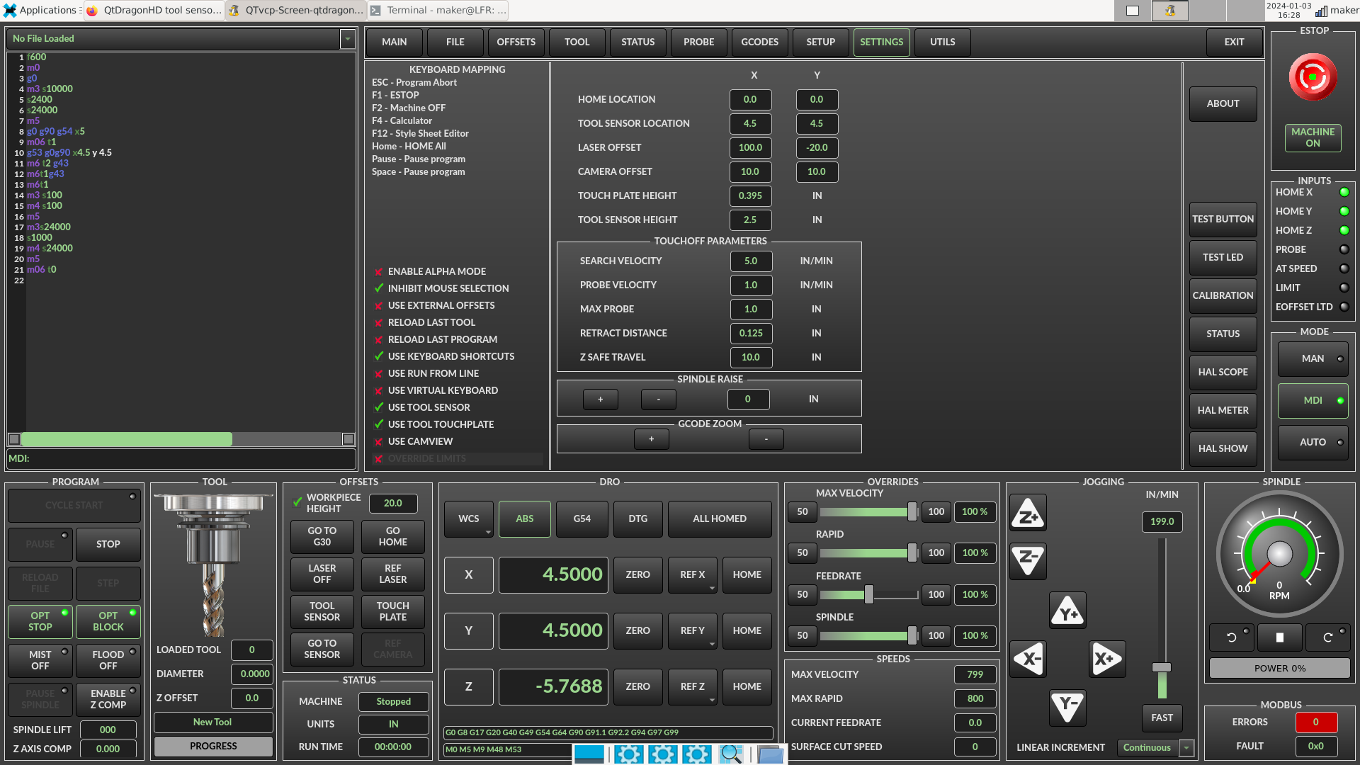

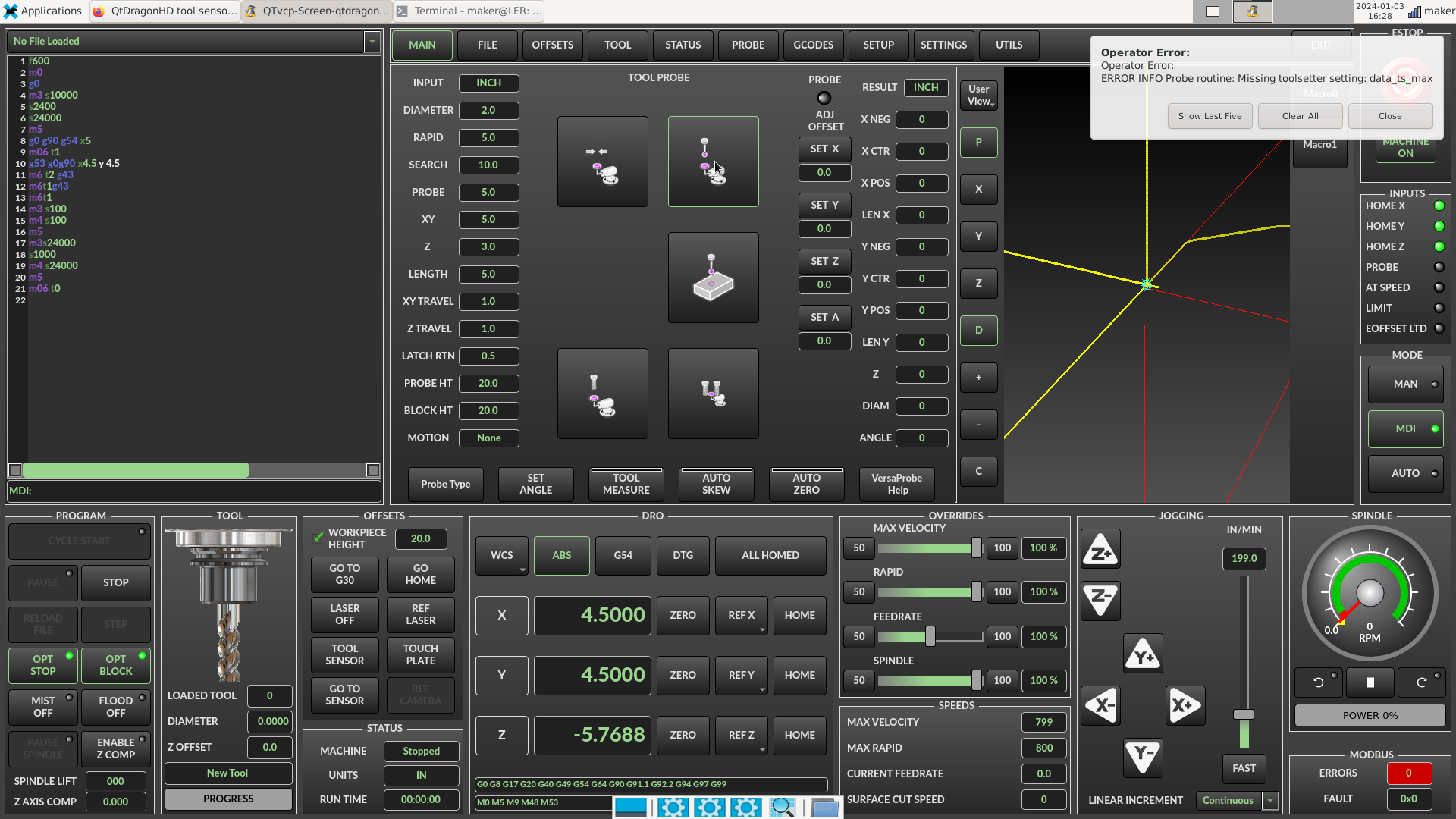

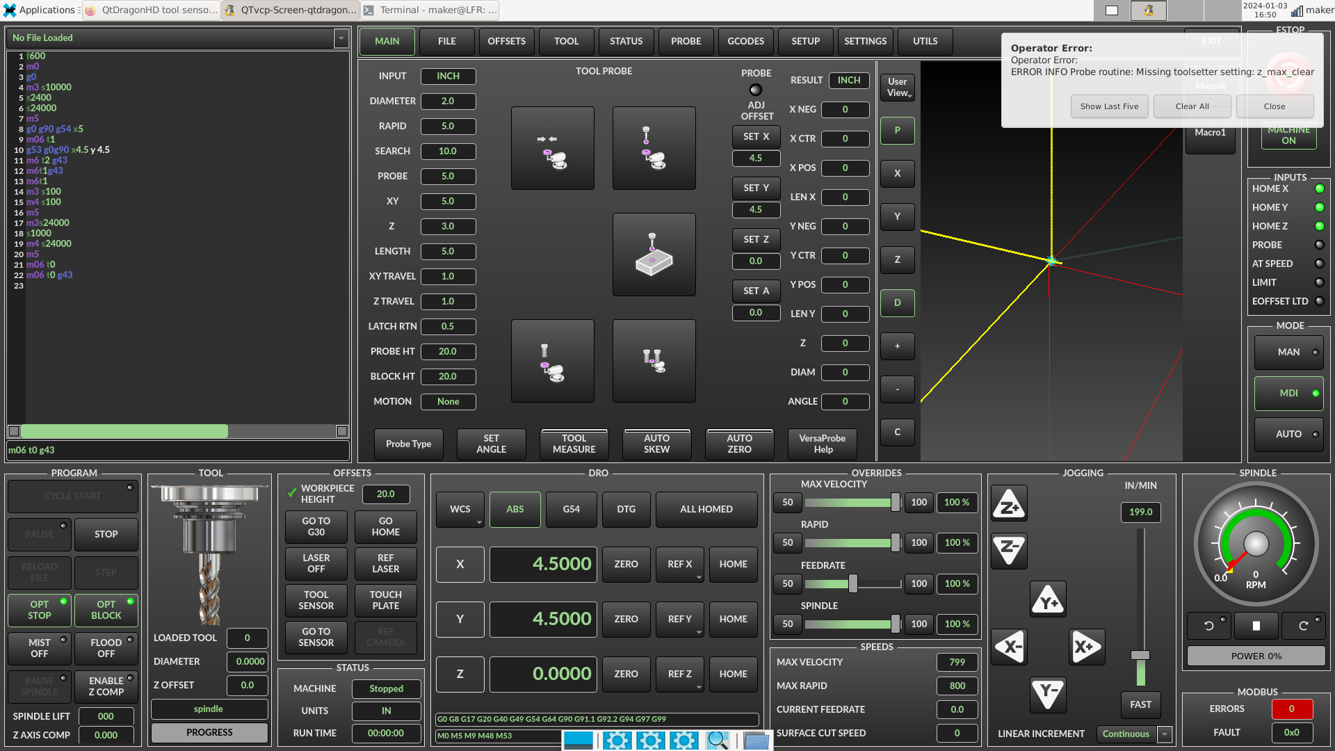

- warwickben
- Posts: 40
03 Jan 2024 22:01 - 04 Jan 2024 02:58 #289702
by warwickben
Replied by warwickben on topic QtDragonHD tool sensor help for a maker space
i backed up the two files and replaced them with the ones i down loaded.
made tool zero for spindle in the tool page , tried m06 t0 and m06 t0 g43 in midi . also did the same as t99 .i got the same error results for all 4 attempts. also the go to tool setter button in versa probe i get a different error. the button go to sensor in the bottom left side of the screen still works. i attached a couple screen shots showing the two errors i got and settings tab and utility tab. let me know what other info you need. im probably over looking some thing right in front of me. i tend to cant find things when im looking.
Last edit: 04 Jan 2024 02:58 by warwickben.
- Posts: 7368
- Thank you received: 2181
04 Jan 2024 06:47 #289741
You need to add the Z_MAX_CLEAR setting to the INI in the [VERSA_TOOLSETTER] section.
In fact it should look something like this numbers will be different of course:
For instance this is the sequence for go to tool setter button:
Travel to Toolsetter Action sequence:
# where in absolute (g53) machine units to probe the tool
[VERSA_TOOLSETTER]
# tool setter position in x y z (Z should be clearance)
X = 300
Y = 300
Z = -50
# set Z lift when moving to the tool setter
Z_MAX_CLEAR = 0
# tool setter diameter for diameter probing
DIAMETER = 25
# maximum machine units to lower while probing
MAXPROBE = 40
- go to VERSA_TOOLSETTER Z_MAX_CLEAR Z position
- go to VERSA_TOOLSETTER XY position
- go to VERSA_TOOLSETTER Z position.
