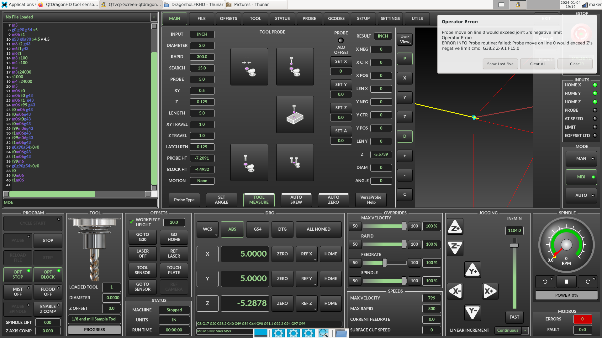

Z = -50 would this vaule be my spindle probe g53 then add say 5-6 inches to clear with tools for rapid down then slow feed?
# set Z lift when moving to the tool setter------- raise tool to home location for rapid over i assume
Z_MAX_CLEAR = 0
# tool setter diameter for diameter probing
DIAMETER = 25
# maximum machine units to lower while probing-----distance from z home to make probe touch?
MAXPROBE = 40
thank you so much , if i could send you a case of beer i would.Please Log in or Create an account to join the conversation.

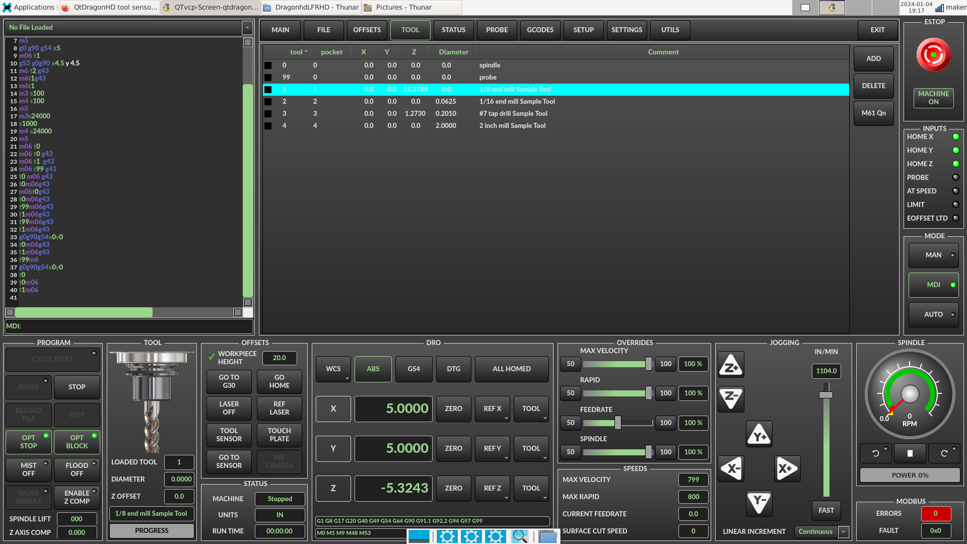

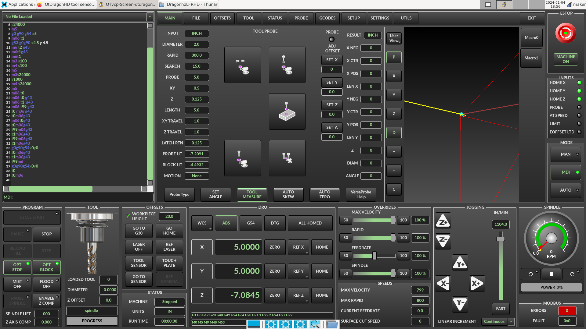

i attached my ini and my hal.i added tool zero for spindle and clicked the the probe setter button. it ran the probe routine and changed the value for probe HT to -7.2091 which makes sense since it matched the g53 read out when it tripped it. photo - spidle probe set .... no value change on the tool tab page for t0 z
i then put a tool in and loaded up t1. used the tool length measure button. that changed the t1 z value in the tool table to 15.3784 inches …….
also tool length set the probe and probed a work place, i forgot to take a screen showing the tool table value but it made g54 z +15.3784 inches not zero......
not sure if its a math issue or the way i set the spindle length.
go to sensor works fine.
a issue i did notice is the max z travel value added to ini file (i made both z i had to add 0) is over riding the max z travel for all probing i cant job roughly over the tool setter or work, i have to start at g53 z0 or i get a over travel error. see jog over setter picture.
Last edit: 05 Jan 2024 02:58 by warwickben.

Ok I think this will be better - I tested a bit on my system.
Here is a new probe_subroutine.py and still need the versa_probe.ui change from last time.
same deal:
tool set probe the bare spindle with 'probe tool setter height' button (can use the number from before if it hasn't changed) this number is without (tool or user offsets)
load/call a tool in linuxcnc - jog into toolsetter position
Tool set the tool with the 'tool height of current tool' button'
tool table should update and the status tab will show the calculated offset as well as the tool setter height and raw probe results.

You can probe the tool setter with the spindle probe . Which ever one trips first should trigger the action since they are sharing a pin. First time you can just mill a g54 face on scrap . Then probe and note the difference and use it as a comp value fkr future use. Just add/removing from the spindle tool table.
I’ll test it out once I get power back .
- Posts: 7368
- Thank you received: 2181
07 Jan 2024 23:35 #290164
Replied by cmorley on topic QtDragonHD tool sensor help for a maker space
Yes that does the same thing as my procedure - but easier
