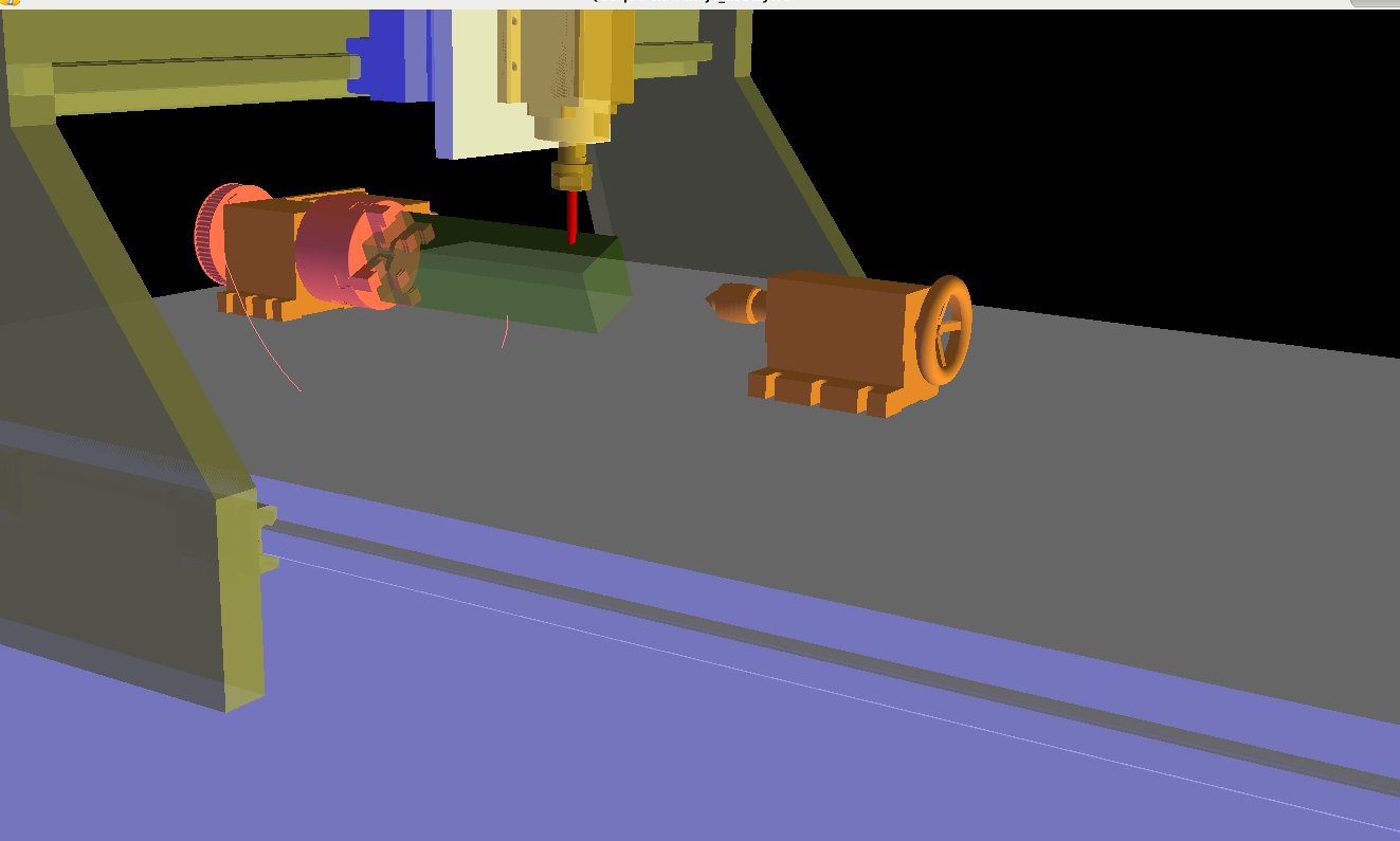

10 Mar 2024 16:47 #295584
by MarkoPolo
Replied by MarkoPolo on topic qtvismach, a axis toolpath
I made a small modification to the code and now it works properly.
I was hoping that the toolpath would be visible inside the solid, but this is not the case...

10 Mar 2024 16:53 #295585
Replied by Aciera on topic qtvismach, a axis toolpath
Interesting, the tool seems to be cut off too.

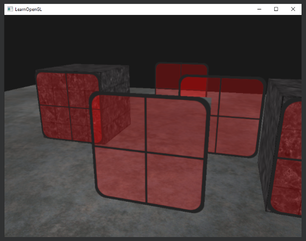

10 Mar 2024 17:04 - 10 Mar 2024 17:07 #295588
May have something to do with 'depth testing' as seen in this image where some of the background scene is not visible through the red tinted glass:
The above image comes from this article which may be useful:
drennonowereve.blogspot.com/2022/03/how-...color-in-opengl.html

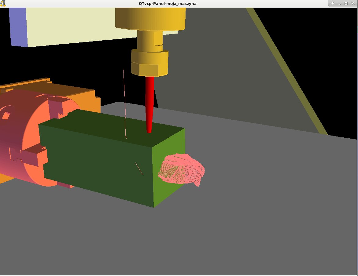

10 Mar 2024 17:53 #295594
by MarkoPolo
- Posts: 7368
- Thank you received: 2181
12 Mar 2024 03:33 #295712
Replied by cmorley on topic qtvismach, a axis toolpath
Maybe the order of the parts can do it.
I see you can see the base and chuck through the material but not the column or other chuck.
probably there is a opengl command to directly set Zdepth but like you i know just enough to get it to mostly work
