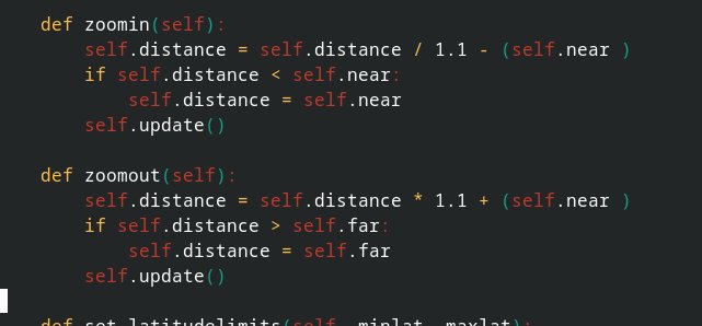

09 Dec 2024 07:15 #316331
by MarkoPolo
Replied by MarkoPolo on topic qtvismach, a axis toolpath
Perfect, it works this way. thanks
By the way, I propose a small change in qt_vaismach.py
in the zooIn and zoomout functions add and subtract the value of self.near.
Now, with a big zoom, you have to really turn the mouse wheel to fully zoom in and then zoom out.
After such a change, it is much more pleasant, more linear operation.
Such a correction would also be useful in the main preview window, but I haven't found a solution for this..
