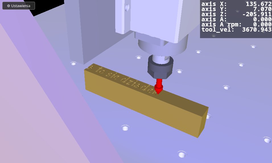

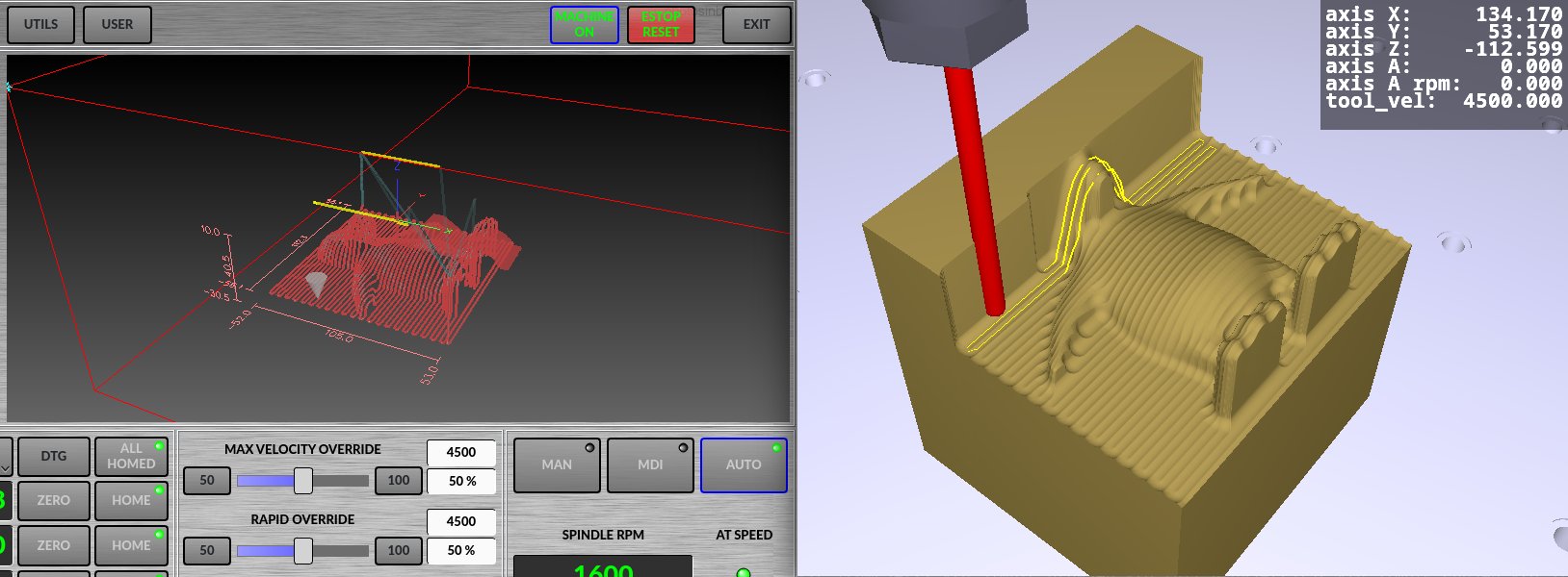

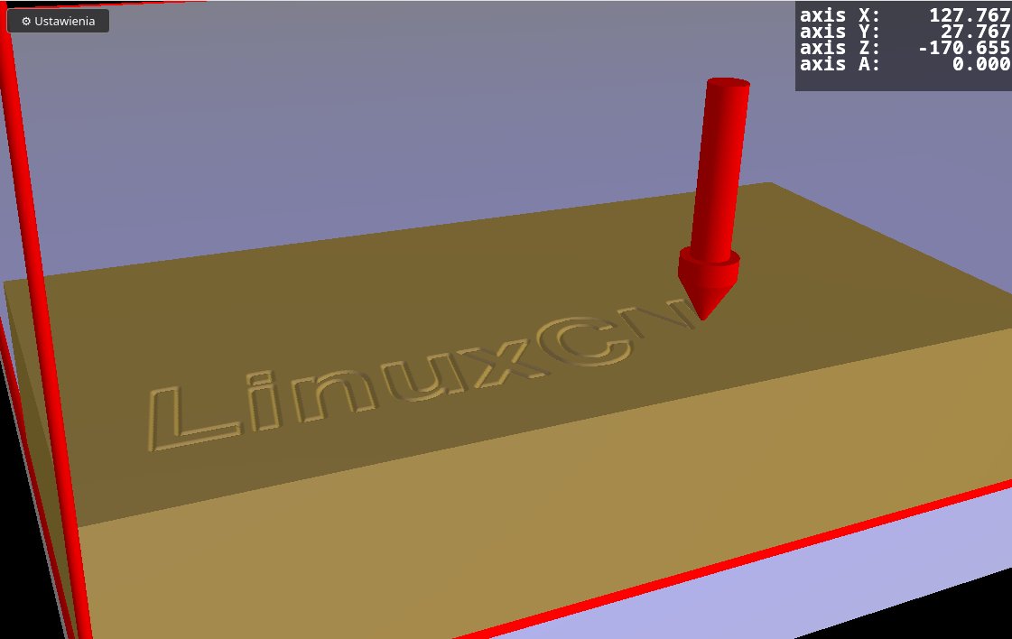

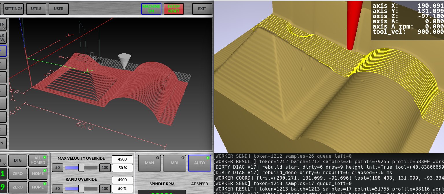

24 Sep 2026 21:40 - 24 Sep 2026 21:40 #349850
by MarkoPolo
Replied by MarkoPolo on topic qtvismach, a axis toolpath
I’ve recently spent a lot of time visualizing the workpiece in Vismach and optimizing toolpaths.
If anyone uses Vismach and would like to test this out, please let me know.
