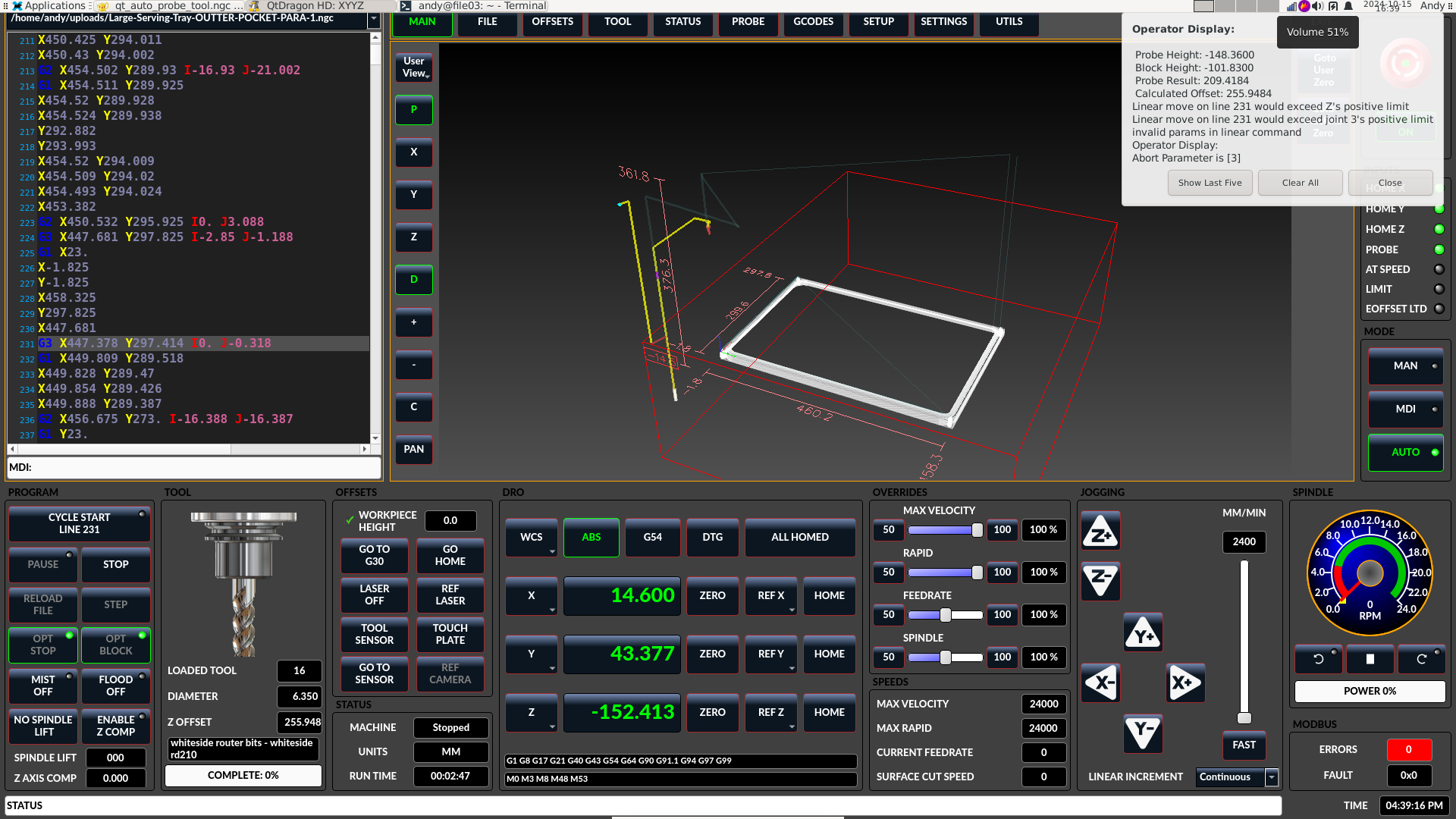

I'm using QTDragon HD and having issues when probing.
I am using the steps as outlined in the qt_auto_probe_tool.ngc file start off with.

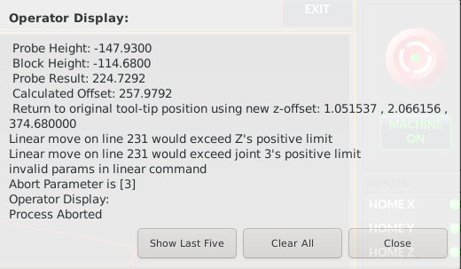

Here's the popup message: NOTE the MDI line number 231 has no Z axis movement and the program file has not even started to execute. At this point the new tool change has already taken place and the new tool is being measured.
Not sure what is causing this but, after I "Clear all" the and restart the file from the beginning it runs as expected without the error.
Finally, worth noting is that I noticed my tool table appears to have been altered and is NOT from previous runs. Has many missing columns.
It appears as if something has written to the tool table when it should have not.
Here's a couple of lines in my current tool table that reflects this issue, note that tool 16 has the Z set.
T15 P15 D+6.350000 ;whiteside router bits - whiteside ru210
T16 P16 D+6.350000 Z+258.012190 ;whiteside router bits - whiteside rd210
T17 P17 D+6.350000 ;whiteside router bits - whiteside rd207
And here is a backup that I took a week or so ago:
T15 P15 X0 Y0 Z0 A0 B0 C0 U0 V0 W0 D6.35000 I0 J0 Q0 ;whiteside router bits - whiteside ru2100 -- 1/4 inch upcut spiral- solid carbide
T16 P16 X0 Y0 Z0 A0 B0 C0 U0 V0 W0 D6.35000 I0 J0 Q0 ;whiteside router bits - whiteside rd2100 -- 1/4 inch downcut spiral- solid carbide
T17 P17 X0 Y0 Z0 A0 B0 C0 U0 V0 W0 D6.35000 I0 J0 Q0 ;whiteside router bits - whiteside rd2074a --o-flute 1/4 inch downcut spiral - solid carbide
Any ideas?

The reference to line 231 appears to be coming from the qt_auto_probe_tool.ngc file. This is lines in that file with preceding line numbers:
225 ; return to original tool-tip position, but using new z-offset
226 ; (DEBUG, Return to original tool-tip position using new z-offset: #<local_start_x> , #<local_start_y> , #<local_start_z> )
227 G53 G0 Z[#<_ini[VERSA_TOOLSETTER]Z_MAX_CLEAR>]
228 ; now use original (modal)coord system to go over to xy
229 G0 X[#<local_start_x>] Y[#<local_start_y>]
230 ; and finally down to the (already offset) z coord
231 G0 Z[#<local_start_z>]
"Am I understanding right, if you cancel the G54 offsets the process works once?"
My gcode file has a G54 line in it from Fusion 360 but that is after the tool change. So once it fails, I click "Clear all" the error gets cleared and I click start at line 1 it runs without error.
I believe that this INI line may be part of the problem(no G43)??

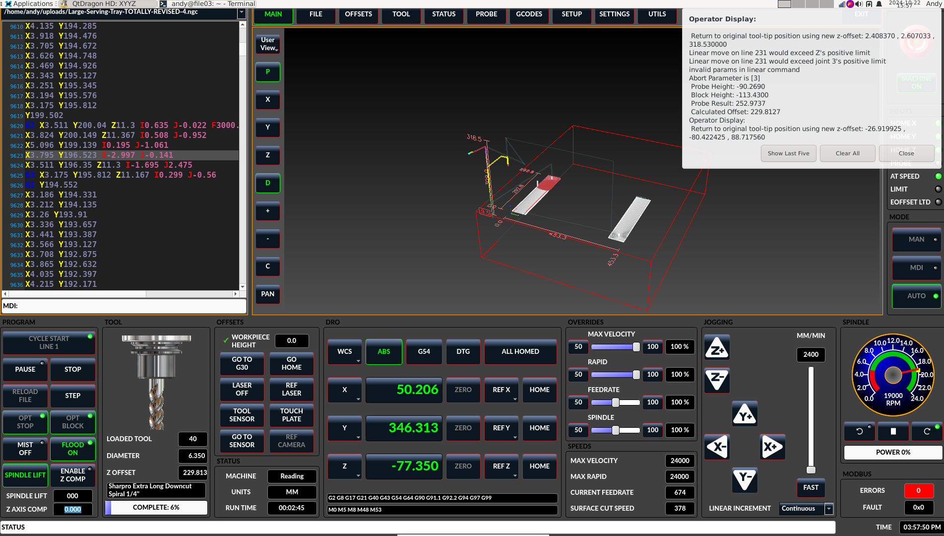

Adding some additional relevant logging info:
[QTvcp.QTVCP.WIDGETS.DIALOG_WIDGET][ERROR] No callback or STATUS message specified for: toolDialog_ (dialog_widget.py:317)
[QTvcp.QTVCP.WIDGETS.DIALOG_WIDGET][DEBUG] Button pressed is: &OK (dialog_widget.py:561)
USRMOT: ERROR: invalid command
Linear move on line 231 would exceed Z's positive limit
[QTvcp.QTVCP.WIDGETS.GCODE_EDITOR][VERBOSE] editor: highlight line 226 (logger.py:38)
[QTvcp.QTVCP.WIDGETS.GCODE_EDITOR][DEBUG] should reload the display (gcode_editor.py:713)
[QTvcp.QTVCP.WIDGETS.GCODE_EDITOR][VERBOSE] Line changed: 0 (logger.py:38)
Linear move on line 231 would exceed joint 3's positive limit
invalid params in linear command

Thanks Chris for your response.
The 3d probe is almost always going to be shorter than the tool length.
Here's what I have added:
226 (DEBUG, Return to original tool-tip position using new z-offset: #<local_start_x> , #<local_start_y> , #<local_start_z>)
In the attached/inline image you can see the values of local_start_z of 318.53 which fails. At the end the local_start_z it is set to 88.717560 and the program then moves forward.
I believe that the msg "invalid params in linear command" I believe is actually coming from this line:
203 G10 L1 P#<tool> Z[#<calculated_offset>]
and there after a G43.
There is mention of another forum post by @sou528 here that mentions the same however there's no follow up to that post .
He does refer to the documentation that indicates an example zworkoffset . If you scan the github repository for the word zworkoffset you will see mention to this.
I'd really like to get this one behind me if at all possible.
