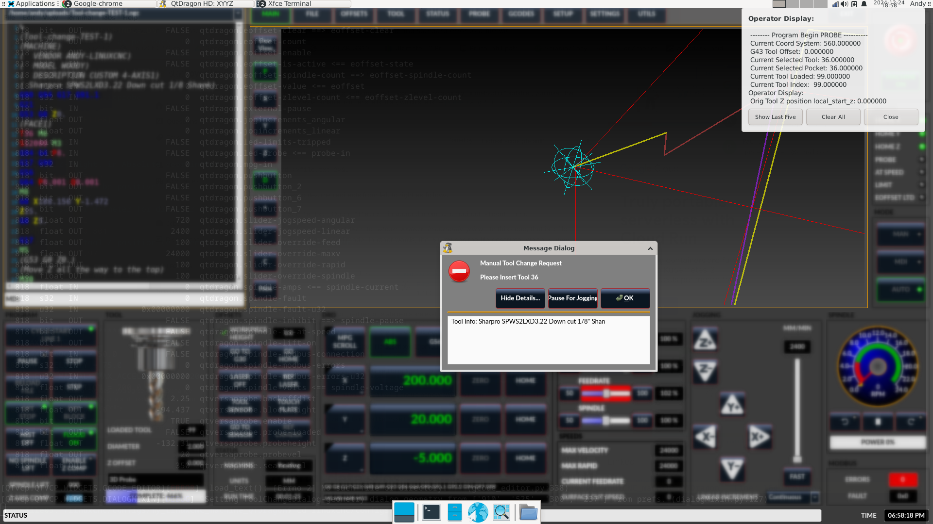

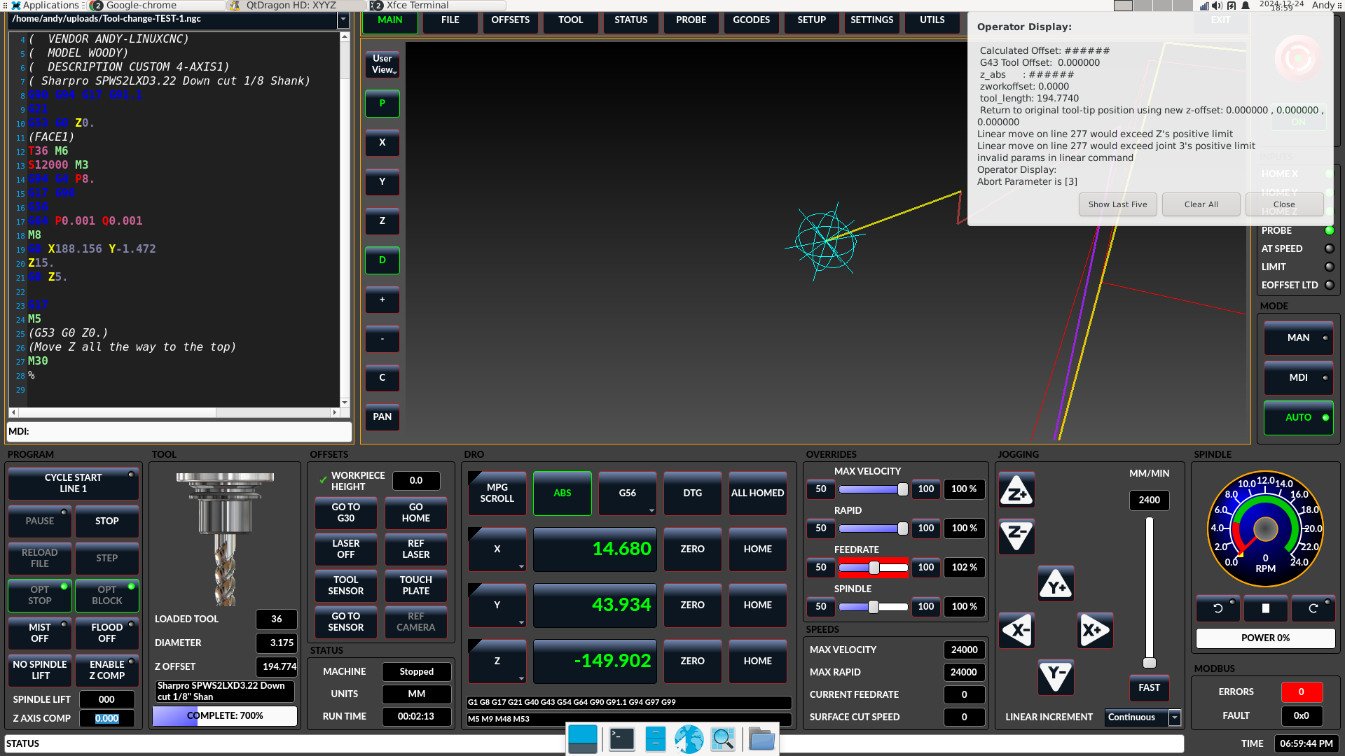

Ok, here's the latest update.
Text from the log file:
[QTvcp.QTVCP.WIDGETS.GCODE_EDITOR][ERROR] load_text(): [Errno 2] No such file or directory: '' (gcode_editor.py:338)
[QTvcp.QTVCP.WIDGETS.DIALOGMIXIN][DEBUG] Setting ToolChangeDialog-geometry dialog geometry from from prefs. (dialogMixin.py:127)
[QTvcp.QTVCP.WIDGETS.DIALOG_WIDGET][ERROR] No callback or STATUS message specified for: toolDialog_ (dialog_widget.py:317)
qt.qpa.xcb: QXcbConnection: XCB error: 3 (BadWindow), sequence: 12756, resource id: 9629954, major code: 40 (TranslateCoords), minor code: 0
USRMOT: ERROR: invalid command
Linear move on line 277 would exceed Z's positive limit
Linear move on line 277 would exceed joint 3's positive limit
invalid params in linear command
The images I am attaching honestly make little to no sense, rather the values in the images.

Based on this single probe attempt, what is causing the VAR _z to be -364.743 that I have highlighted in RED below?
All I did was turn on the machine and home it.
--- QtVCP Screen Started on: Sat, Dec 28 2024 11:48:10 AM ---
--- QtDragon_hd Version 1.5 on Linuxcnc 2.10.0~pre0 ---
11:48:11 Machine OFF
11:48:11 Hard limits tripped
11:48:11 Tool 0: No Tool
11:48:32 Machine ON
11:48:57 Hard limits tripped
11:49:04 Hard limits tripped
11:49:09 Hard limits tripped
11:51:28 Loaded tool 99
11:51:28 Tool 99: 3D Probe
11:51:37 Cannot switch pages while in AUTO mode
11:51:43 Versa Probe: Start Cycle: Go to Tool Setter
11:52:52 Versa Probe: Start Cycle: Probe Tool Setter Z Height
11:53:21 HISTORY Tool Setter height Z[-132.446]
11:57:20 Versa Probe: Start Cycle: Probe Z Height of material
11:57:30 HISTORY Probe Material Top Z[-94.743]
11:58:07 Loaded program file : /home/andy/uploads/Tool-change-TEST-2.ngc
11:58:07 Loaded file /home/andy/uploads/Tool-change-TEST-2.ngc
11:59:59 Saved: /home/andy/uploads/Tool-change-TEST-2.ngc
11:59:59 Loaded file /home/andy/uploads/Tool-change-TEST-2.ngc
12:00:34 Started program from line 1
12:00:38
Program Begin PROBE
12:00:38 Current Coord System: 540.000000
12:00:39 G43 Tool Offset: 0.000000
12:00:39 Current Selected Tool: 36.000000
12:00:39 Current Selected Pocket: 36.000000
12:00:39 Current Tool Loaded: 99.000000
12:00:39 Current Tool Index: 99.000000
12:00:39 Orig Tool Z position local_start_z: 364.743000
12:01:59 Tool 36: Sharpro SPWS2LXD3.22 Down cut 1/8" Shan
12:02:33 Run timer stopped at 00:01:59
12:02:33 Tool 36: Sharpro SPWS2LXD3.22 Down cut 1/8" Shan
12:02:33
FINAL PROBE BACKOFF
12:02:34 Z value detected 5063: 217.447440
12:02:34 Setting tool 36.000000 Z to 255.144440
12:02:34
FINAL PROBE
12:02:34 Current Tool Z Offset 5403: 255.144440
12:02:34 Probe Height: -132.4400
12:02:34 Block Height: -94.7430
12:02:34 Probe Result: 217.4474
12:02:34 5063 : 217.4474
12:02:34 Tool : 36.000000
12:02:34 5400 : 36.000000
12:02:35 Return to original tool-tip position using new z-offset: 45.666690 , 95.252380 , 364.743000
12:02:35 Linear move on line 271 would exceed Z's positive limit
12:02:35 Linear move on line 271 would exceed joint 3's positive limit
12:02:35 invalid params in linear command
12:02:35 Abort Parameter is [3]

12:00:38
Program Begin PROBE
12:02:33
FINAL PROBE BACKOFF
12:02:34
FINAL PROBE

- gardenweazel
- Posts: 197
- Thank you received: 10
28 Dec 2024 20:56 #317569
by gardenweazel
Replied by gardenweazel on topic Inconsistent values from Versaprobe
So I just did a Linux watch on the linuxcnc.var file for each change.
Immediately after I loaded the NGC file the #5223 changed to the -364.743 value. I had previously set
the value to zero before I started linuxcnc.
This is the NGC file that I loaded is as follows:
G90 G94 G17 G91.1
G21
(G53 G0 Z0.)
(FACE1)
T36 M6
S12000 M3
G94 G4 P8.
G17 G90
G54
G64 P0.001 Q0.001
M8
G0 X188.156 Y-1.472
Z15.
G0 Z5.
G17
M5
G53 G0 Z0.
(Move Z all the way to the top)
M30
G90 G94 G17 G91.1
G21
(G53 G0 Z0.)
(FACE1)
T36 M6
S12000 M3
G94 G4 P8.
G17 G90
G54
G64 P0.001 Q0.001
M8
G0 X188.156 Y-1.472
Z15.
G0 Z5.
G17
M5
G53 G0 Z0.
M30
