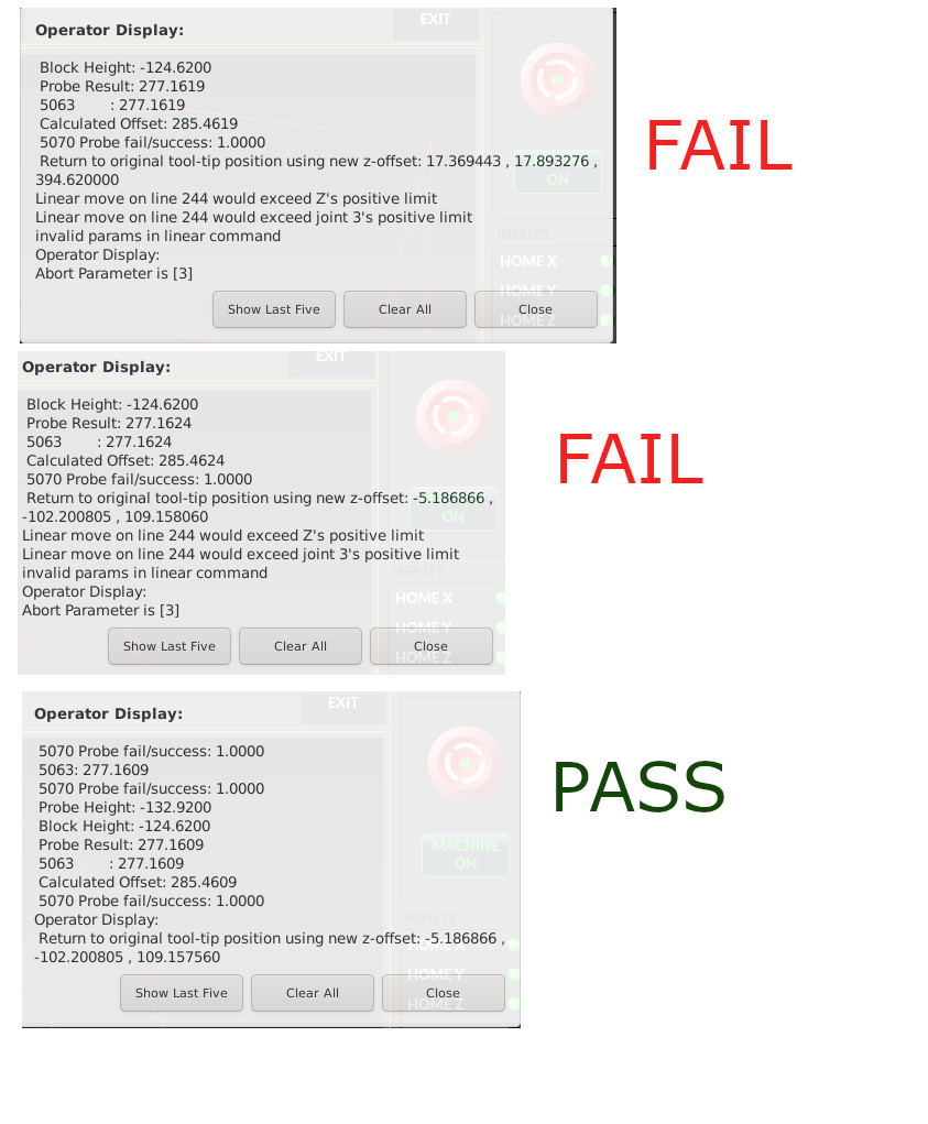

Posting some additional debug details in anticipation of getting some resolution.
This is from a single job that I ran yesterday. Exact same job run 3 times, as you can see there were 2 failures
and finally on the third try I was successful.
The second FAIL and the PASS are nearly identical.
Please chime in if you have any clues. I am using the subroutine from qt_auto_probe_tool.ngc
Last edit: 19 Nov 2024 21:19 by gardenweazel. Reason: added inline attachment

20 Nov 2024 18:44 - 20 Nov 2024 19:18 #314933 by Aciera
Replied by Aciera on topic Inconsistent values from Versaprobe
Strange enough is the value of #5070 probe fail/succeed passes each time with a one(1) succeed.
#5070 returns '1' if the probe succeeds which seems to be case. Looking at the 3 screenshots indicates that the actual probing works fine as the resulting 'calculated offset' values are very close.
Seems to me that the problem is somewhere after the actual probing has taken place.
[edit]
I wonder from where in the code this comes from:
'Return to original tool-tip position using new z-offset: ...'
Last edit: 20 Nov 2024 19:18 by Aciera.

21 Nov 2024 16:31 #314983 by gardenweazel
Replied by gardenweazel on topic Inconsistent values from Versaprobe
Agreed on the "probe succeeding".
I added this in order to see what is taking place:
I've noted from the script that:
#<touch_result> = #5063
which equates to 277.16xx in this case. Fairly consistent thru the 3 attempts.
I'm attaching the script as I have it now including the extra debug messages.
It's worth noting that immediately after the second touch-off the program aborts. There is no movement for any axis.

21 Nov 2024 18:28 #314989 by gardenweazel
Understood, Here's the lines where I suspect may be problematic, these are all after the touch-off:
#<calculated_offset> = [#<touch_result> - #<_hal[qtversaprobe.probeheight]> + #<_hal[qtversaprobe.blockheight]>]
G10 L1 P#<tool> Z[#<calculated_offset>]
G43
(DEBUG, Return to original tool-tip position using new z-offset: #<local_start_x> , #<local_start_y> , #<local_start_z>)
G53 G0 Z[#<_ini[VERSA_TOOLSETTER]Z_MAX_CLEAR>]
G0 X[#<local_start_x>] Y[#<local_start_y>]
G0 Z[#<local_start_z>]       <
LINE 244
The last line above is line 244.
The G53 call I have as -5 in my ini file. Which is an absolute call as I understand. The local variables are just that and
do not change when the sub runs.
The calculated_offset is consistent throughout the sub so that can be ruled out, I believe?
That leaves these two lines:
G43

21 Nov 2024 21:08 #315003 by gardenweazel
I noticed that the following code appears well into the SUB:
o300 if [#<_hal[qtversaprobe.enable]> EQ 0]
   (MSG, Auto Tool probe disabled )
    G43 ;turn back on tool offset mode before returning
o300 return [3] ; indicate no tool measurement
o300 endif
Actually, after the first M6 in the code. If I'm reading this correctly, the IF statement gets evaluated when TRUE.
If this is the case then why would it not be at the very top of the SUB? The reason I ask is because the line above this block is a
call to G49 which cancels tool length compensation. Meaning why bother to even begin the sub if it's not enabled?
That said, this return code of 3 shows up as the abort parameter in both of the failures.
Any feedback or thoughts what-so-ever are encouraged.
22 Nov 2024 03:56 #315017 by Aciera
Might be interesting to output the tool length offset of the current tool and check if it is the same as #<calculated_offset>. (Note the queue buster 'M66 E L0' that makes sure the DEBUG line is not executed prematurely by the read ahead)
G43
M66 E0 L0
(DEBUG, Current Tool Z Offset: #5403)
The following user(s) said Thank You: gardenweazel
